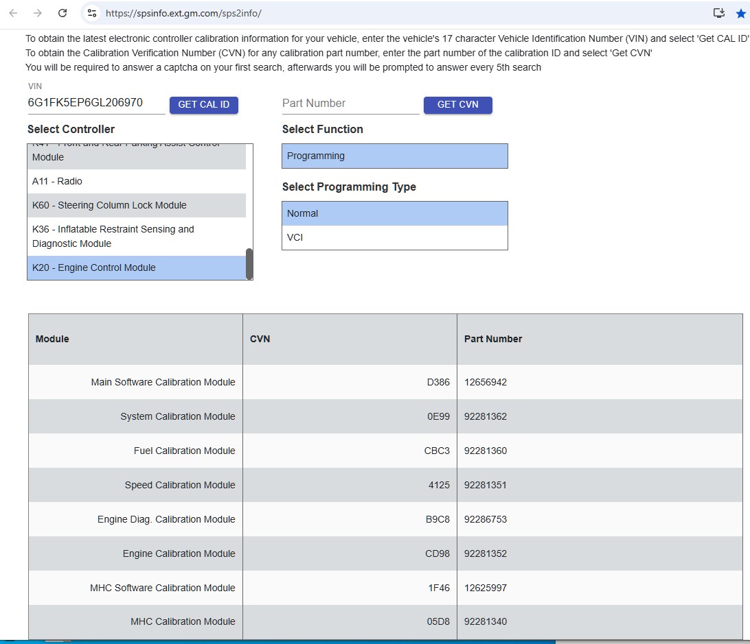

go here https://www.acdelcotds.com/subscriptions
create a free account. Then you can click on Resources at the top and select sps calibration information..
have to log in each time and password expires frequently.

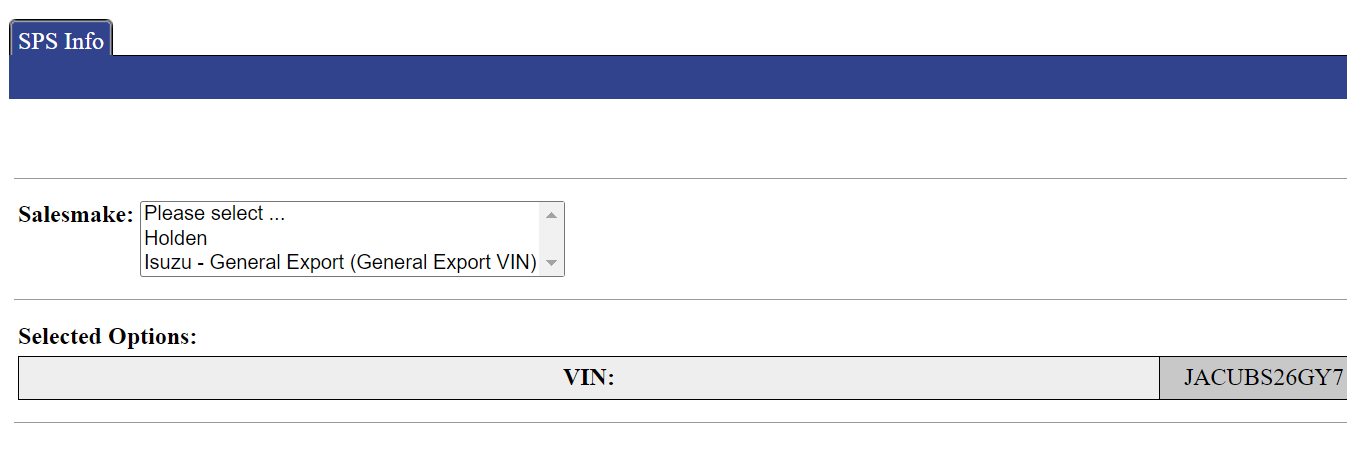

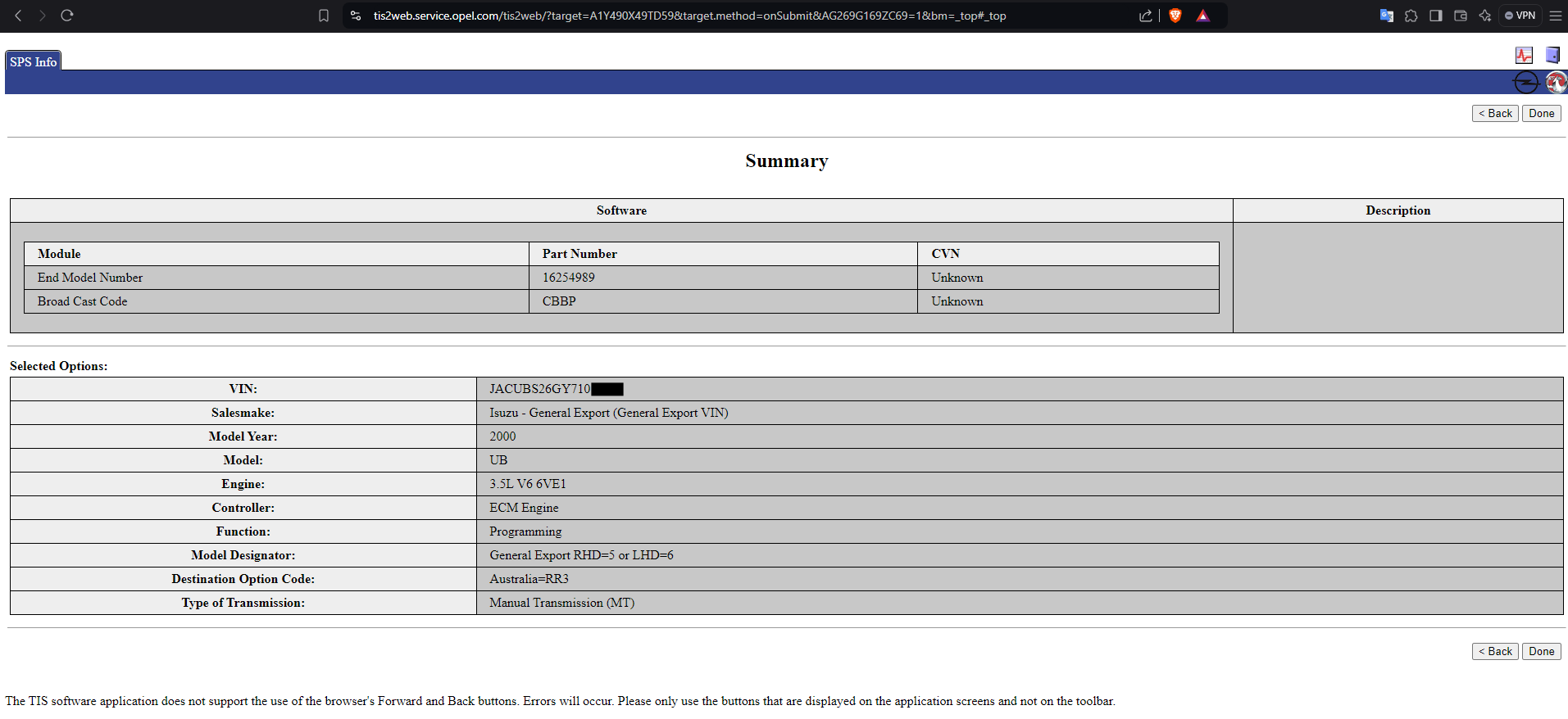

I just tested my 2000 Jackaroo on the Opel site and it gave an option for Isuzu export and another for Holden database. It came up in Isuzu export (it's Japan built, Australia delivered) and it did tell me my current ECM cal is 1624989 and for the record its on this PCM viewtopic.php?p=128893#p128893

Nah, this sure has no connection to opel.
Whats more with the Jacaroo vin it lists the 'salesmakes' which I think are the databases it has. It has one named Holden, and one named Isuzu - General Export. Which makes me think, it likely has all of them. It would be interesting to put a saab vin in to it and see what comes up for something else completely different.
Edit: nope saab not coming up... so its not all of them.

Be careful with that Opel CalID. It's frozen in time from before GM or maybe PSA sold them off. It's still really useful, but it's missing any changes from the last couple years.
kur4o
- Posts: 1145
Re: TIS for calibration identification
There is still a free vin cal decoder, but you need account on delcotds site.
