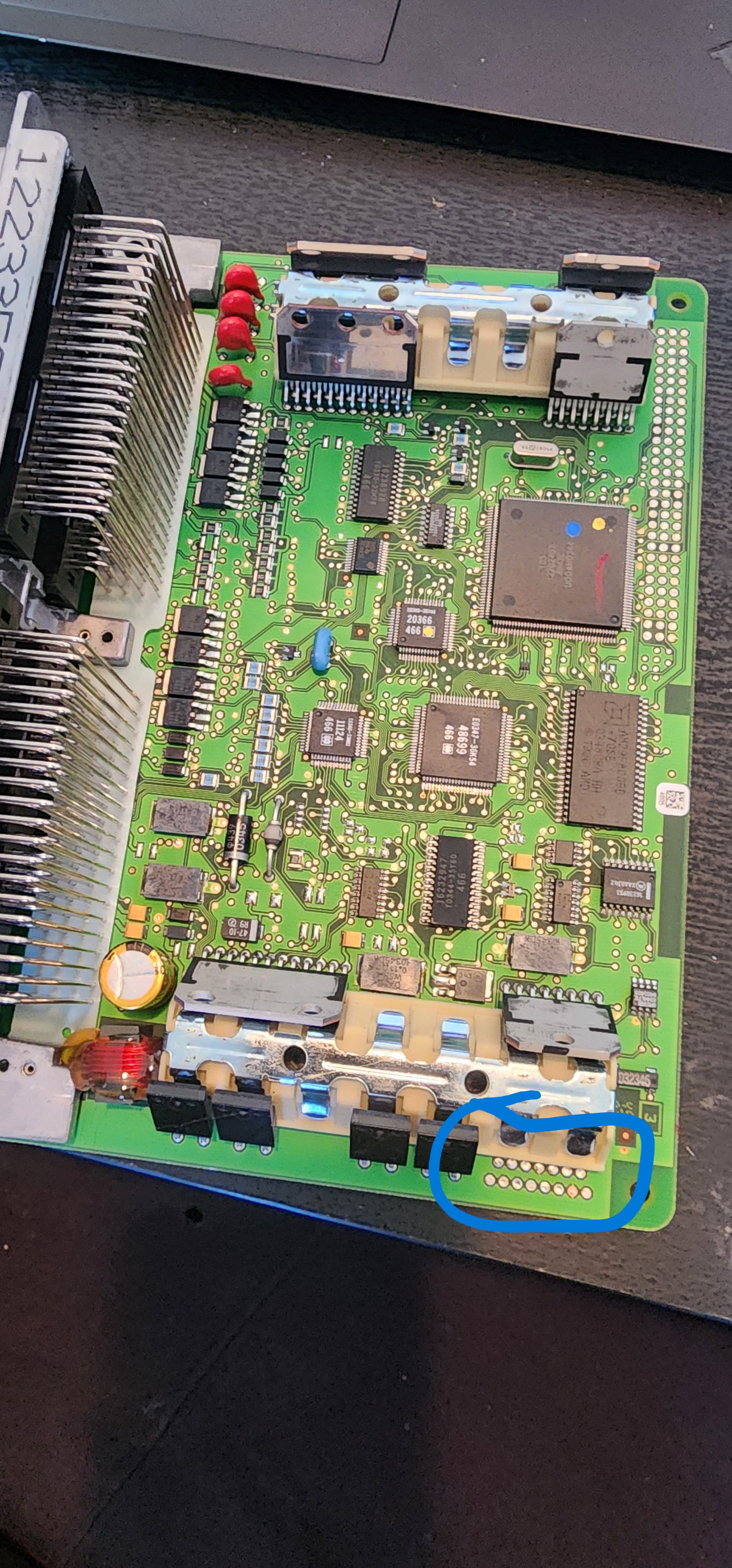

Has anyone attempted this and of so is it possible? I suspect the hardware should be the same minus the IAC driver IC, as they make P59 PCMs that support DBC and DBW, it seems to me that soldering in the IAC chip and reflashing with the software from a DBC vehicle should work in theory? I have both a spare P01 and a P59 laying around, i will open them up and compare the boards to see if there are any other noticeable differences.

should work in theory. put them side by side, compare if any connected smd components are missing in the signal path. Let us know how you go. We have similar for older generations. It may be just the main IC and maybe a small number of smd you could measure and document for others. For comparison it was about 4 SMDs for aussie VS commodore VSS differences between versions.

Sourced a few of the IAC ICs from eBay, exact part numbers/markings, hopefully they are legit, i have not been able to find any other information on them so only way to test is to install them in a PCM, doesn't appear to be any other noticeable differences looking at the boards. Looks like the software is the same too, comparing the calibration files of a 2004 silverado and a 2004 chevy express, same OS, some minor differences to the engine calibration however all Electronic Throttle settings are the same in both despite one being DBC and the other being DBW. Only other differences are the diagnostic code tables the silverado has codes enabled for the DBW components, and the silverado also has a '1' in the GMT800 ETC column in the system options table as expected to enable Electronic Throttle.

UPDATE: I was successful! Only one part needed to be installed, the '69200' IC sourced from ebay, link in previous post, clear the solder from the holes using a desoldering pump and solder wick/flux, bent the pins to line up with the staggered holes, make sure it sits properly against the plastic support in the middle of the ICs/transistors as this support is what presses these parts against the case for heat transfer/cooling of the parts. After the installation is complete clean the flux off the board. Only only software modifications i made were in the options table, the "ETC" option gets changed from a 1 to a 0. Wired up a throttle body on the bench and tested the IAC with a bi-directional scan tool, seems to be functioning without issue.
This is a DBW only P59 LS PCM, Service number: 12586242, pulled from a 2004 Chevy Suburban

I have not been able to find a datasheet for this part either, I am curious if anyone has information on this though. I got the number from pictures of a PCM circuit board that supported DBC from the factory and was able to find a source for the parts on eBay. It has to be some sort of self contained servo driver IC

I've seen 3 phase motor ICs that are little more than just level shifters + some logic to prevent the ground and 12 volt transistor from activating for the same output, even if software says to, because obviously that would blow out a fuse or the IC itself. Probably more or less that.
