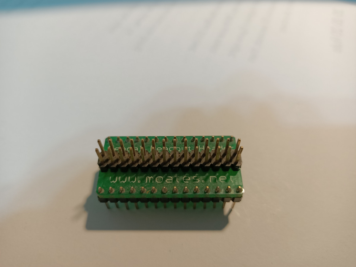

It always depends what your doing, but in general no adapter required. The NVRAM chip will plug straight in. Memcals are a topic of their own. You generally would replace the old UV erase chip with a socket, then you can use an eeprom chip and remove it from the socket to reprogram it, or to save that hastle you can make an adapter with some vero board and 2.54mm pins so that you can plug the memcal on to your adapter and the adapter straight in to the programmer. I have one of these on hand so I can read memcals if I need to just by plugging them in but its up to you if you want to make up an adapter like that for your purposes.

This is the adapter I use. No longer available from Moates but you should be able to reproduce.
