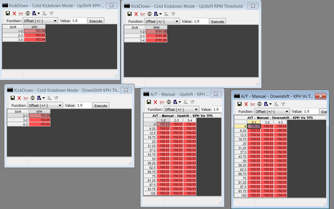

I know im gonna get flammed for not taking a log of issue with my car but seems as i have been feeding a bit more power into my vr 4l60e it hits the limiter on the 2-3 change 2 to 3 times before changing when over say 80 per tps. All my other shift tables etc look good by what i can see but these tables below are these values normal what do they do etc?

Something is wrong if they are the values displayed you using the correct xdf. Cold gearbox kickdown down and upshift tables ie when you stamp on the gas and it kicks down it uses those tables for the downshift and the upshift into the next gear

Manual downshift is doing the same but with the lever

VR, 4l60e, hits limiter on the 2-3 shift.vp304 wrote: Wed Jan 08, 2025 12:29 pm I know im gonna get flammed for not taking a log of issue with my car but seems as i have been feeding a bit more power into my vr 4l60e it hits the limiter on the 2-3 change 2 to 3 times before changing when over say 80 per tps. All my other shift tables etc look good by what i can see but these tables below are these values normal what do they do etc?
Mate, I could have written this myself. Actually, I think I did do a thread on it last year.
I think, basically the ECU is commanding the correct shift point, but due to the nature of high torque and high rpm shift point, the transmission struggles mechanically to make that shift.
I have a part on order (it's in the country and at my mates) that I am going to try which should help shifts at over 5600rpm.
To overcome the issue, I set the WOT 2-3 shift at a much lower road speed (maybe 15kph I think) to give it extra time to make the shift and still stay under low 6000rpm range.
I'll advise the part number when I get it.
In saying that, your shift tables displayed don't look right.
Try setting them the same as your base shift points and see.

Yeah values all shouldn't show the same numbers. Thats a huge red flag on that sanity check when working. It looks like you dont have your bin loaded in tunerpro, or some other incompatible bin, just the xdf maybe. something like that.

Antus was some values in this bin when i got it that where all jibberish maybe this manual part of the tables i forgot to fix up / missed it.
Delcowizid I have what looks like decent auto shift maps car drives good in drive should i copy these and the hot to cold values over and see how i go you rekon ?

Interesting. Seems to be the same in the vy flash tunes. Cold shift patterns are like that as well. And coolant temp activation for cold shift patterns are -40 deg c. I loaded up 11p and those manual shift tables definitely don’t look right though.
