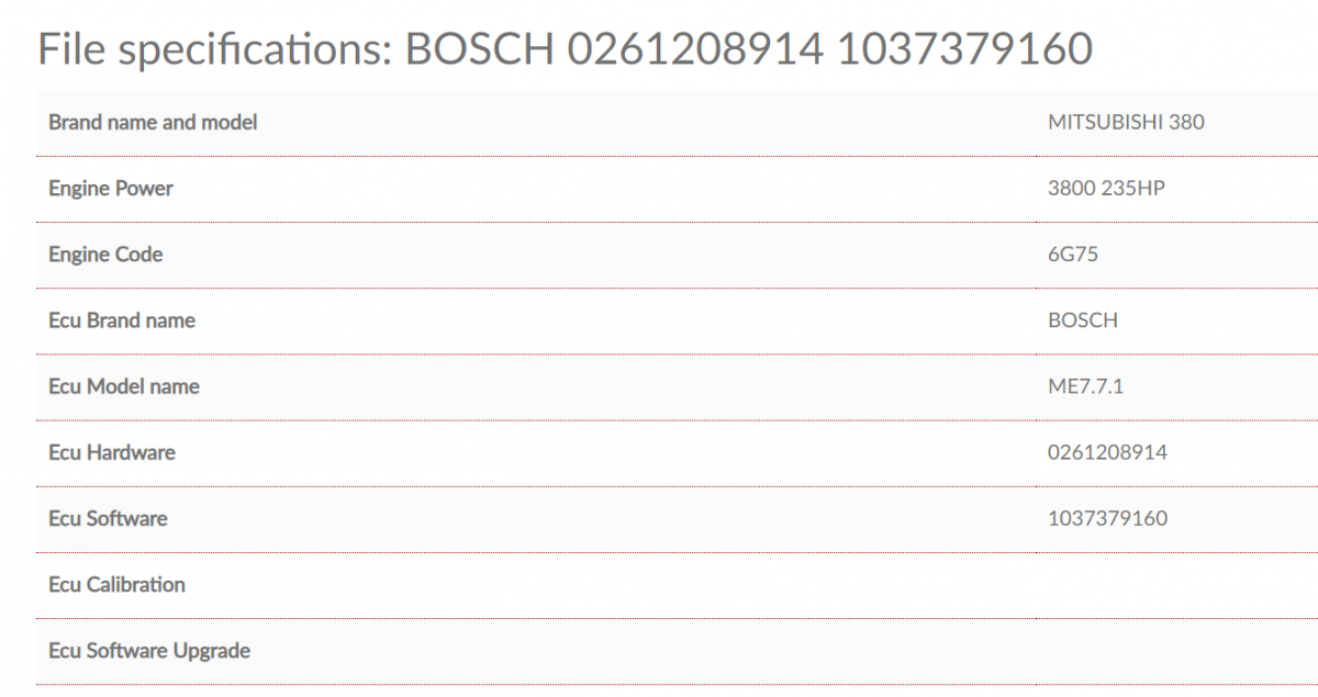

I came across this, site that might help.
https://auto-remap.com/original-files
you can Search by Hardware (HW) number. This is the Bosch number on the ECU that starts with 026. Should give you the model.
Here's example
