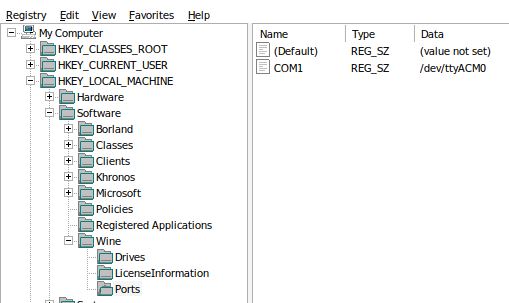

Using System.IO.Ports.SerialPort.GetPortNames() you get all ports COM1 .... COM33 (?), available or not.
Setup com port(s) using: wine regedit
HKEY_LOCAL_MACHINE\Software\Wine\Ports
Add new string value, for example COM1 and set Data to real port.
Attached modified version of PortDiscovery.cs, it can detect if running under wine and displays only defined com ports.
It works... almost. Test write is ok, but reading not. Debug log as attachment
