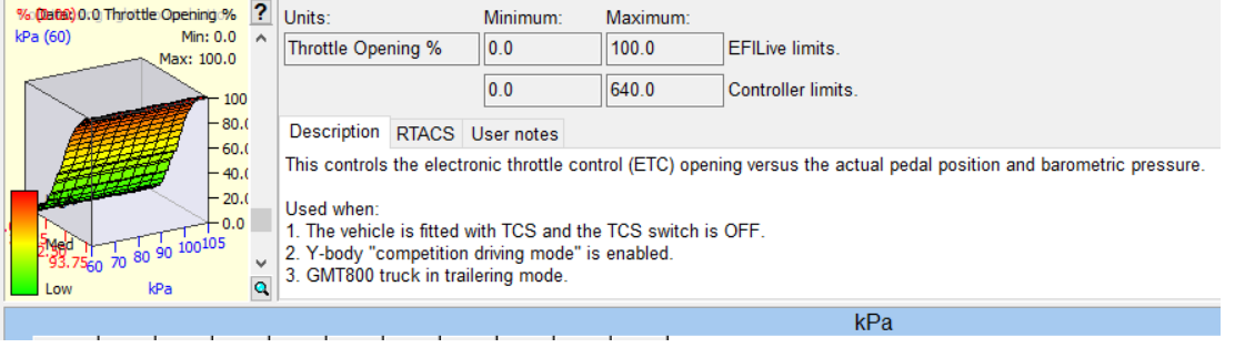

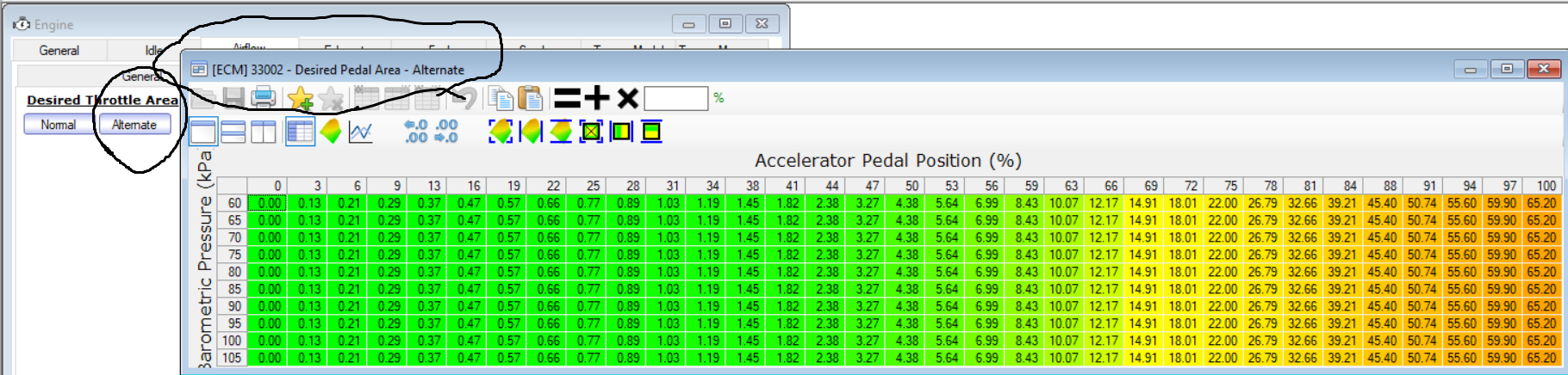

Does anyone know of a way to trigger the PCM to use the Alternate desired pedal area table? I`m guessing it has to do with traction control? I had hoped that it had to do with the normal vs performance mode transmission shifting strategy, but that does not seem to be the case. I`m running the 07 van OS 12613248 but I am willing to make some adjustments or switch to the 603 OS if someone knows how to do it there. Basically I am looking to be able to flip a switch to slow down the throttle opening rate and limit the max opening of the throttle. Based on the screen shot of the 2618 2005 OS that should work if I can figure out how to select the table.

Does the description field against the alternate table in efilive tell you? That is where I would expect it.

Thank you! I didn`t even think to check EFI Live 7 cause I really haven`t ever used it. Now I just have to figure out why it didn`t seem to activate that table when I went into tow haul mode (via grounding pin 71 as there`s no BCM in my boat). I had kinda figured that table would be activated by tow/haul but it didn`t seem to work when I tried it on the bench.

I`m not sure if I was using the GMT800 platform code of not, I had tried it on multiple bins. I know one of them was the GMT610 van platform code. I loaded a stock 2005 GMT800 bin into my test PCM, flashed it over to 1 switch for the performance mode as the 05 GMT800 tahoes only go to 65% desired pedal area on the alternate table. When I tried it a couple minutes ago it would open the TB 100% no matter how many times I tapped the blue pin 71 wire against the ground bus. I did notice that on my HPT scanner from the time that I powered up the PCM until I disconnected it always said "yes" in the trans performance mode column. I swear it normally switches back and forth between yes and no when I would tap pin 71 to ground on my bins that I had set up for tow/haul / performance mode. I`m going to have to try loading a 2003 GMT800 file in that I know worked with the pin 71 tow/haul mode button and see if it switches between yes and no on the performance mode column.

Is that the Tunerpro/EFI live B2307 and B2308 tables? I have access to both of those, I was attempting to modify the B2308 table. Or is there duplicates of both of those tables? I didn`t see duplicates of the B2307 and B2308 in tunerpro or EFI Live 7 for the 7603 OS. I used to think the B2307 and B2308 had to match eachother, but then I stumbled across the .bin for a 2005 chevy Tahoe and they are wildly different in that application. IE 100% max pedal is 65% throttle opening on the alternate table, which is what gave me the crazy idea that maybe I could use this to limit my max throttle opening with the flip of a switch...well ok momentary push button.
