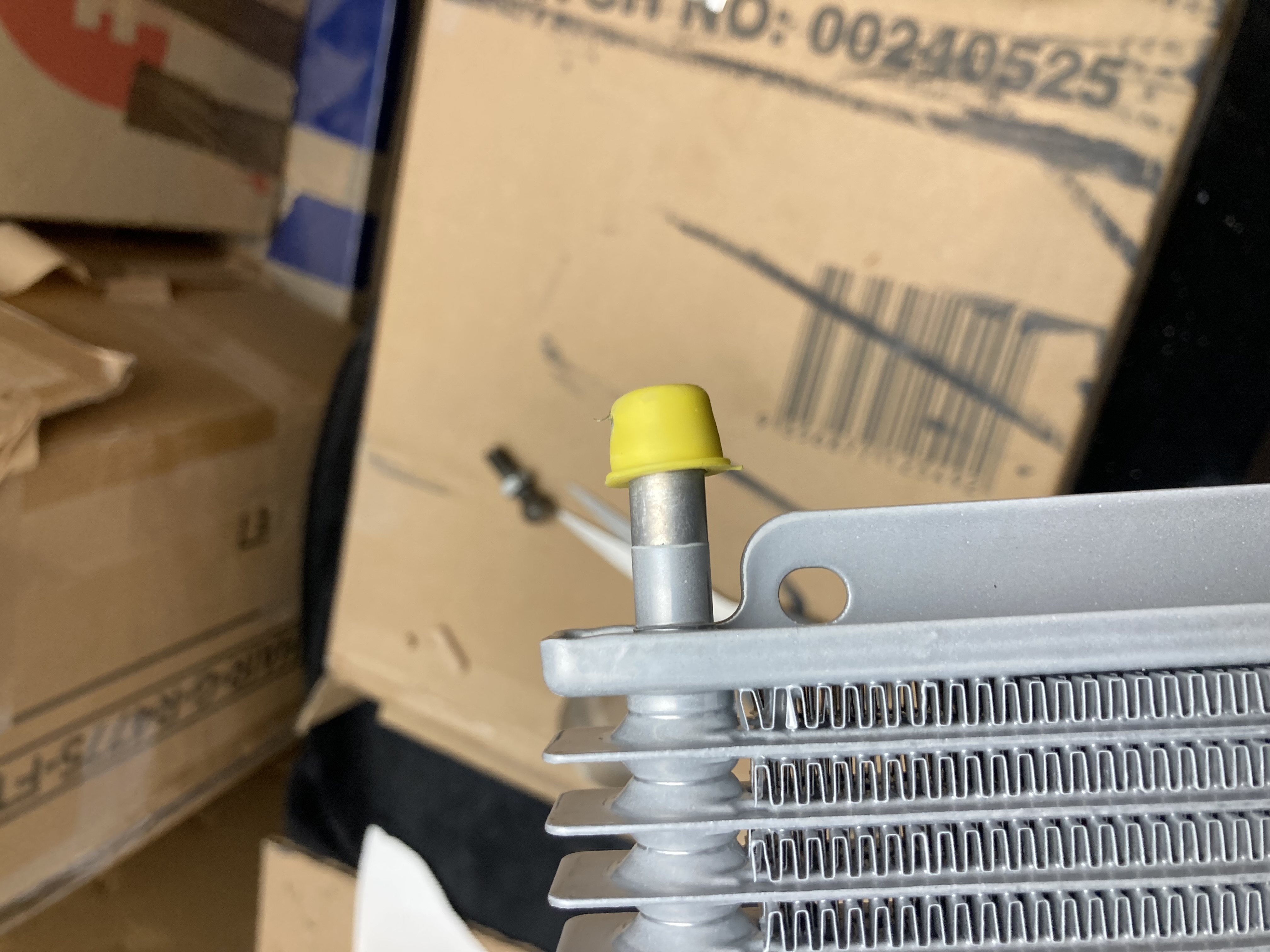

However they are powder coated silver, not a bad thing, but I feel unnecessary. Related to that, I felt that the coating on the barbs isn't the best ideal. At first I de-burred the tips, but latter thought that maybe over time the fluid might possibly attack the paint and it could come off and contaminate the hydraulic system in mind.
So I went back and masked the tube with tape (just for neatness but not really needed) and slowly rubbed the paint off with a soft micro cloth soaked in acetone, picked much of the softened paint off with my nail (this stuff is good quality and bonded like you wouldn't believe!) and eventually got the remaining residue off.
So I can be happy knowing that won't be a source of problems.

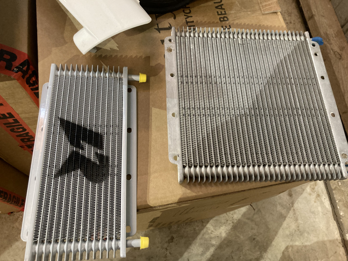

Overall quality is excellent and I think the finish is more neat than the PWR ones as they often look rough and mass produced, at least for this rage of universal coolers. The larger one in the pic is the PWR unit.
I blew the cooler with compressed air and no crap came out, so the quality control is very good. Pressurized it and saw no issues, a moot point for my application though. The pressure drop appeared next to nothing too, considering that it was a blow gun which is lots of volume compared to a PS pump or even an auto. I think part of the low pressure drop is the more simplistic fluid channels compared to the zig zagged narrow ones in the PWR units, but they probably cool a little better than these. But I doubt it would be much of a difference. This is still overkill for what I need it for.
I def recommend this for the budget minded that still want good quality. :thumbup:
