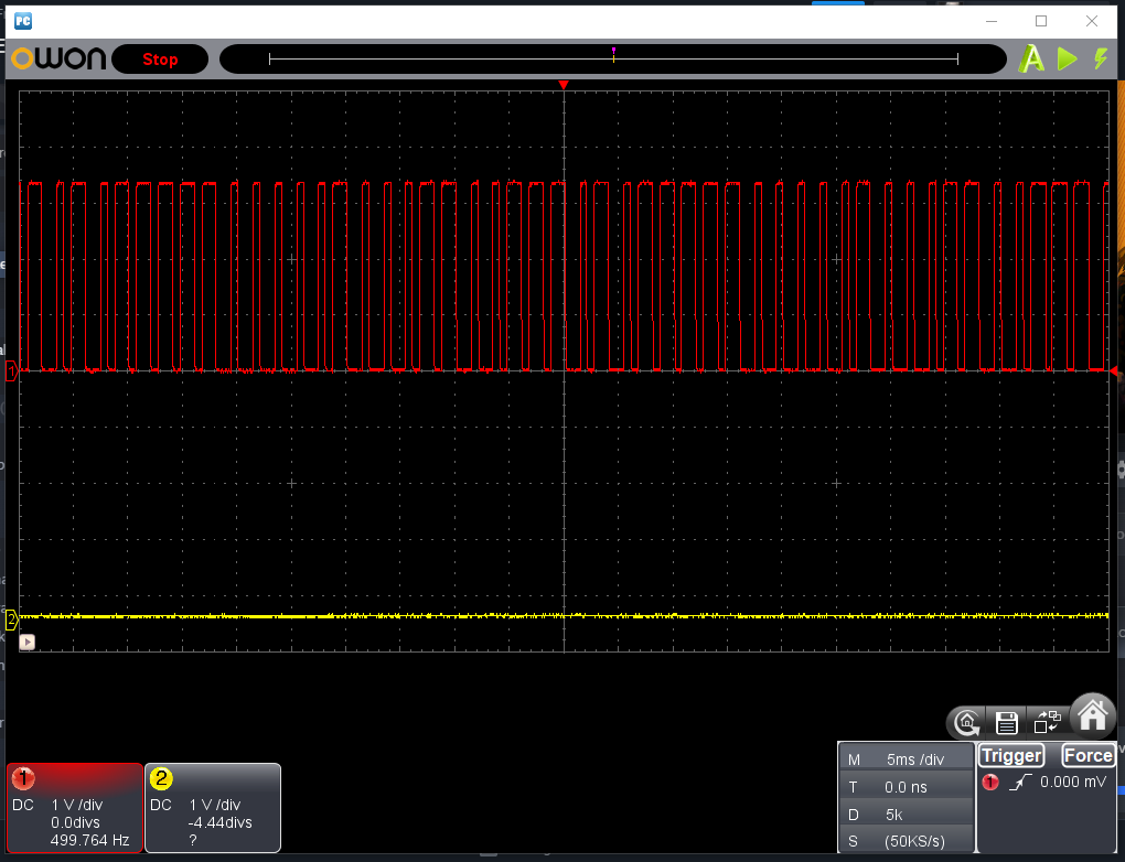

Updated with most recent progress https://www.youtube.com/watch?v=EXo97nUB3hk Attached file is Arduino IDE code. By default it should output 1056 RPM crank and cam signals.
Original post~
Arduino code on a PiPico. LS 24x crank signal with 1x cam.
No output on oscilloscope.

AngelMarc
Posts: 198
Re: Help needed, crank signal generator.
Post by AngelMarc »
A bunch of arbitrary syntax stuff.
I got it working less than a minute ago.
Just need to add back the speed variation input, then figure out some simple analog input hysteresis code.
And I might need to invert polarity.
int TPS = 0;
int sequence[48] = {0, 1, 1, 1, 1, 1, 0, 1, 1, 1, 0, 0, 1, 1, 0, 0, 0, 1, 0, 1, 0, 0, 0, 0, 0, 1, 1, 1, 1, 1, 0, 1, 1, 1, 0, 0, 1, 1, 0, 0, 0, 1, 0, 1, 0, 0, 0, 0};
int cam[48] = {0, 0, 0, 0, 0, 0, 0, 0, 0, 0, 0, 0, 0, 0, 0, 0, 0, 0, 0, 0, 0, 0, 0, 0, 1, 1, 1, 1, 1, 1, 1, 1, 1, 1, 1, 1, 1, 1, 1, 1, 1, 1, 1, 1, 1, 1, 1, 1};
int tooth = 0;
int low = 0;
int high = 0;
int RPMlow = 0;
int RPMhigh = 0;
int math = 1;
int halfdone = 1;
int done = 1;
int width = 1;
unsigned long previousmicros = 0;
void setup() {
//pinMode(A0, INPUT);
pinMode(1, OUTPUT);
void loop() {
if (halfdone == 0) {
  if (micros() - previousmicros >= RPMlow) {
      halfdone = 1;
      done = 0;
      digitalWrite(1, HIGH);
      previousmicros = micros();
if (done == 0) {
  if (micros() - previousmicros >= RPMhigh) {
      done = 1;
      math = 1;
      digitalWrite(1, LOW);
if (math == 1) {
tooth++;
if (tooth == 48) {
  tooth = 0;
TPS = 666;
width = sequence[tooth];
cam[tooth];
if (width == 0) {
  low = 1;
  high = 2;
if (width == 1) {
    low = 2;
    high = 1;
halfdone = 0;
math = 0;
RPMlow = low * TPS;
RPMhigh = high * TPS;

antus wrote: Sat Apr 26, 2025 4:21 pm
#include <Arduino.h>
#define PIN_SEQUENCE 14
#define PIN_CAM      15
#define PIN_INPUT    A0
int tps = 0;
int tooth;
void setup() {
  Serial.begin(115200);
  while (!Serial);
  Serial.println("Hello from the Pico!");
  pinMode(PIN_INPUT, INPUT);
  pinMode(PIN_SEQUENCE, OUTPUT);
  pinMode(PIN_CAM, OUTPUT);
void loop() {
  for (tooth=0; tooth<48; tooth++)  {
    digitalWrite(PIN_SEQUENCE, sequence[tooth]);
    digitalWrite(PIN_CAM, cam[tooth]);
    tps = analogRead(A0); // 0-1023
    delay(tps);
That looks very professional.

Oh, and the original reason I didn't use delays, was for monitoring analog input levels, so reasons for unexpected outputs could be traced.
Don't stress specific units.
AngelMarc
Posts: 198
Re: Help needed, crank signal generator. <solved>
Post by AngelMarc »
According to oscilloscope readings, it currently goes between 810 and 83,160 RPM.
lol I think I'll divide by 8 or something.
Posts: 8986
Good stuff. Can you add the cam and is a PCM reading it ok as a real trigger? I assume this is a part of a bench test suite signal generator?
