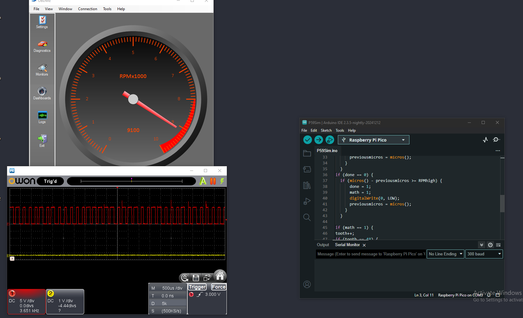

EDIT:
833333 divided by TPS number equals RPM. Roughly, there's decimals not accounted for.
int RPM = 9000;
int TPS = (2500000 / RPM) / 3;
Attached an updated version. Expect rounding errors in target vs measured. Those errors will get larger at higher RPM.
P59Simupdated.ino
Original post:
https://www.youtube.com/watch?v=EXo97nUB3hk
Tested at over 9,000 RPM
I used a Pi Pico and a TC4452V.
It's all generic Arduino code; so grab your favorite micro controller and give it a try.
The oscilloscope is a VDS1022 if you care to know. They sell for $95.

In the future I may look into some multi-threaded code so the signal isn't interrupted and could be sloped instead of jumping straight to the resulting speed, and the number sent could be the desired RPM. Need to look into sharing variables between threads with appropriate buffering and what not.

ECU looks very unhappy beyond 8,000. Spark instabillity big time.
It still tries at 20,000 RPM, but in the same way a toddler would try to beat a pro boxer.
Since scanner disconnects much beyond 9,000, I have to do math of 24 teeth times 3 per tooth (code base numbers) times 40 (number I sent over serial) = 0.00288 microseconds per crank revolution. Divide 60 by 0.00288 = 20,833.33333333333 RPM.
I have the scope reading crank signal and a coil control output.
Beyond 8,000 you see dwell periodically almost disappearing. At 20,000, makes me wonder if something wrapped in code and the startup cam phase hunting is active again; because it's dropping a lot.
Don't stress specific units.
