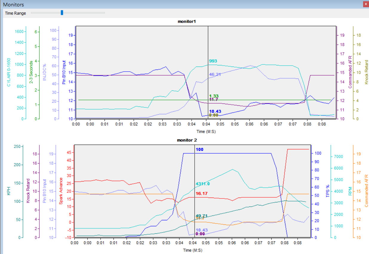

Hey Guys,
I have been tuning my vt l67 on the1s enhanced bin, I am slowly ramping up the boost, I have a 2.8 inch pulley on at the moment and dialing in the AFR to 11.8.
In 2nd gear the AFR is pretty flat at 11.8 but in 1st gear it tends to spike rich (10.5-10.8) and then slowly creeps back up to AFR of 11.8 when I hit second gear and stays pretty flat at 11.8 all through the rest of the gears. How can I flatten out that 1st gear acceleration rich spike? or does this naturally happen because of the load in 1st gear? Would appreciate any advice thanks!

Whats thw MGC for both gears?

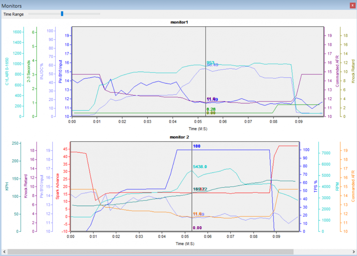

here is a log i did, you can see the comparison of 1st and 2nd gear.

Its acceleration fuel enrichment/tip in... however you want to describe it. You went from bugger all throttle to everything
