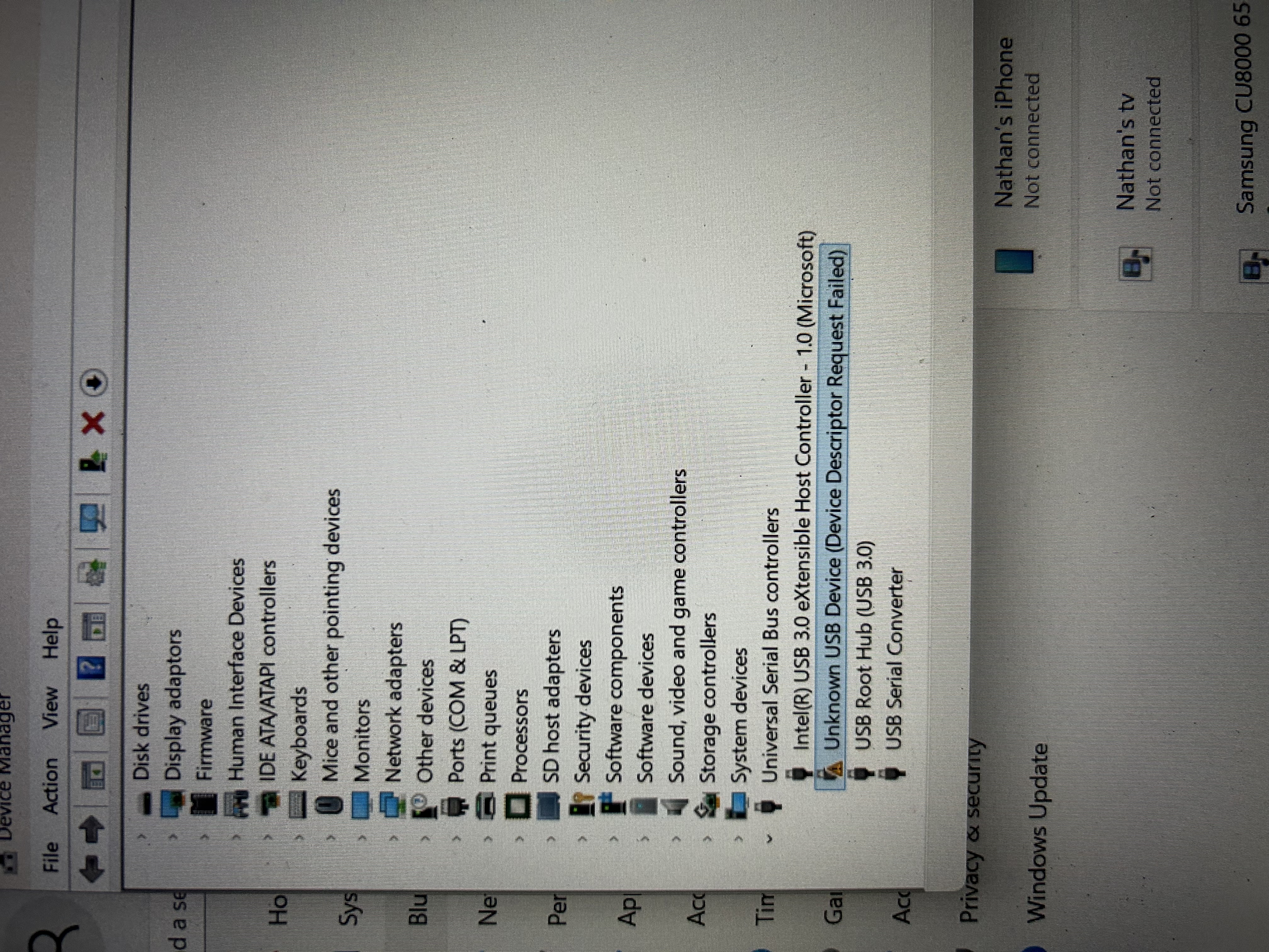

Hi all I have installed an NVRAM and comms board into my 808 ecu and I'm having dramas getting my PC running windows 11 and my sons running windows 10 to connect really annoying. It's lighting up so connecting ok issues seems to be on the PC anyone had this issue before and able to help out? cheers

Hey mate I’m the one that was inboxing you last night and this morning. Yeah trying to use tuner pro. I honestly have no idea what oseplugin is
as I said in the inbox it’s picking it up but with an error so I have no access to it.

That’s the error and it shows up in “other devices” but can’t do anything with it. From what I understand it’s in read only will that stop me from viewing what’s on it or is that just to say you can’t make changes?

That error "device descriptor request failed" is a USB error, before it even gets as far as the drivers. That isn't normal and I don't know why that would be happening on your PC. Device descriptor is where the PC asks it for ID numbers which it uses to ID the chip, and download the drivers. Thats a normal USB thing and should succeed as soon as you plug it in then it'd go to the net and get drivers automatically. So it would seem there is something else specific going on here but I have not seen that exact error before. Do both PCs say the same thing?

Try unplugging any other usb devices, try different usb ports. Those intel drivers and some other usb serial device looks different to what im used to. It might be to do with that or the port not working properly.

Yeah I tried that it has 3 usb ports tried all 3 there’s nothing else plugged in. I looked at the windows 10 pc and it said there were no drivers available so I might play with a bit more a mate suggest some drivers to download didn’t work on windows 11 pc but maybe might on the windows 10 pc.

ftdi ft232rl vcp drivers... should auto install from microsoft though.
