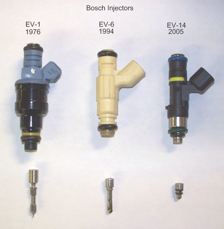

I found this picture on the net, i wonder whats available in the ev14 and what the differences are with those.
From this page http://www.injectordynamics.com/questionsanswered.html

bit of technology differences there hey :D

yeh bit old clunkers ev1, Im guessing ev6 and 14 would be quieter also

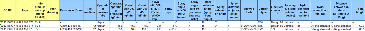

I found a excel table on the web listing injector differences but the 378 bosch recomended didn't have specs listed but atleast we can see the difference between the vs and vx injectors, seems to be "recomended" fuel type and spray angle. The 378 has 20deg so maybe that's why they recomend it over the 777 in the vx, i wonder why the ecotecs didn't use 378 then instead of 777?
