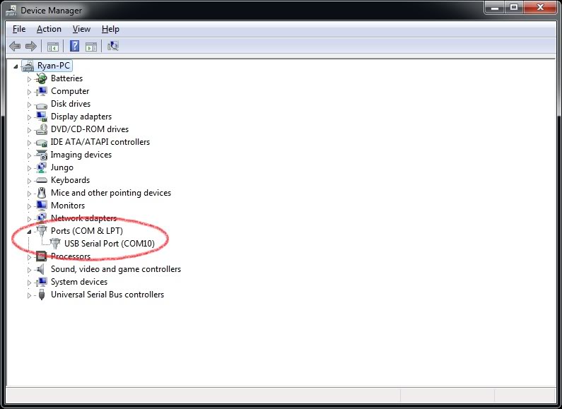

If the drivers are installed will see something like this once the board is plugged in...
If not, remove the drivers using the utility above. Then re-install them - extract them to a folder on your PC (download the windows 7 driver for 32 or 64bit depending on your system), then plug in the USB board. When it asks to install drivers point the wizzard to the location on your PC of the extracted drivers. Once finished will say the hardware is ready for use.
