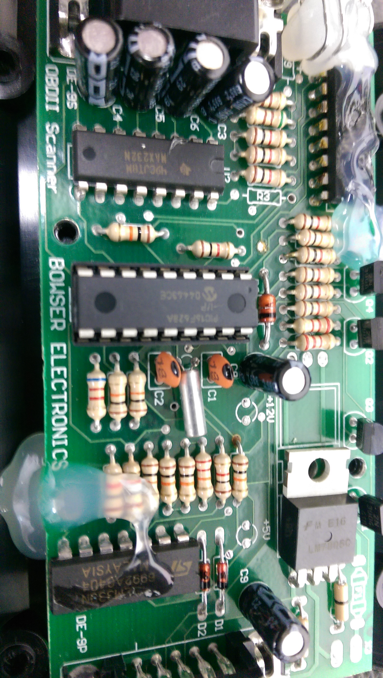

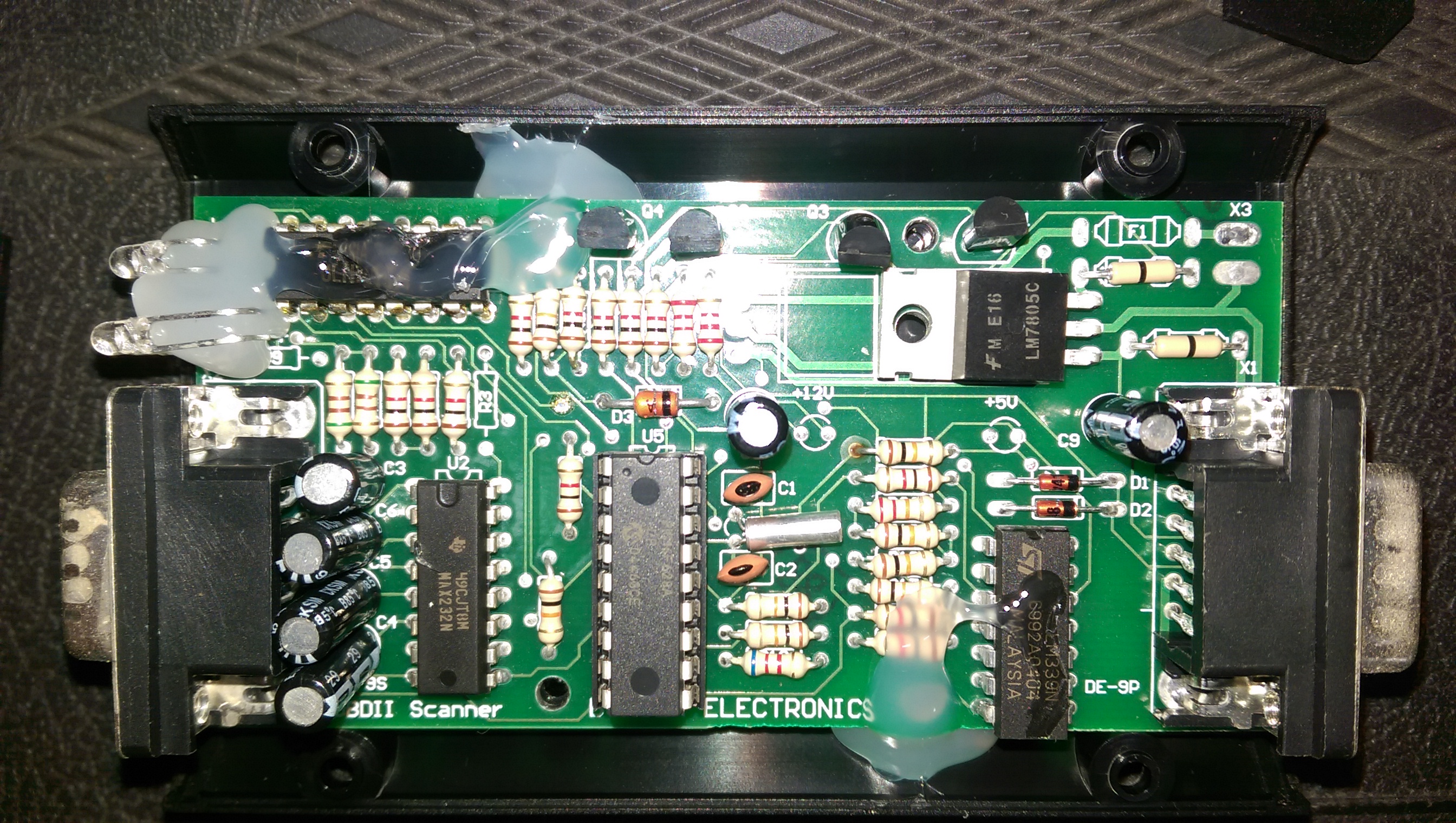

Can you open it up get a high res pic of the circuit?

I thought you may ask that!
Posts: 4814
Re: Bowser Electronics GM OBD2 Cable ?
a little pic micro? 16f628a with max232 and voltage comparator setup, not sure what the chip is under the hot snot prob a led driver?

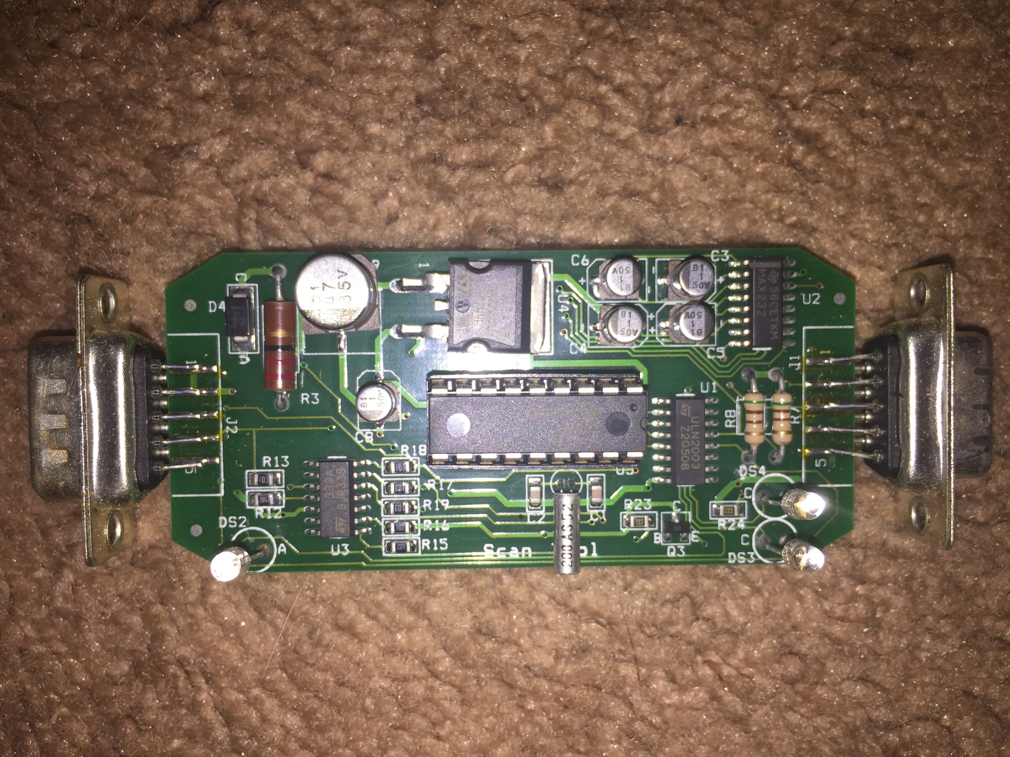

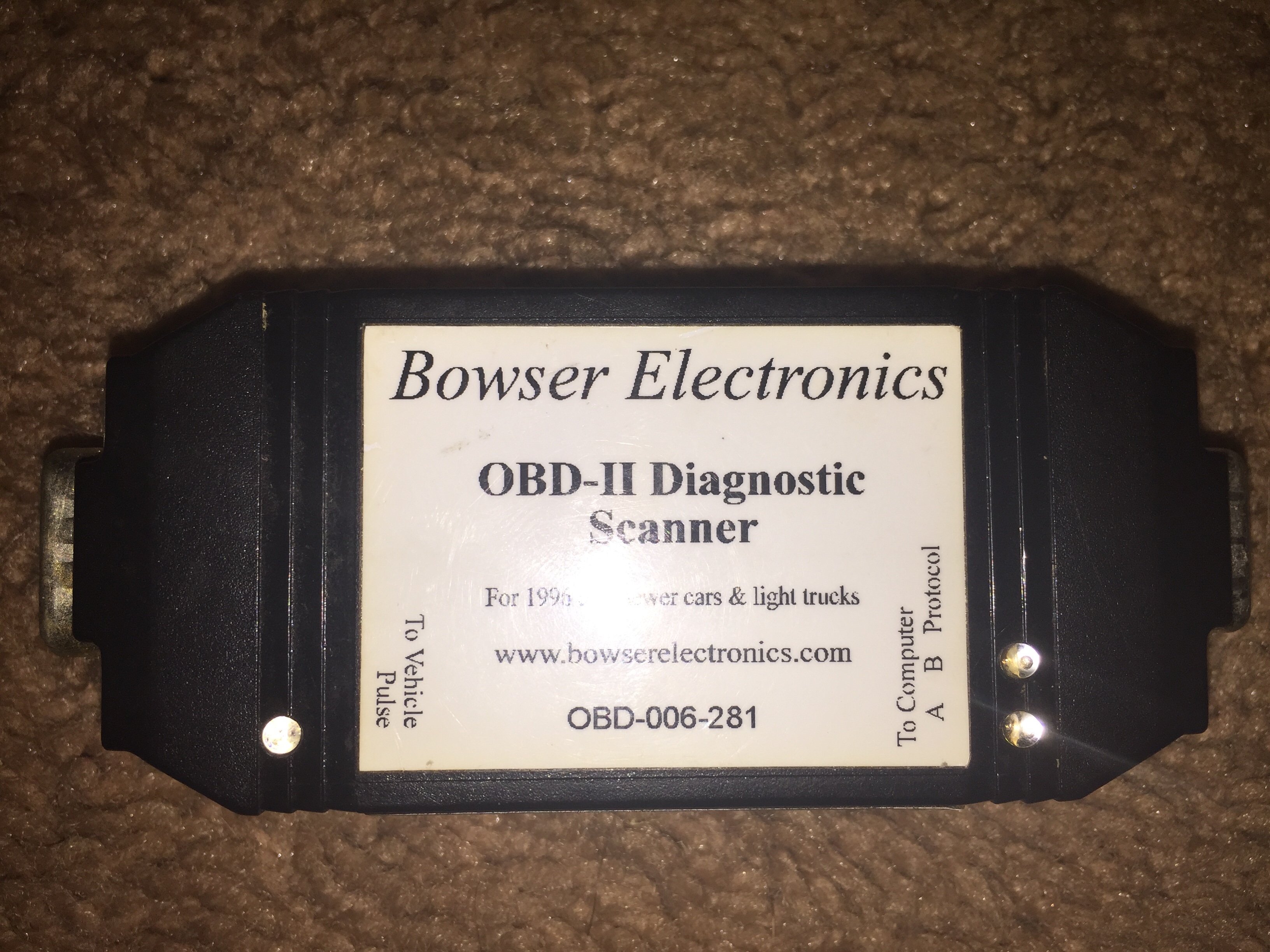

lilroud
Posts: 2
Joined: Mon Sep 17, 2018 1:19 pm
Post by lilroud »
I actually found mine today and attached pictures of it. It’s different than the one you got on the inside.
