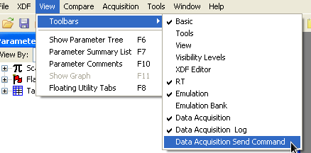

Re: Can I lock my auto in 3rd?
Open the ADX file (unzip first) in TunerPro, check that the settings for your com port etc are done and then...
It sends a command that tells the PCM to select 3rd gear.
- Posts: 10017
Yep, and you might also need to turn on the send command menu, which is done by turning it on here. Its not enabled by default.
