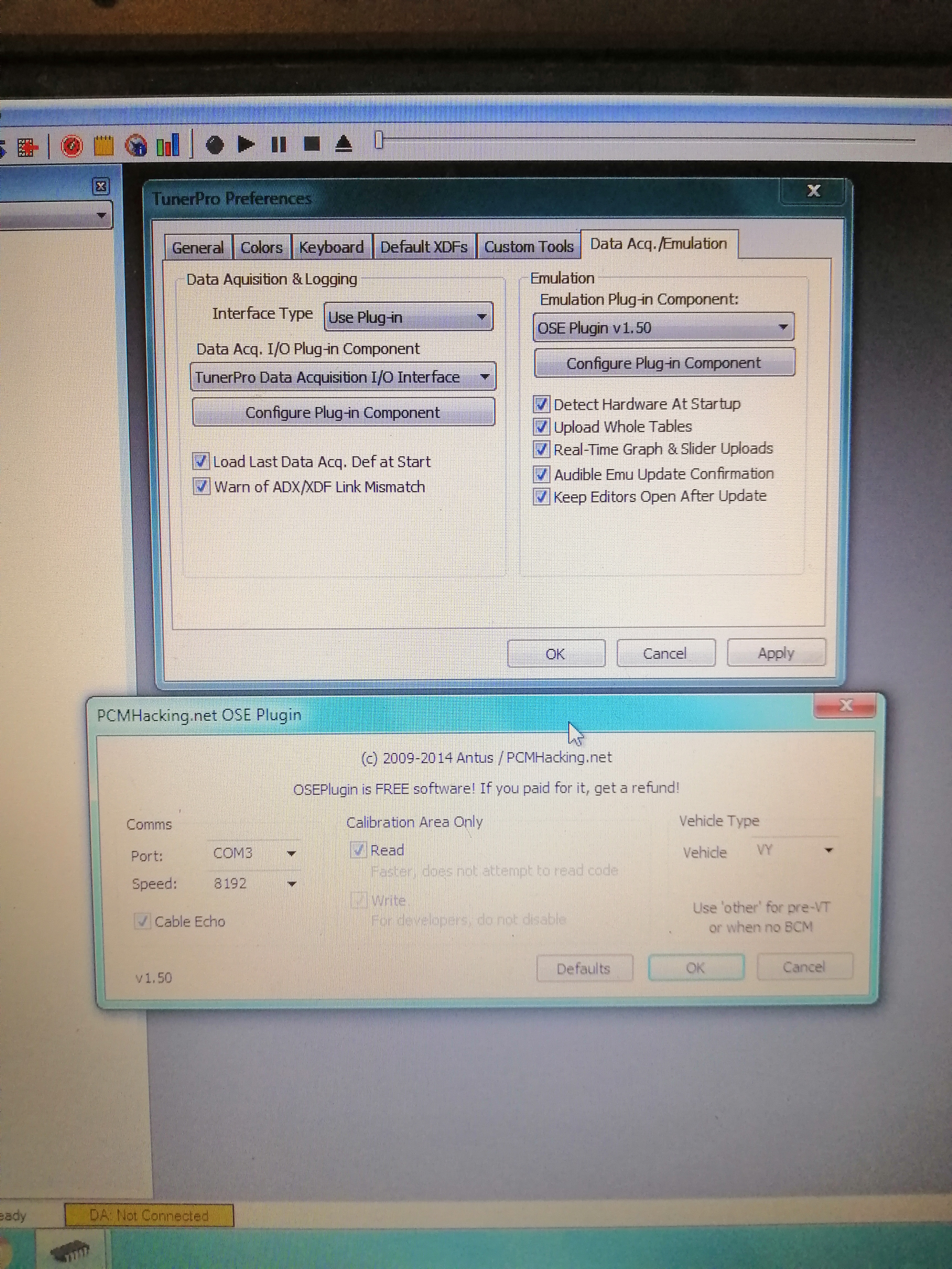

Ive had a chance to take a look at the log, but it doesnt look valid. Does the data look sensible when you view it on your side? Do you have echo selected in oseplugin?
Your plugin should be setup like this, but your com port will probably be different.

Hey sorry Antus been pretty crazy with these floods lately and haven't been out working on the car but will be back into it tomorrow, Sorry about my last reply I'm just really confused as to why it won't fire up lol ohh crap ok I will make sure I have the OSE plugin correct, Also would that mean that the changes I have made and flashed into the ecu would have no affect because I haven't got the plugin right ?

Sorry i meant to say isn't the OSE plugin only for ecu's with a NVRAM so you can do realtime tuning ?

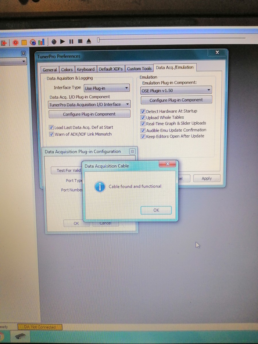

Got the OSE Plugin set up correctly now :thumbup:
