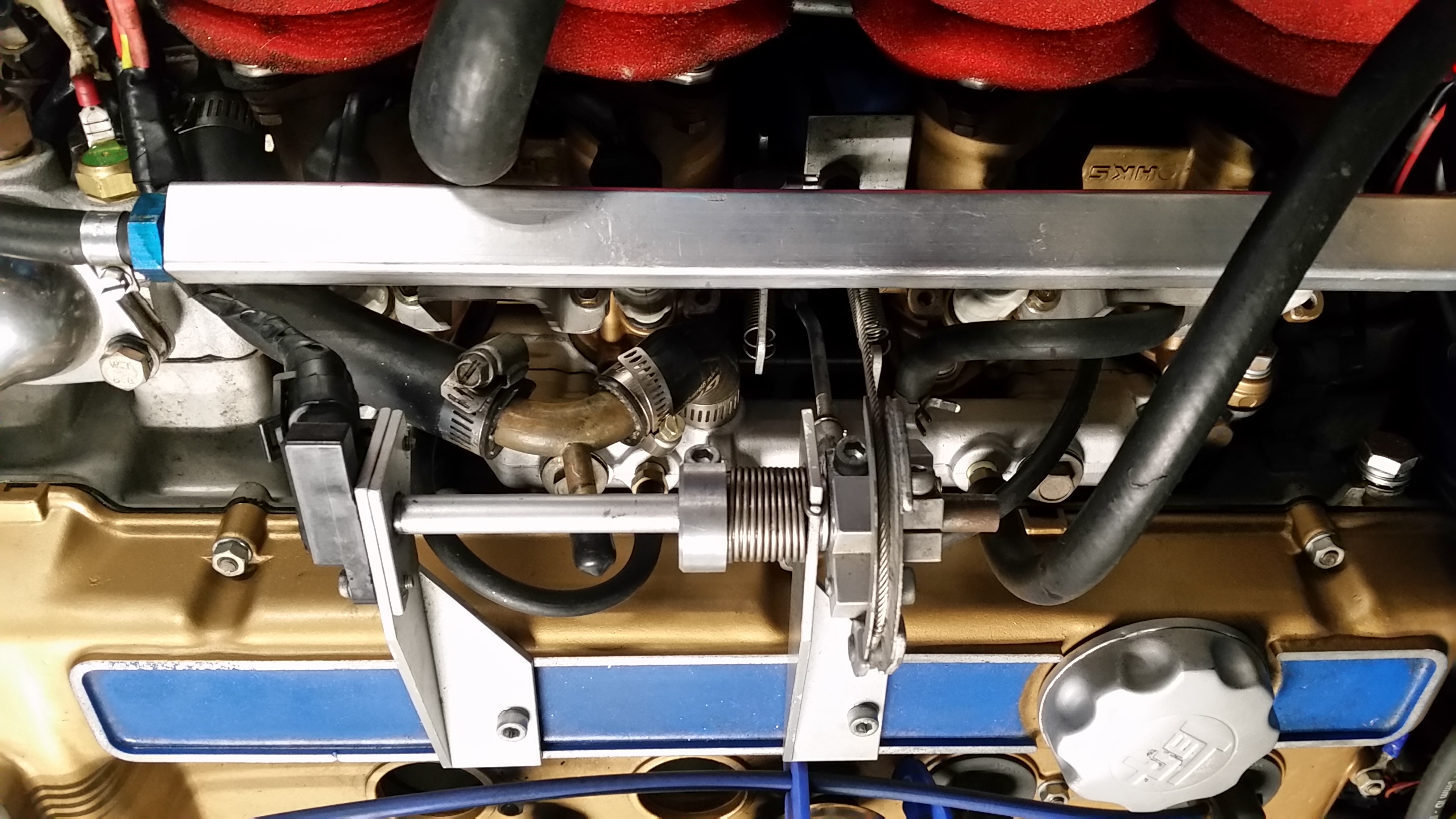

MAP
The engine has always run with very little vacuum due to the quad throttles and big cams. The lowest idle MAP I've had is about 60kpa. Would that set the MAP error?
When driving through hills it has had baro problems, leaning out badly until I go for high throttle/low revs for barometric update. I've tried a couple of MAP sensors, all the same.

Whole bin then I can see if anything has got corrupted. I would probably turn the baro run update off unless you are going thousands of feet up and down in a short amount of time. Do you have all the itbs linked into a vacuum manifold then connected to the map

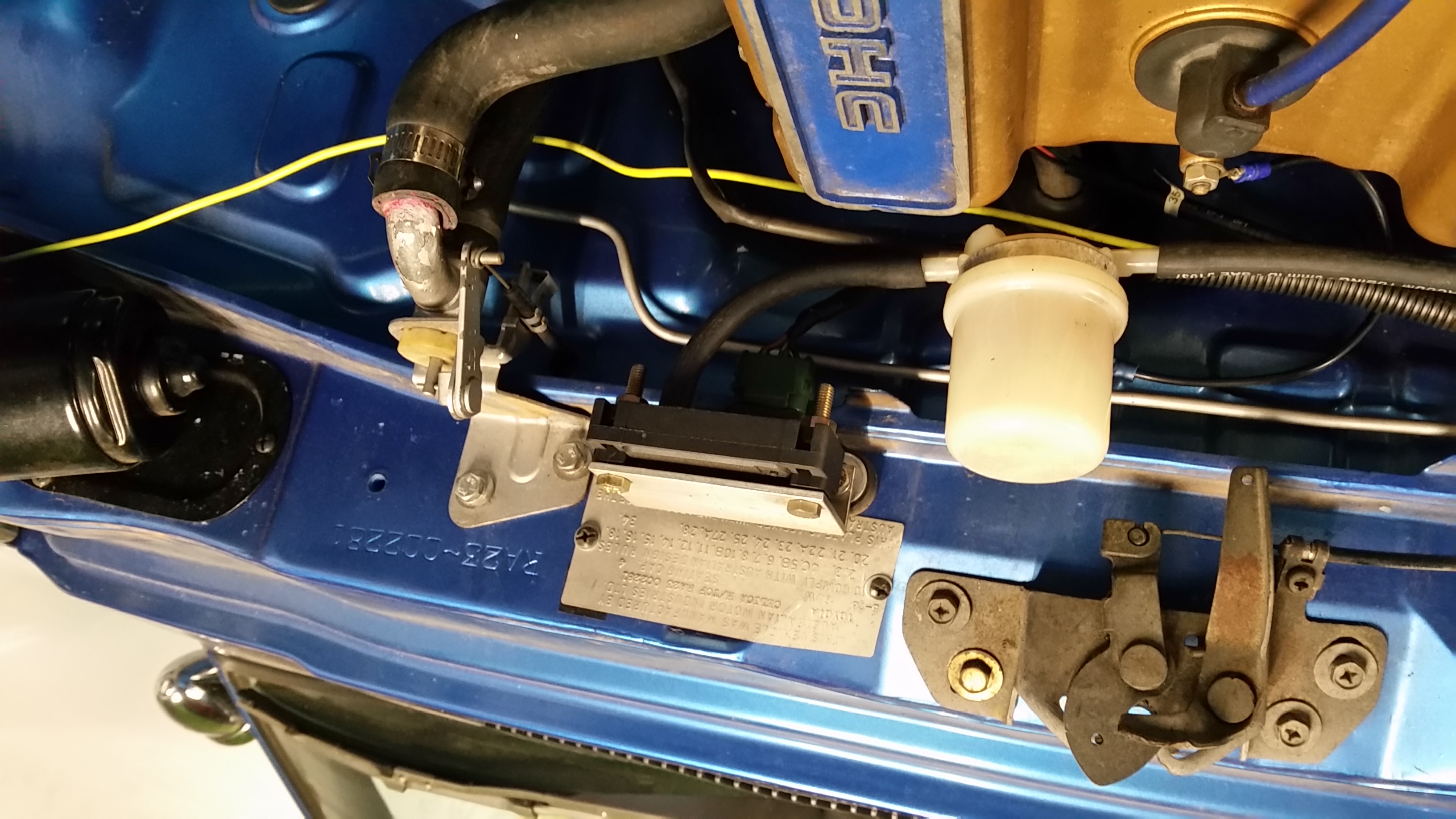

Throttles are mounted on factory carb manifold with balance tube. MAP vacuum hose comes from there and passes through a carb fuel filter acting as a vacuum reserviour.
I tried running the car without the baro update and it was almost undrivable as soon as I got up the first foot hill. I don't think it should be like that though.
