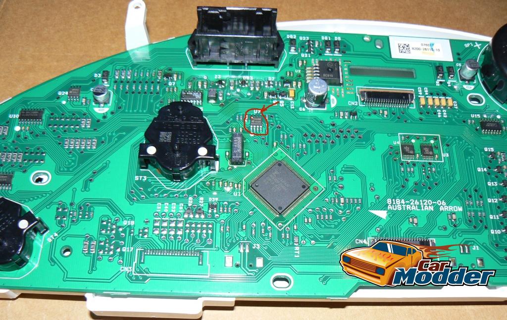

Anyone knows what cpu is in this IPC or have a pic of internal board.
Interesting the other file don`t match exactly the dumps. I suspect these are written in the eeprom area and don`t have any checksums. Maybe the os apply some form of checksum when the data is updated.

Do you have any pics of the chips and the internal pcb.

Again thanks to car modder forum this was the only image I could find...

I could read japan only. Maybe some NEC or Hitachi processor[ could be some processor used in BCMs also]. There is also the eeprom marked, where the other stuff is written.

Yeah so the eeprom is where those dumps are from.
Not sure how it correlates with mcu type, I have a feeling that picture is from a series 1 which isn’t even what the dumps I have supplied suit... so it could be completely different so I’ll have to try & get some better info!
