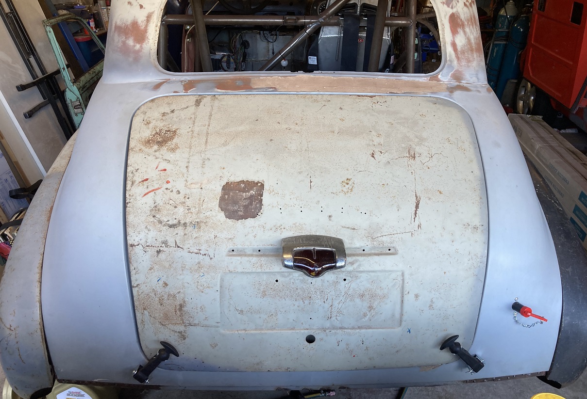

With the fuel system and panel changes in the boot of the car, there wasn't really much room for the original boot latch, so i got some of these rubber latch thingos :)

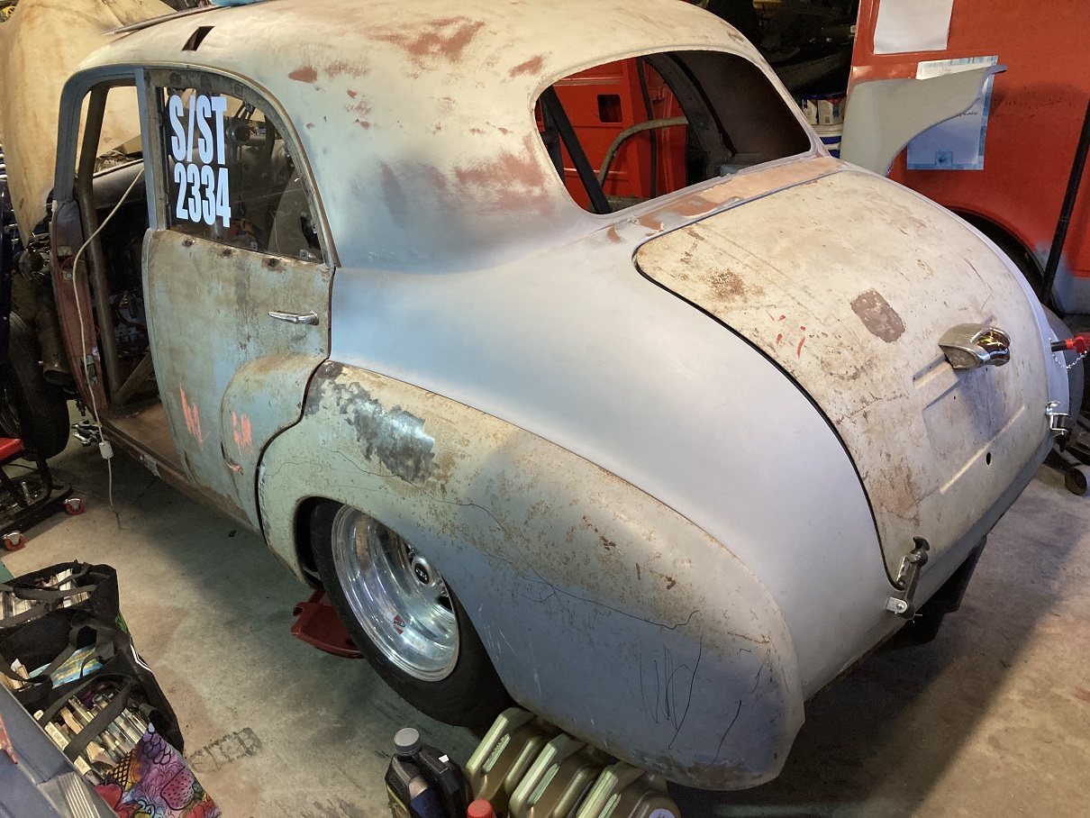

First door is fully finished with the mounting tabs for the poly carbonate windows, so i had to fit it up and put my racing number on!

Getting there after so much hard work. Is it Super Street category? I'm just going off the number on the window. Can't wait for a pic of the time sheet. I was at Mt Panorama for 4 days (Bathurst 6 hr) and there was a HD in the historic racing and boy it went like the clappers and extremely reliable. I had thought those engines were getting too old but learnt a lesson. There is no such thing as a slow race car.

Charlescrown, yes it will be initially Super Street, then once i get any kinks ironed out and the required safety gear to run in Super Sedan i will step up to that .... its just a lot more cost per year and i dont want to be paying it if its not needed.

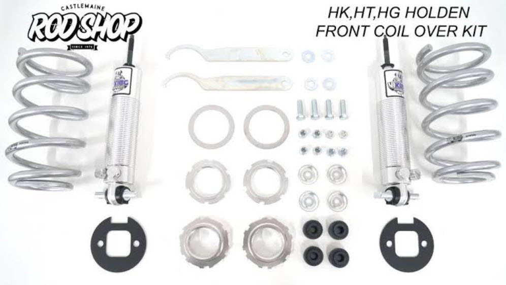

The front springs in the FX i thought were a good height but when the front guards etc were all on it ended up too low, and the wheels are really too wide of an offset so my solution was to get slightly higher springs so the wheels wouldnt hit on the guards .... in looking at options i wondered if there was some form of coilover for these that would 1. give adjustability in the height and 2. give compression/rebound tunability ....
turns out there is, and best of all its the same brand and type of shock i have in the rear!!
im still waiting on delivery of these, im pretty keen to get them in!!
