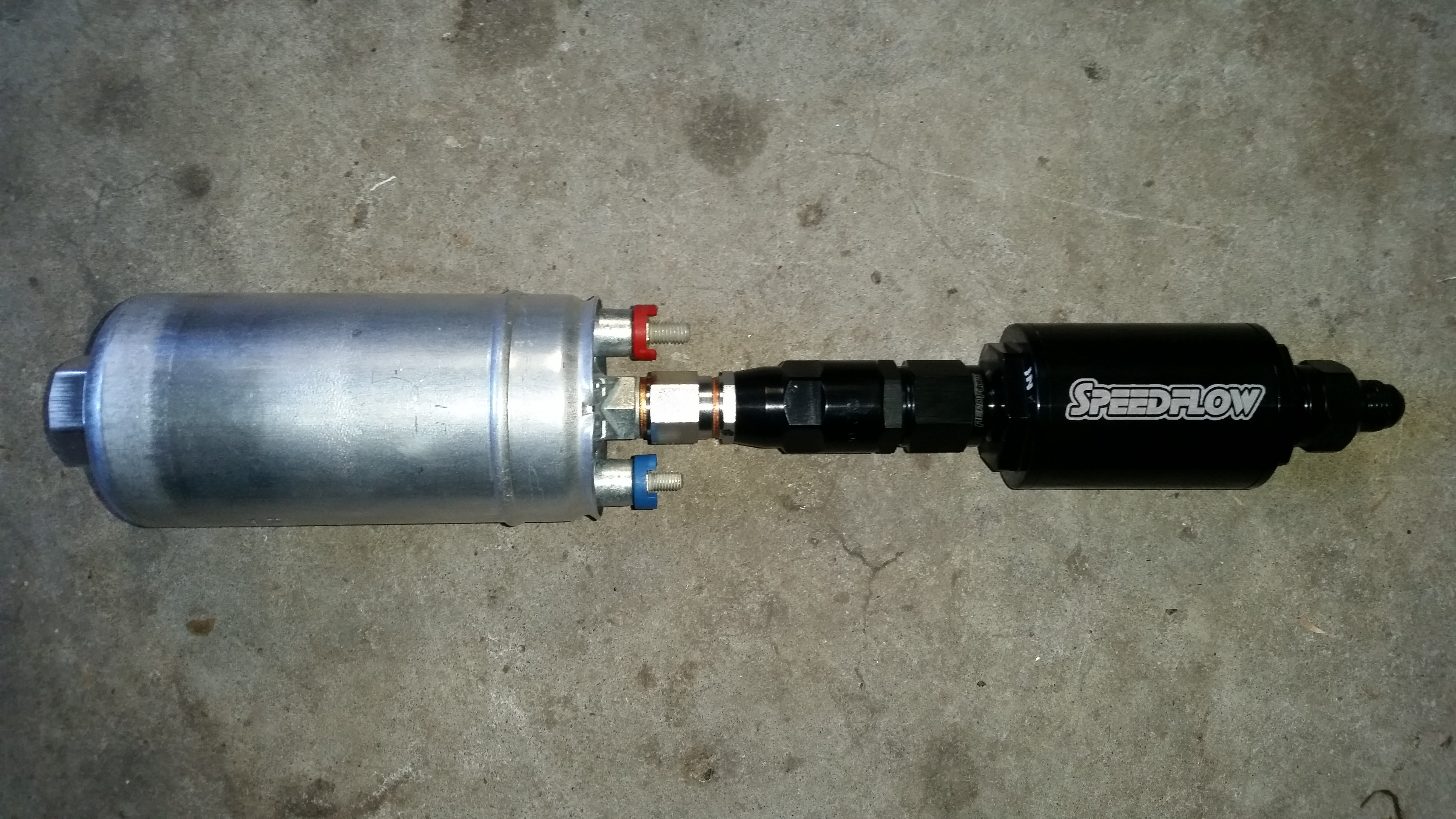

This is what I just purchased today. A Bosch 044 with replaceable built in check valve going into a -8 adaptor which allows a 40mm diameter SpeedFlow filter to be connected directly to the pump. The filter then has a -6 reducer fitted on the exit and from there connects straight to the 3/8 hardline utilising either compression fittings or tube nuts, I haven't decided on that bit yet.
The 044 pump will be fed via 3/8 hardline into a banjo fitting connected directly into the inlet side of the pump. The banjo fitting will allow me to place the pump as far as possible towards the rear of the car giving me room to fit the whole lot into the confines I have. I was unable to place the old pump in Plan A this far back as the 12mm supply hose had absolutely no chance of making the necessary bends between the tank and the pump. Not a hope in hell.

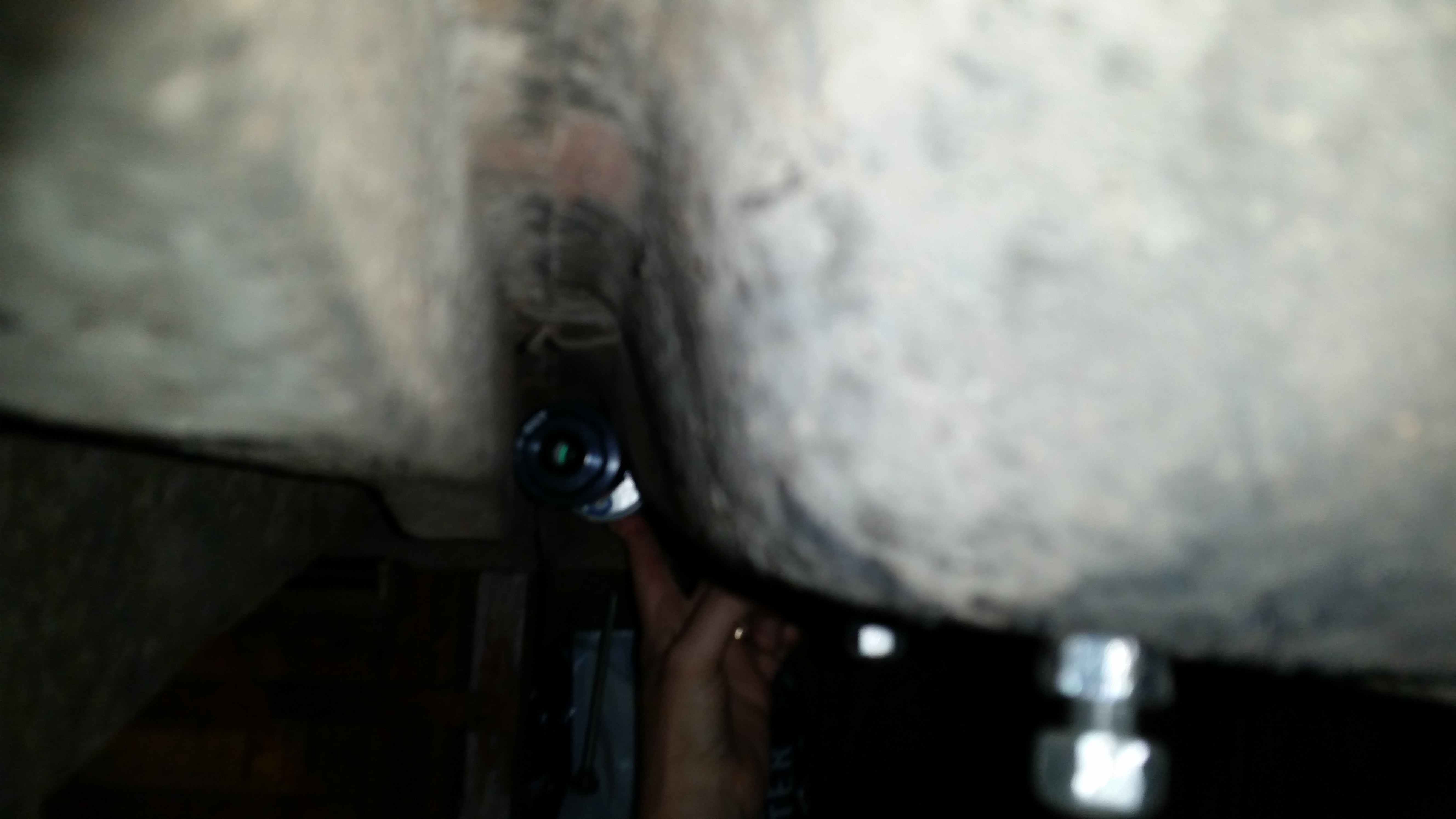

This 1st photo was taken from the centre of the rear of the car looking towards the driver side. The hanger bracket for the leaf spring has full range of movement without fouling anything.

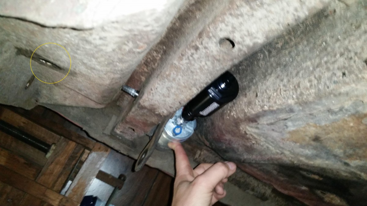

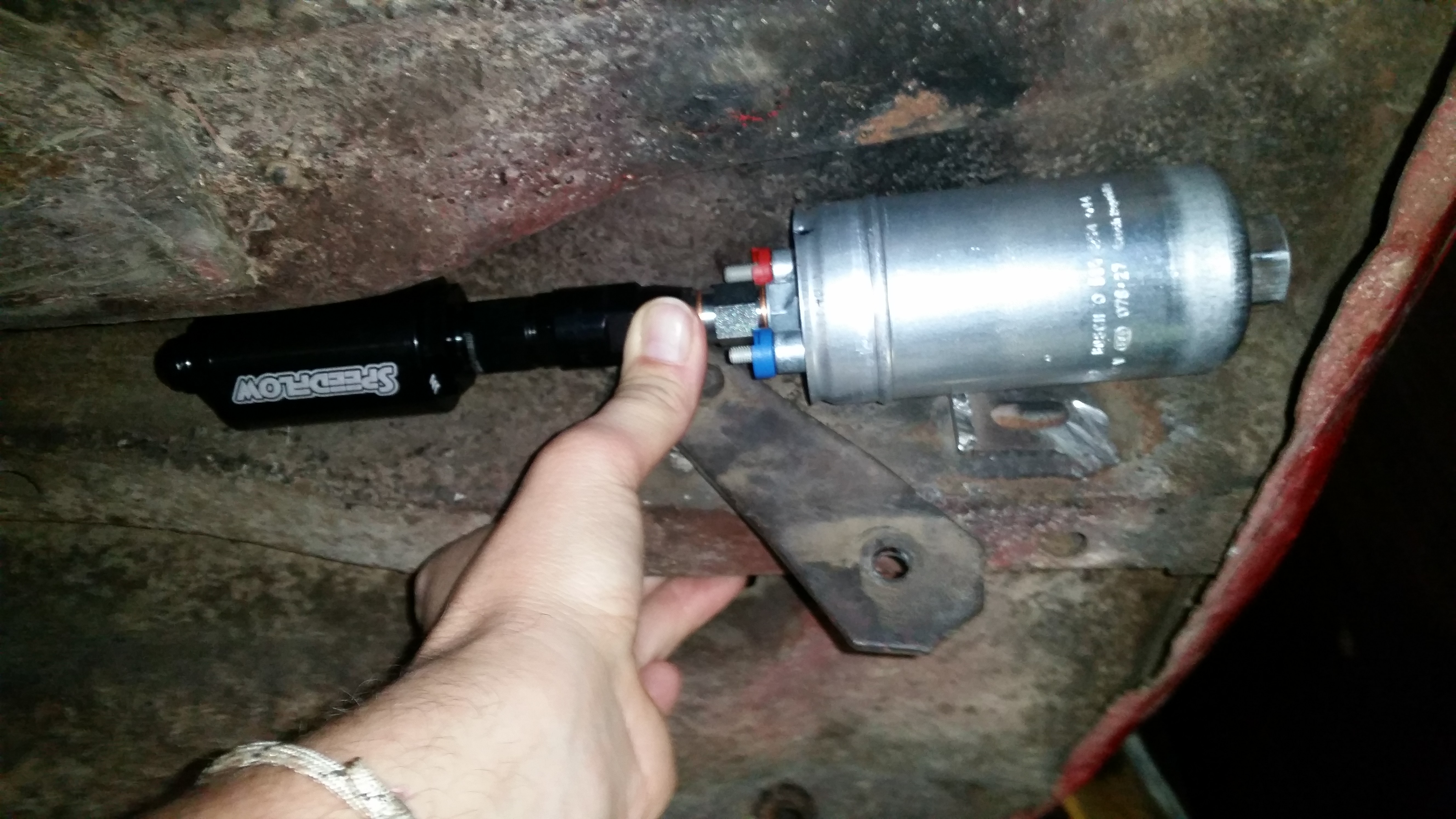

This was taken looking down the chassis rail showing the gap between the chassis rail & the boot floor & where the pump & filter sit & where the hardline has to go as it exits the filter.
In this photo you can see the exit point of the fuel tank circled in yellow. Plan is to have a 90 degree elbow exit towards the rear of the car, then a pre-pump filter followed by a hardline continuing towards the rear of the car, behind the spring shackle, under the chassis rail & finally into the pump via the banjo fitting,
