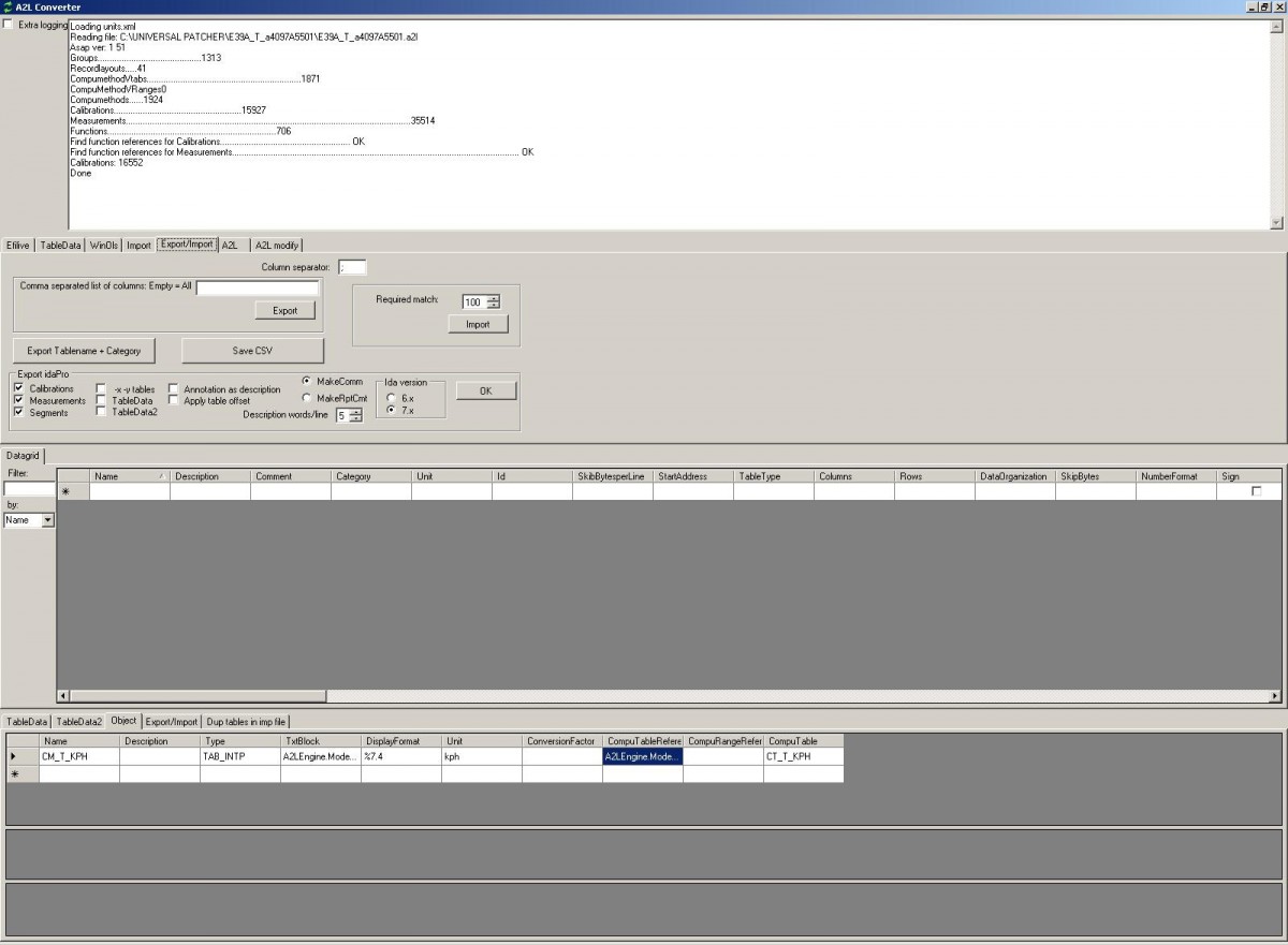

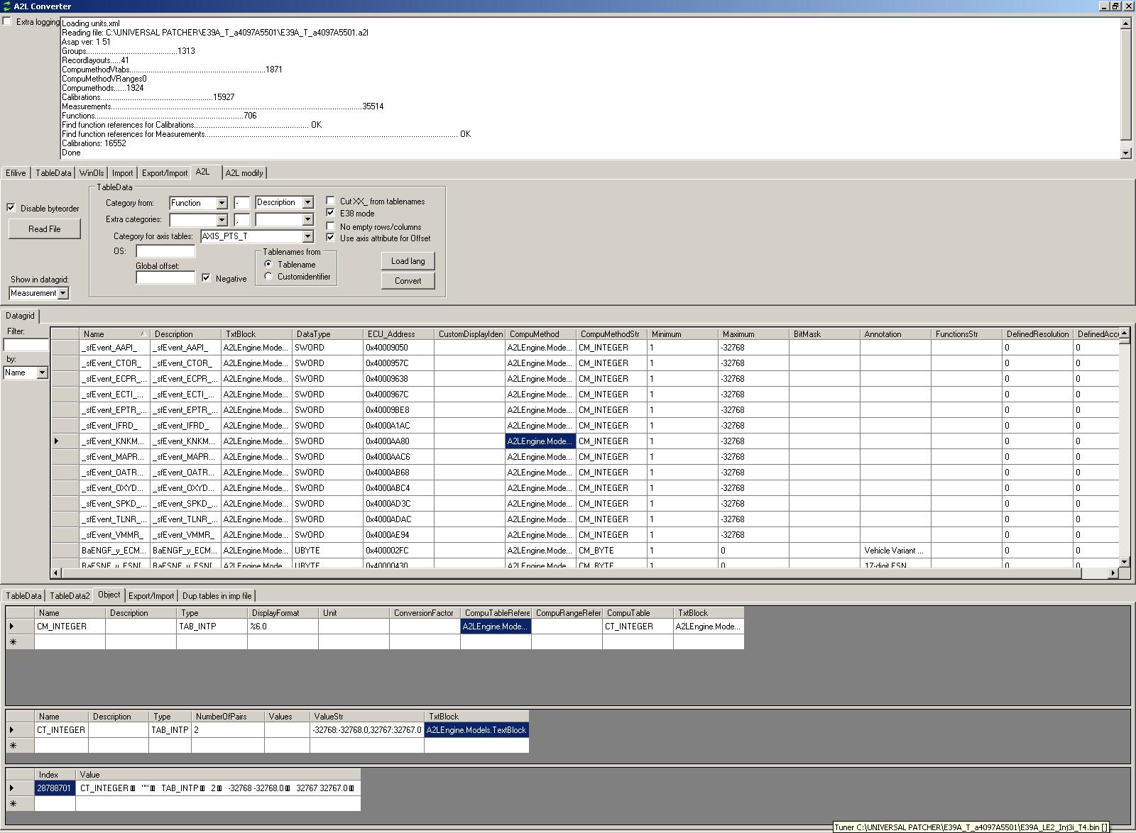

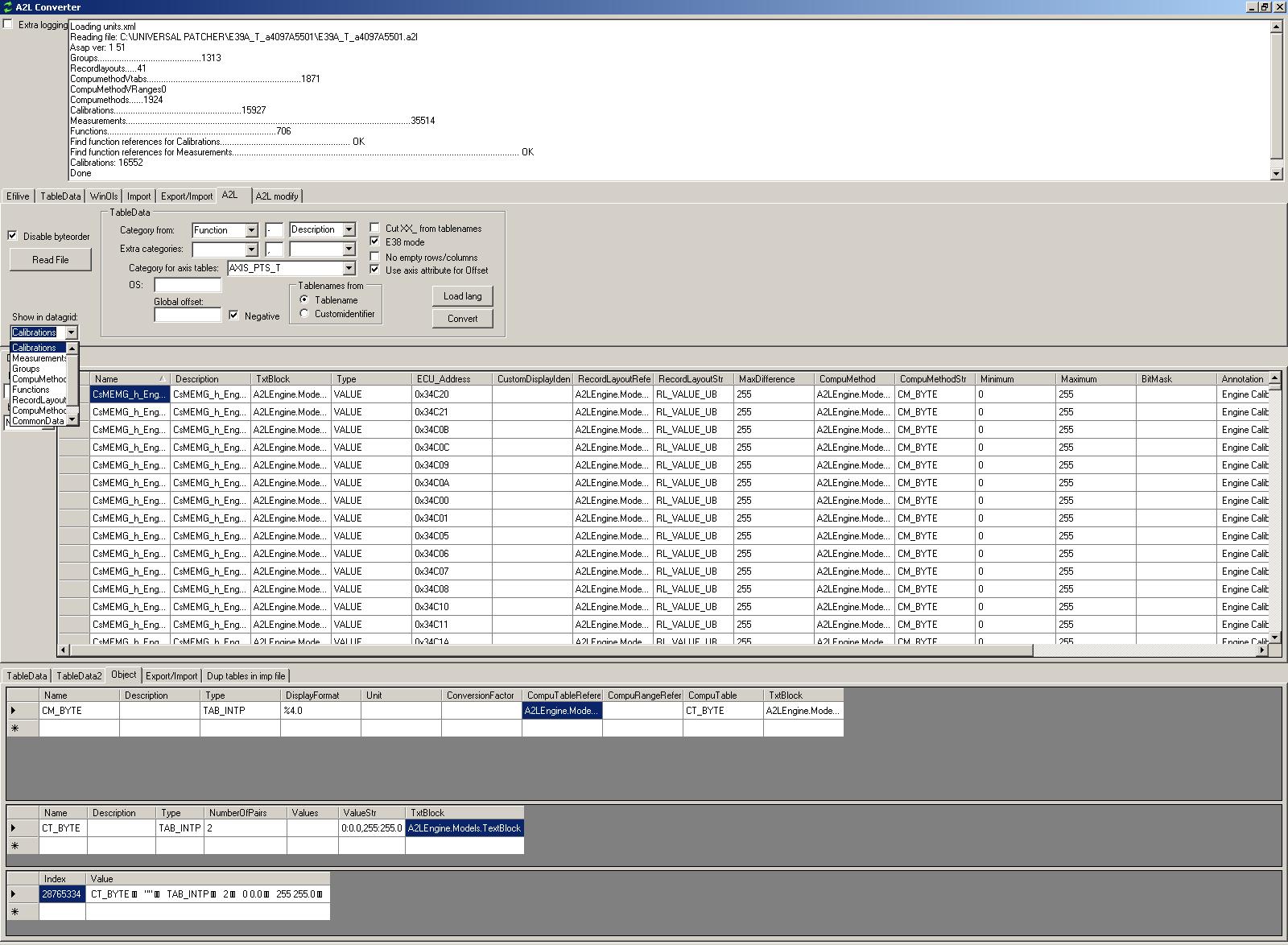

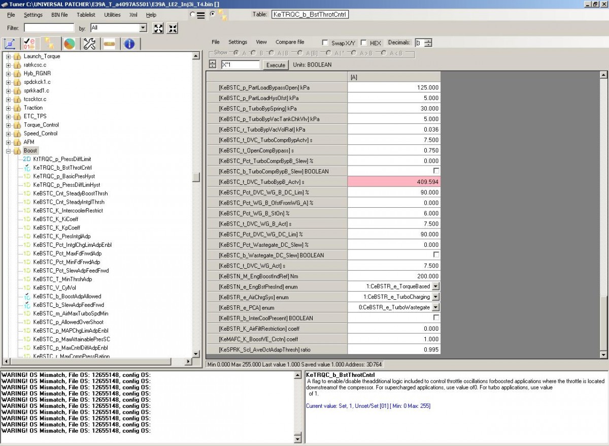

Here some screenshots of a new tool being developed to convert various formats to various formats.
Main features is to
- parse a2l files to more usable Universal patcher xml format.
- convert a2l files to IDA pro scripts.
- import/export csv files and update existing files by a key
- edit a2l files addresses by specific offset.
- convert a2l files to empty tableseek files
As a side project
- winols parser, that convert .ols and .kp to Universal patcher xml format.
Here some screenshots using files floating on the web.
loading the a2l displaying calibration displaying measurements[ram region] idapro export options loading xml file for bin editing
