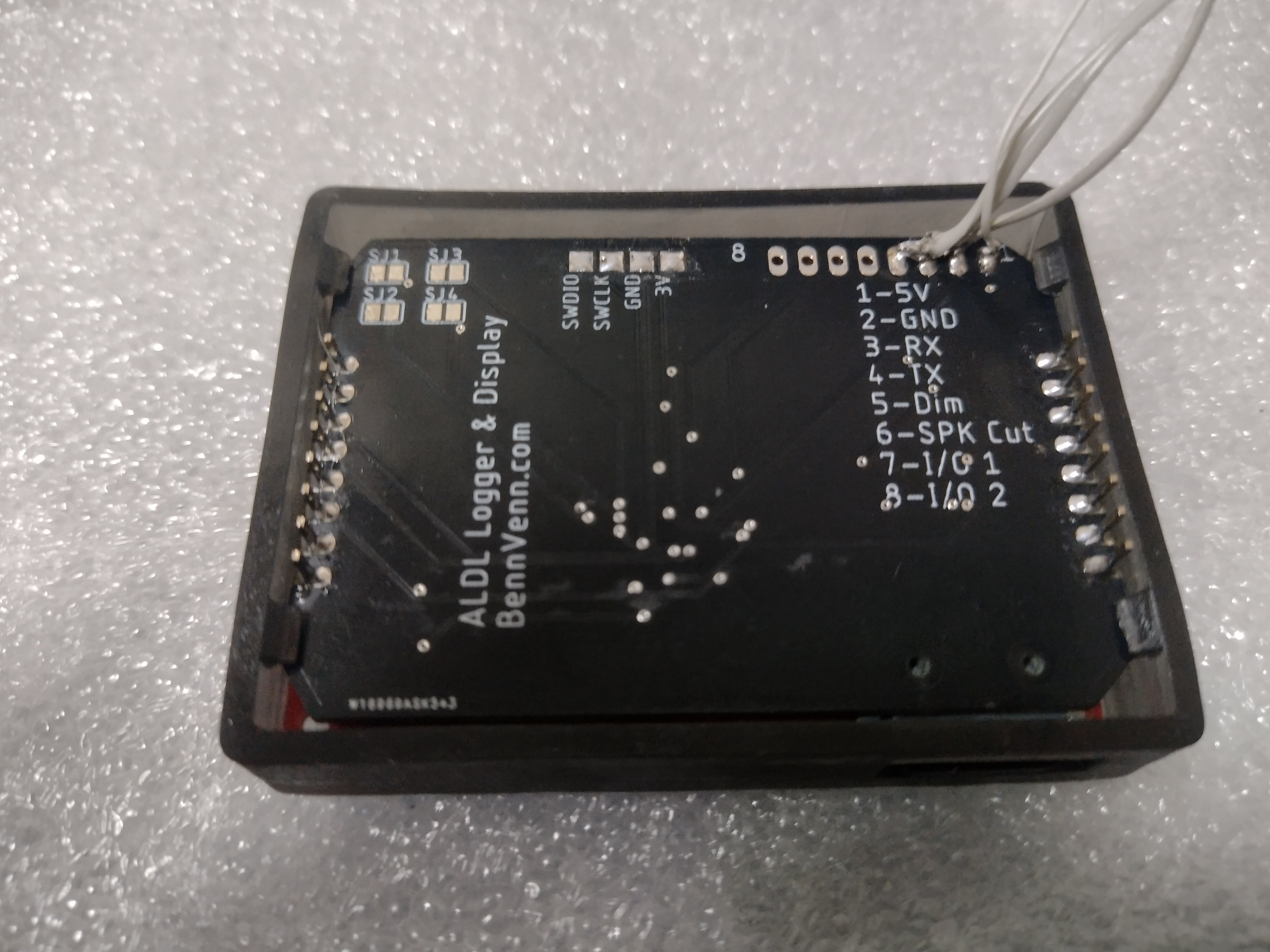

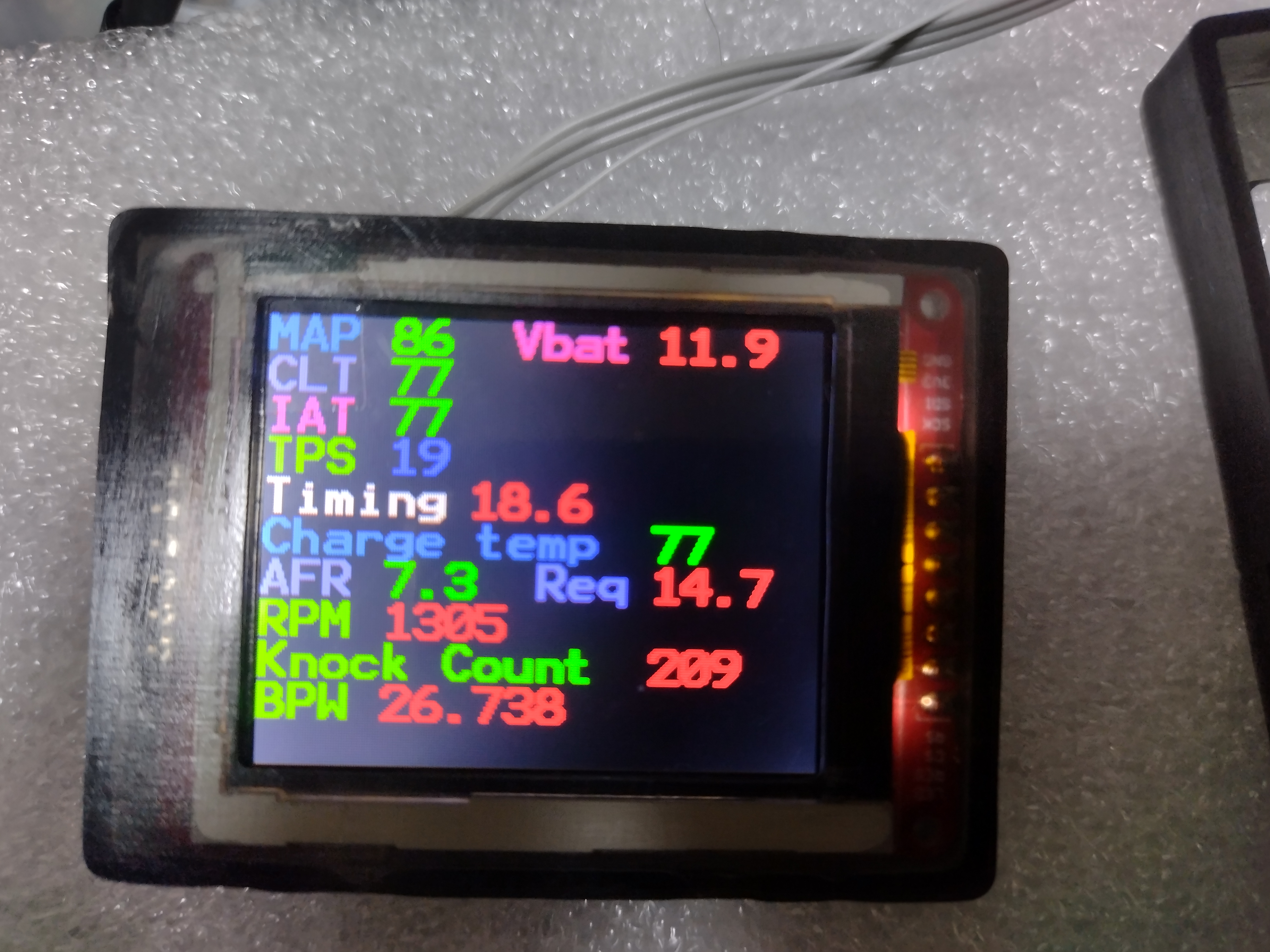

Firmware and feature update - V0001
Increased screen redraw speed by up to 10x (only updates changed values, not a full screen redraw per frame)
Multiple Windows now supported [up to 10] (complete different screens depending on sensor values - e.g. change from KPA to PSI when in positive pressure, warnings on high coolant temp, DTC codes, Show AFR when above or below thresholds etc)
Screen dimming when the DIM pad on the back of the screen is 5-12vdc. Can be inverted via config.txt so the screen is DIM when grounded.
2 channel PWM IO added - 25hz designed for boost solenoids / water injection etc. Up to 16 points per IO table, can reference any sensor input e.g. Boost vs RPM or Boost vs KPH, FAN PWM vs IAT etcIncreased screen redraw speed by up to 10x (only updates changed values, not a full screen redraw per frame)
