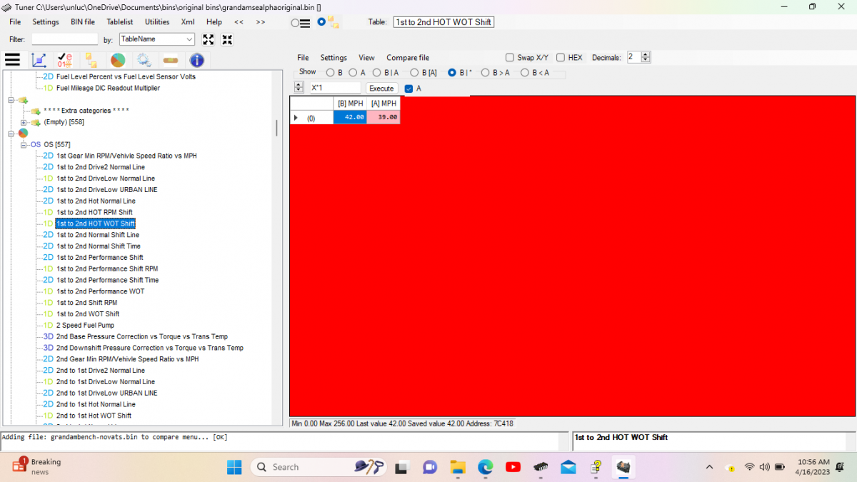

I did finally get to compare bins side by side in tiny tuners which i'm pretty ecstatic about. Big differences in fuel cut off and things like 1st to 2nd HOT WOT shift between the se and gt version(se is on the left at 42). I'm just clicking through, i'm not sure if i can save the bin modified in tiny tuners and it sticks and can be written onto the pcm or i need hptuners for that. hptuners seems harder for me to work with because i cant find the side by side. Tiny tuners colors if theres a difference also.
