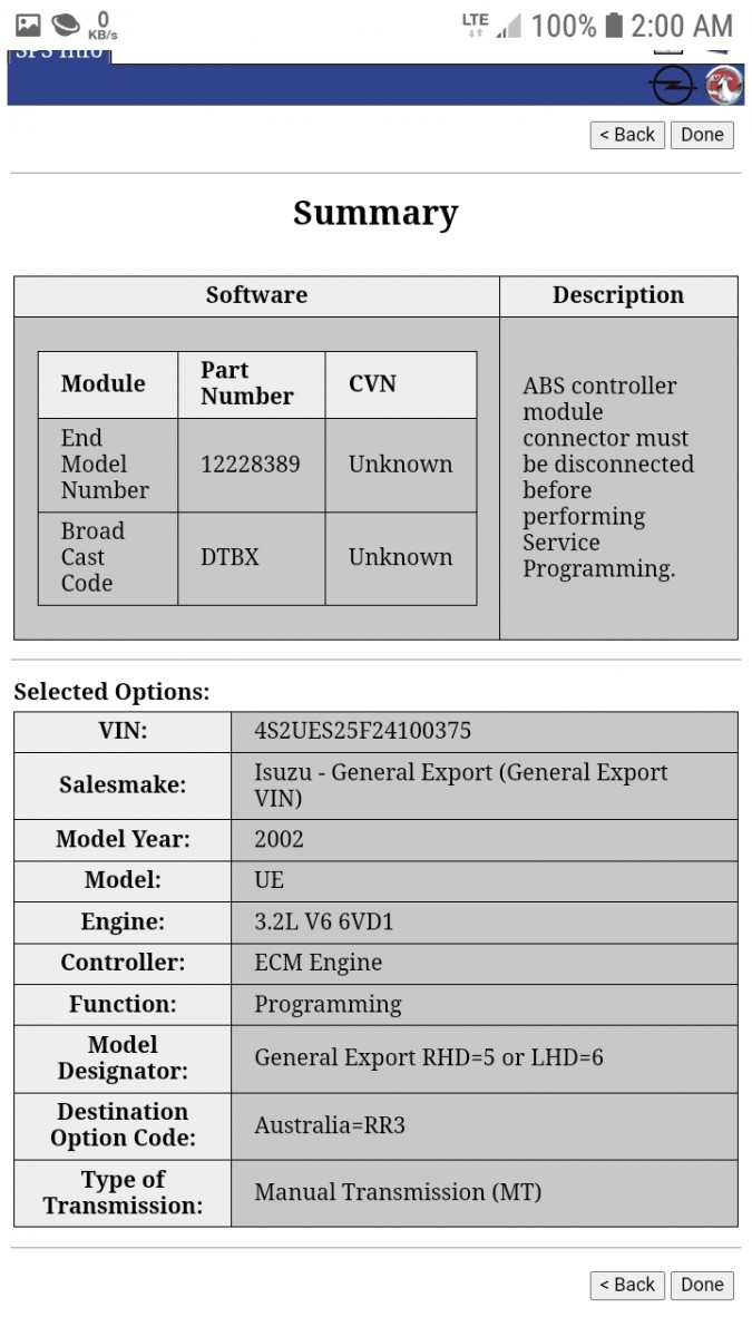

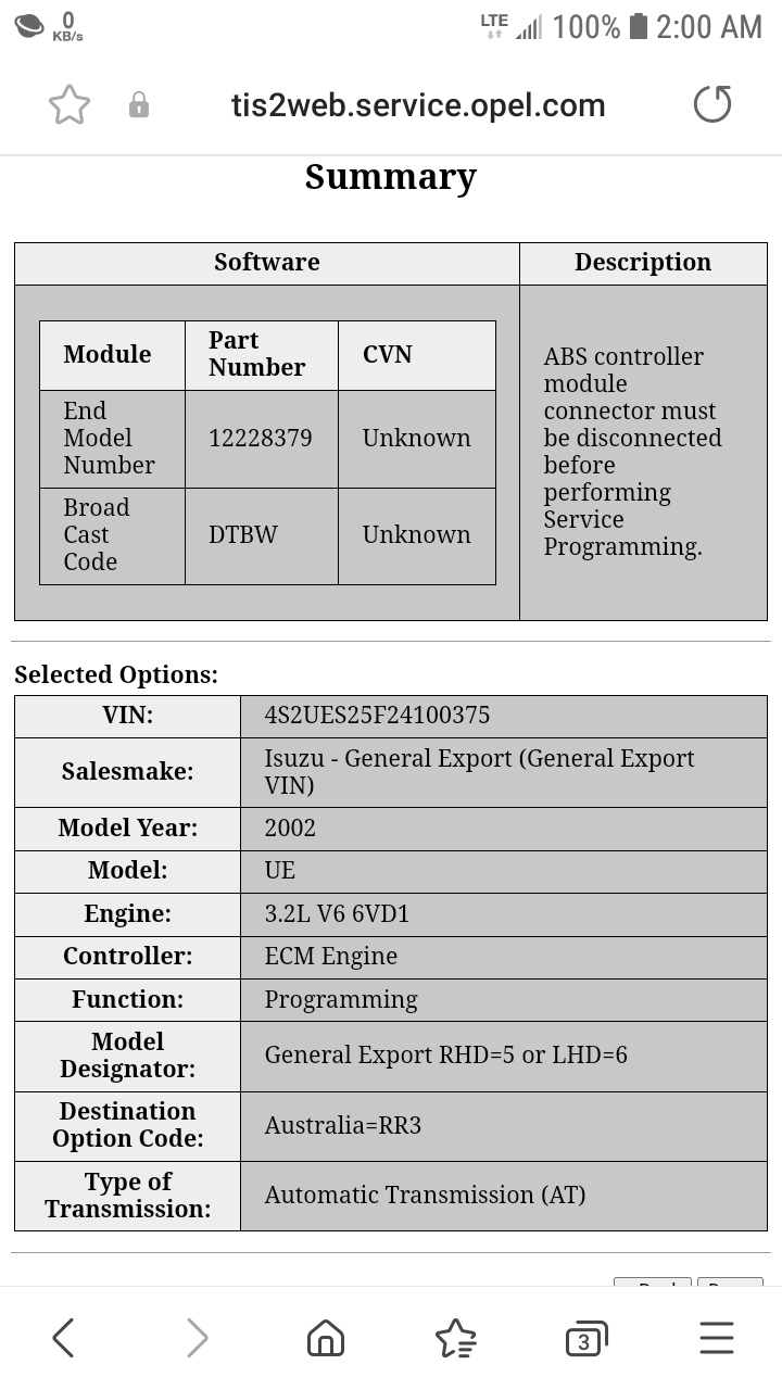

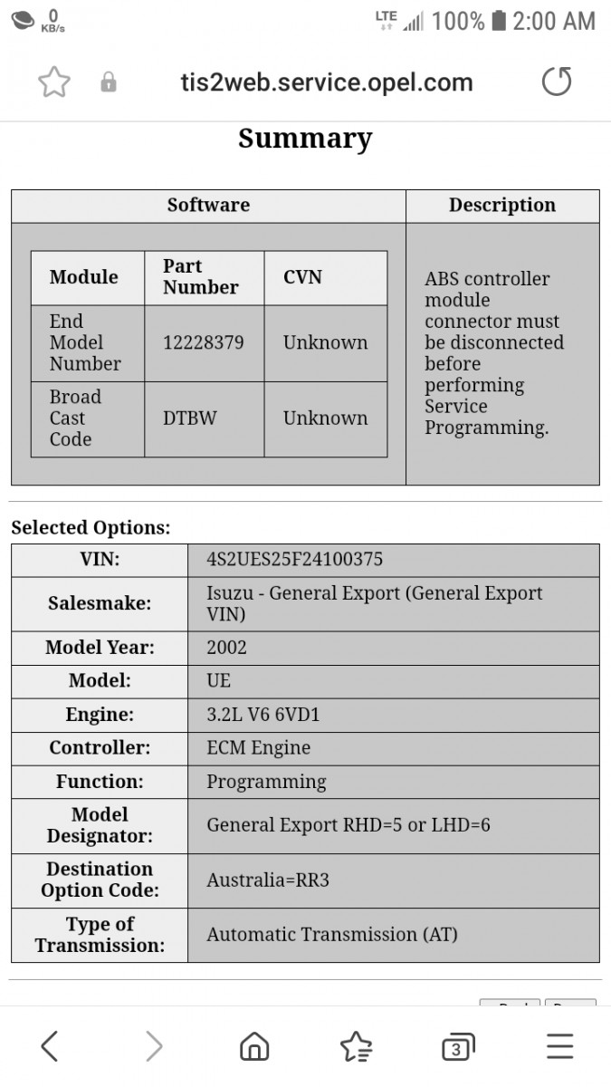

things I came across. manual is different then auto for broadcast code (bcc).

manual trans

when selecting sales make it asked if Holden or Isuzu. module part number and broadcast number is different with manual trans vs auto transmission.

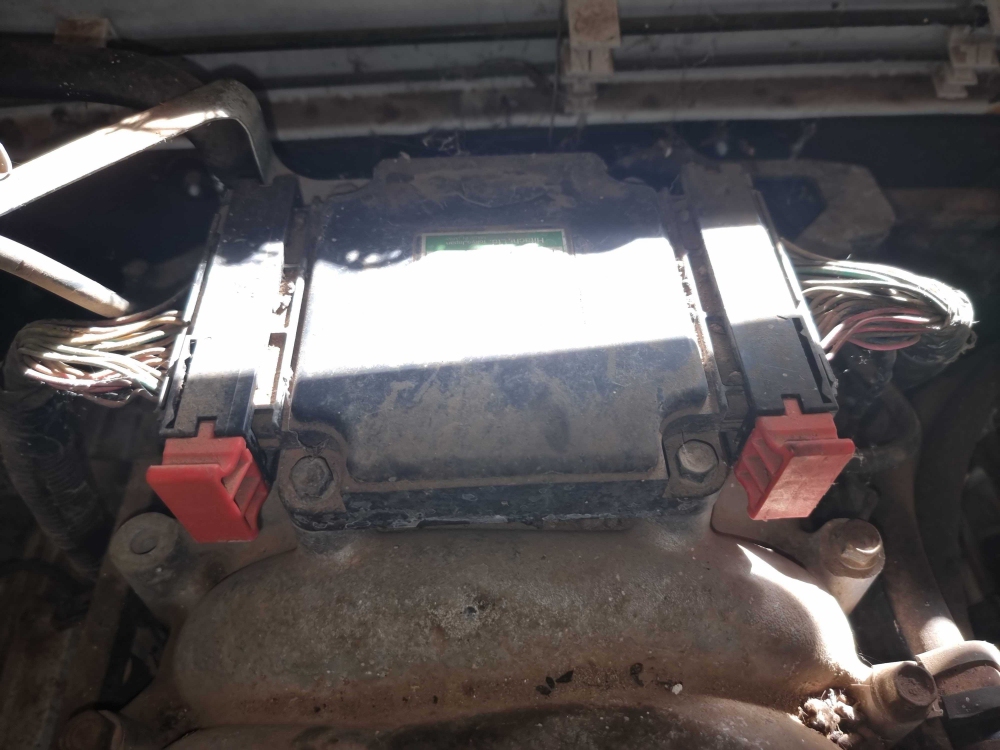

I had a spare couple of hours this afternoon, so I went to my local wrecker and had a look at a couple of Aussie 2002 V6 Petrol Rodeos. Both had Isuzu ITEC PCMs though (Hitachi), not like the one in this thread. The ITEC was mounted on the top of the engine and had a single long connector on each end. Definitely not a Delphi PCM. :thumbdown:
