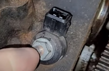

v8fan - See image below.
This is a photo of a genuine sensor on an S10 v6 which as you say is a wideband type.

That type of sensors I saw at every European car
They have different part numbers - so they have some differences
What number does it have ?
