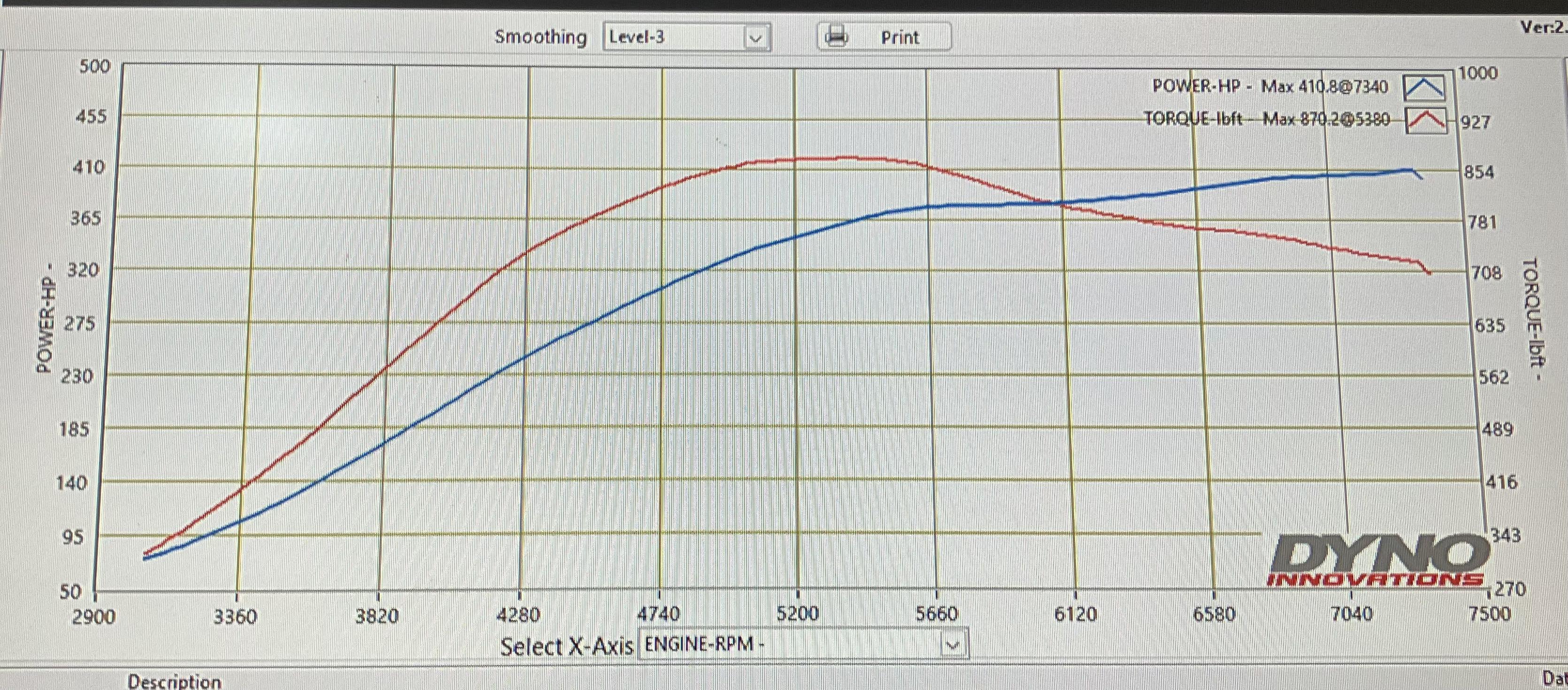

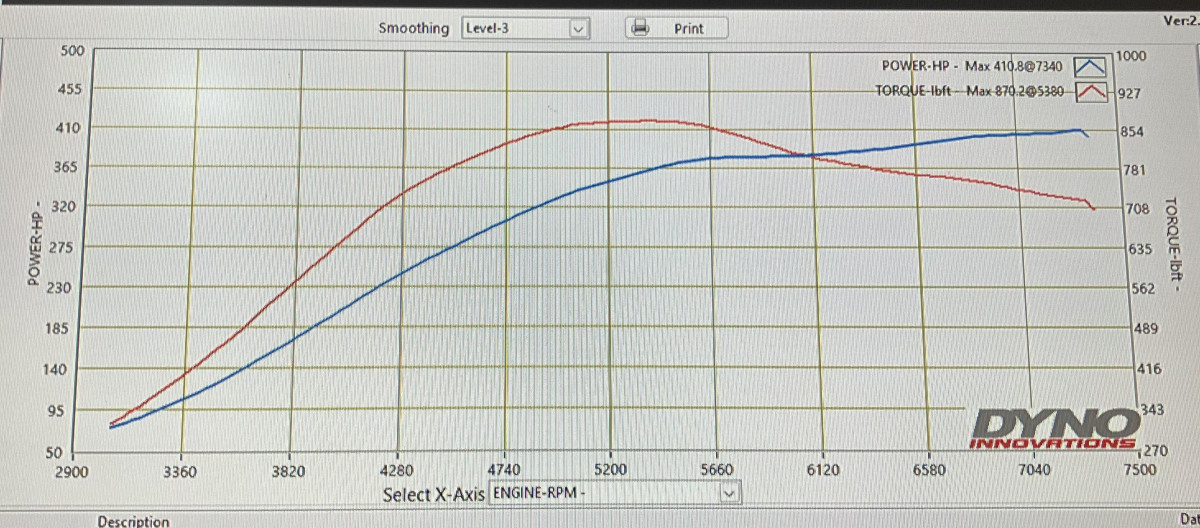

so after i built the new motor, i put it on the dyno to confirm oil pressure and sadly it still had the same issue, i had more pressure but it still dropped off at high revs.
we played around with different oil pumps and shims in the pressure side etc and ended up adding some more oil which was enough to get a mostly full pull, and a horepower PB!
disregard the RPM along the bottom, its about 1200-1500rpm higher than actual.

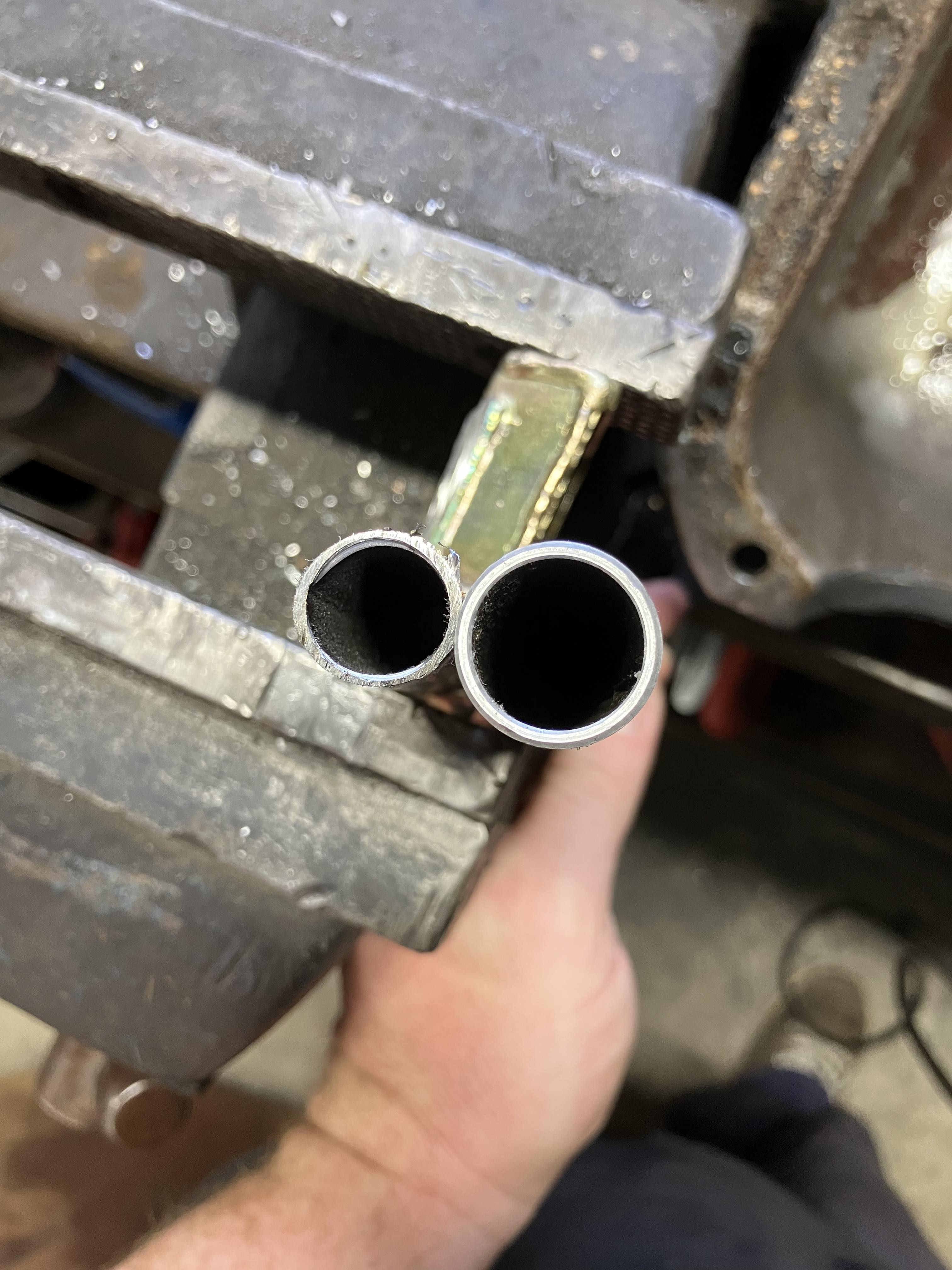

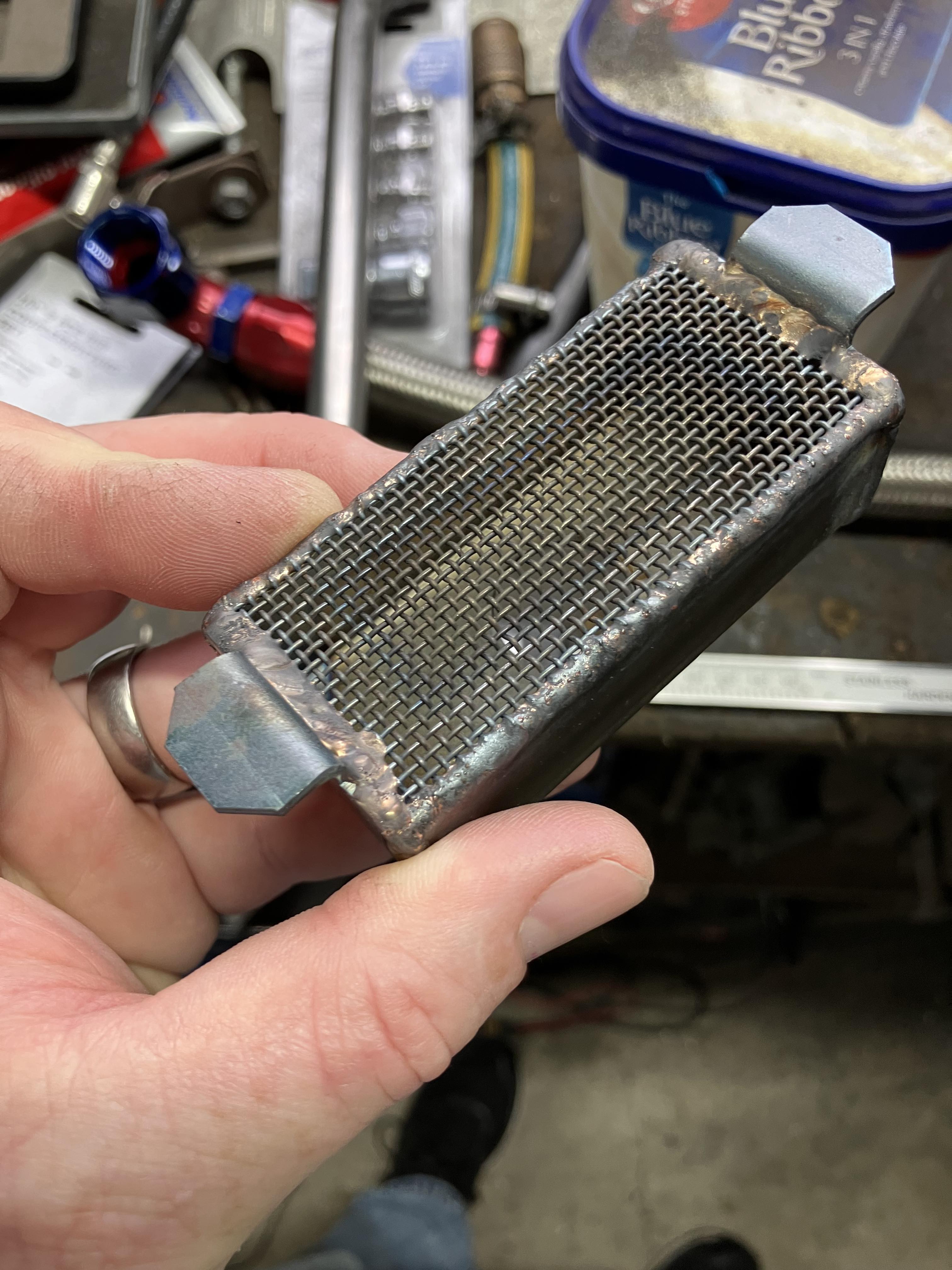

So this is the pickup i had in it .... the filter part of it is probably a bit of a restriction, but even if its not the diamater of the tube probably is!
As you can see the new pickup tube is a fair bit larger, and this tube matches the AN fitting ID as well as the braided hose ID.
I also got a filter which is much more flowy than the old one!

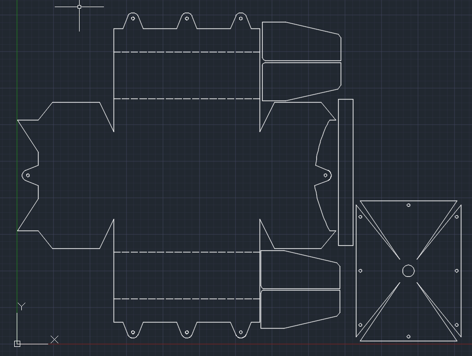

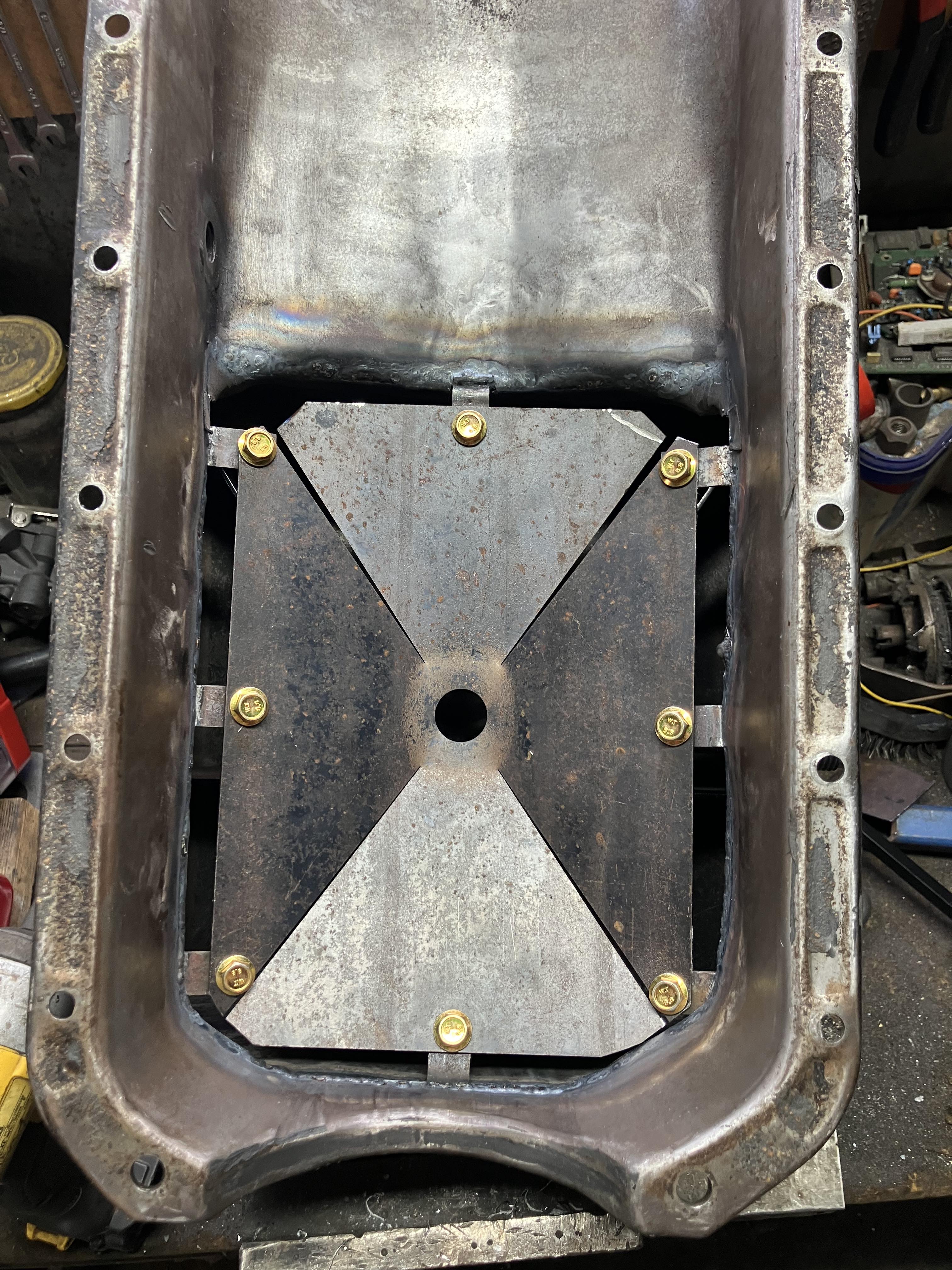

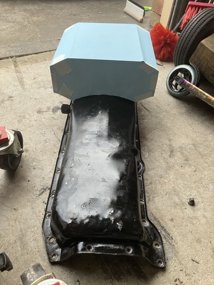

So i took a heap of measurements and drew up a cad design, and then printed it and transferred to cardboard ... happy with that!
So once i was happy with the cad file i added a few pieces for baffles and oil diverters etc and then got the whole lot lazer cut.

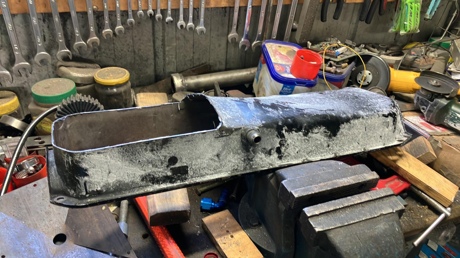

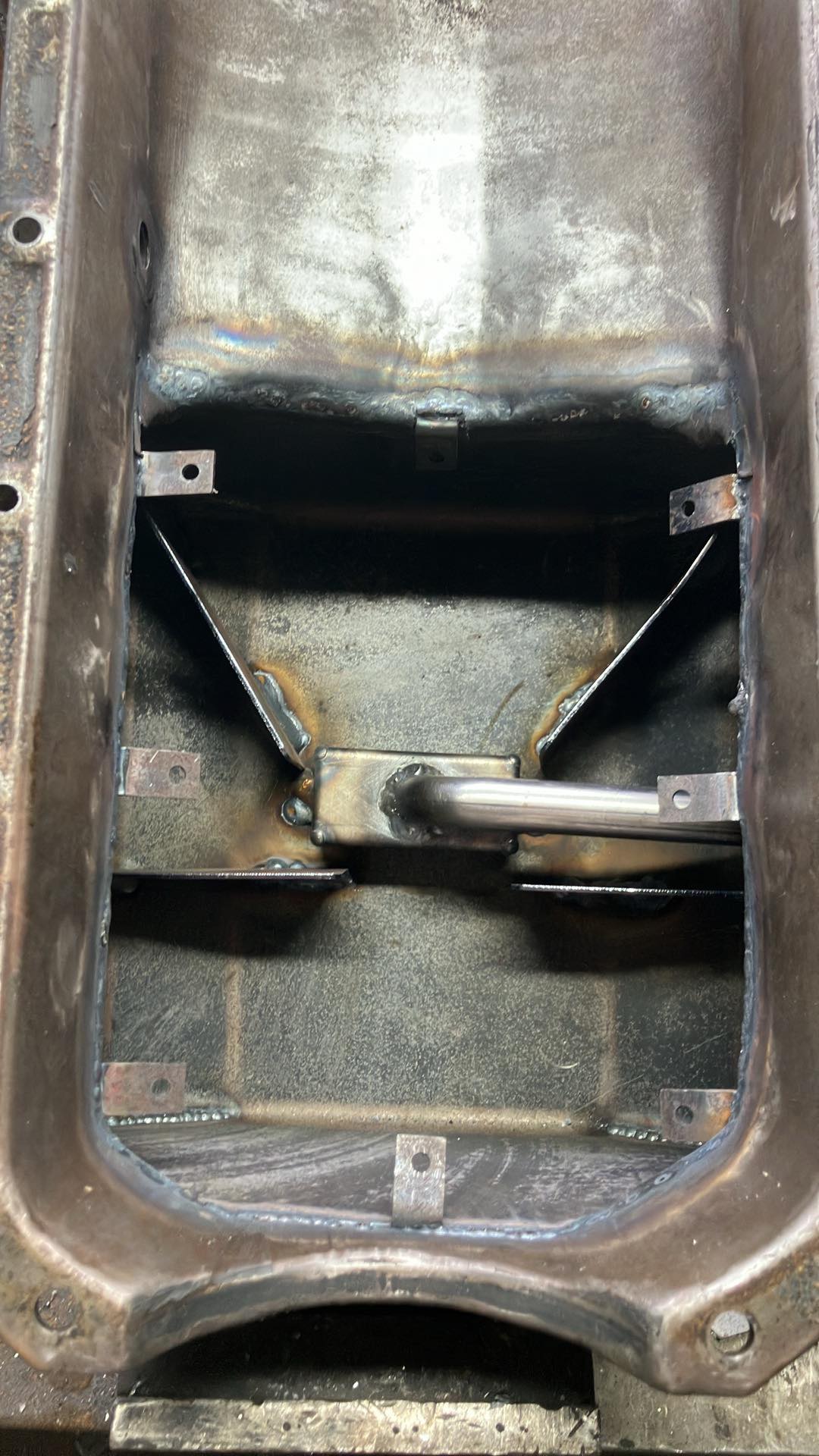

I then hacked the bottom off my original sump.

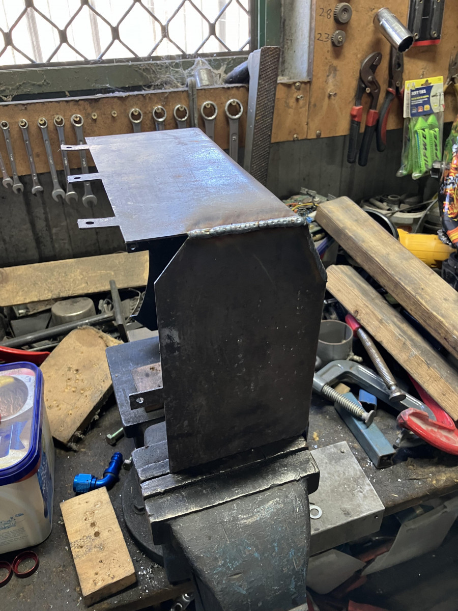

and started bending and welding up the ikea flat pack kit!

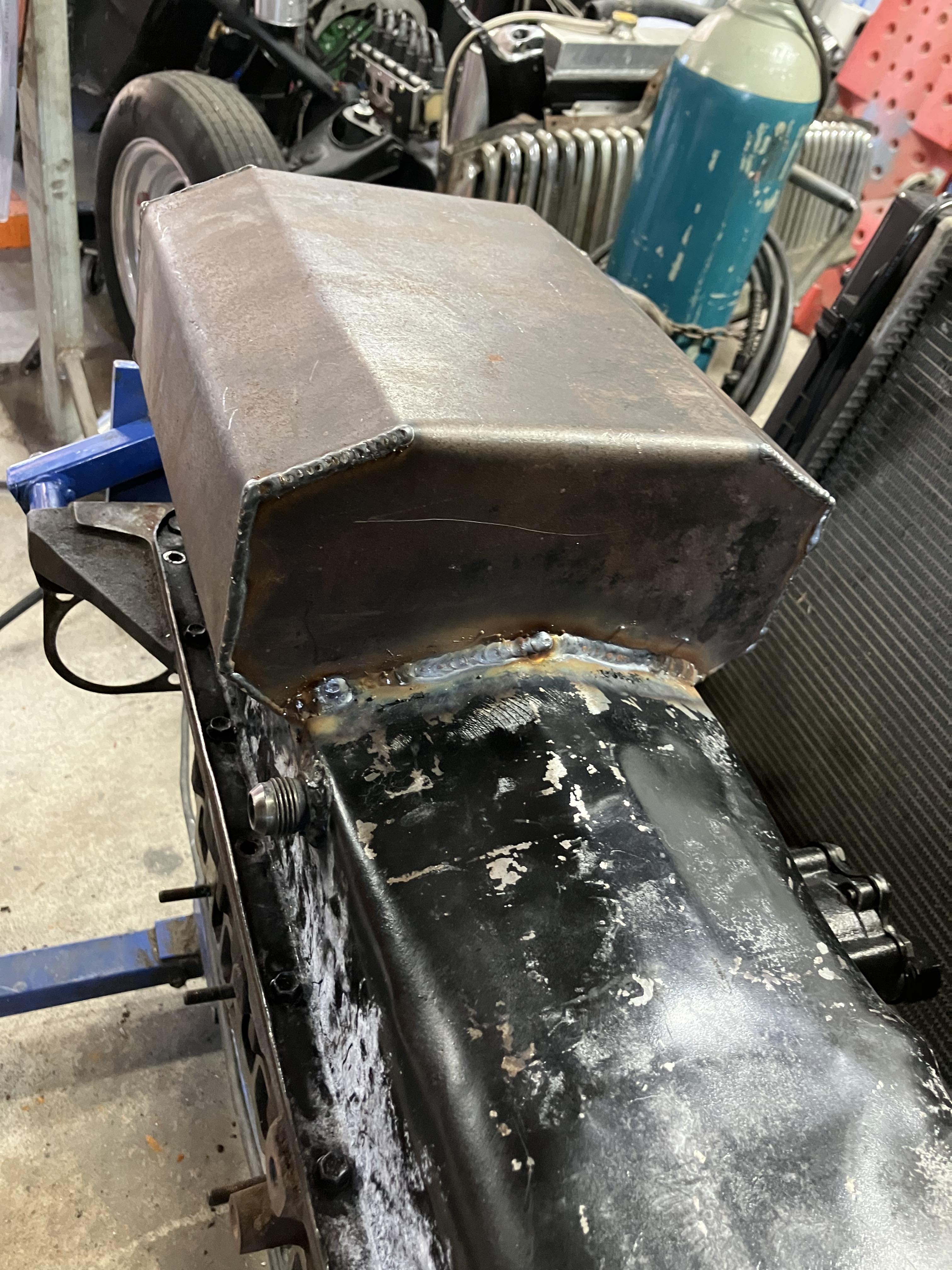

Then glued it onto the sump!
Then added some plates to try and keep as much oil at the pickup as possible on a launch.
Then put a baffle over the top of it. (only thing not in this picture is the cut out for the dipstick).
Welded the AN fitting on the outside and we're good to go!

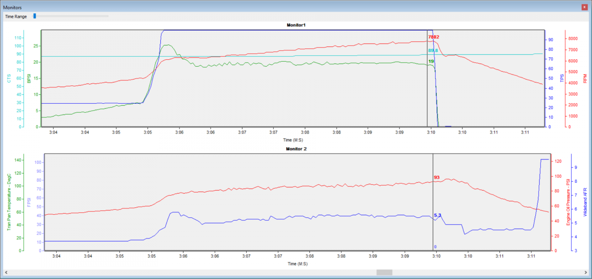

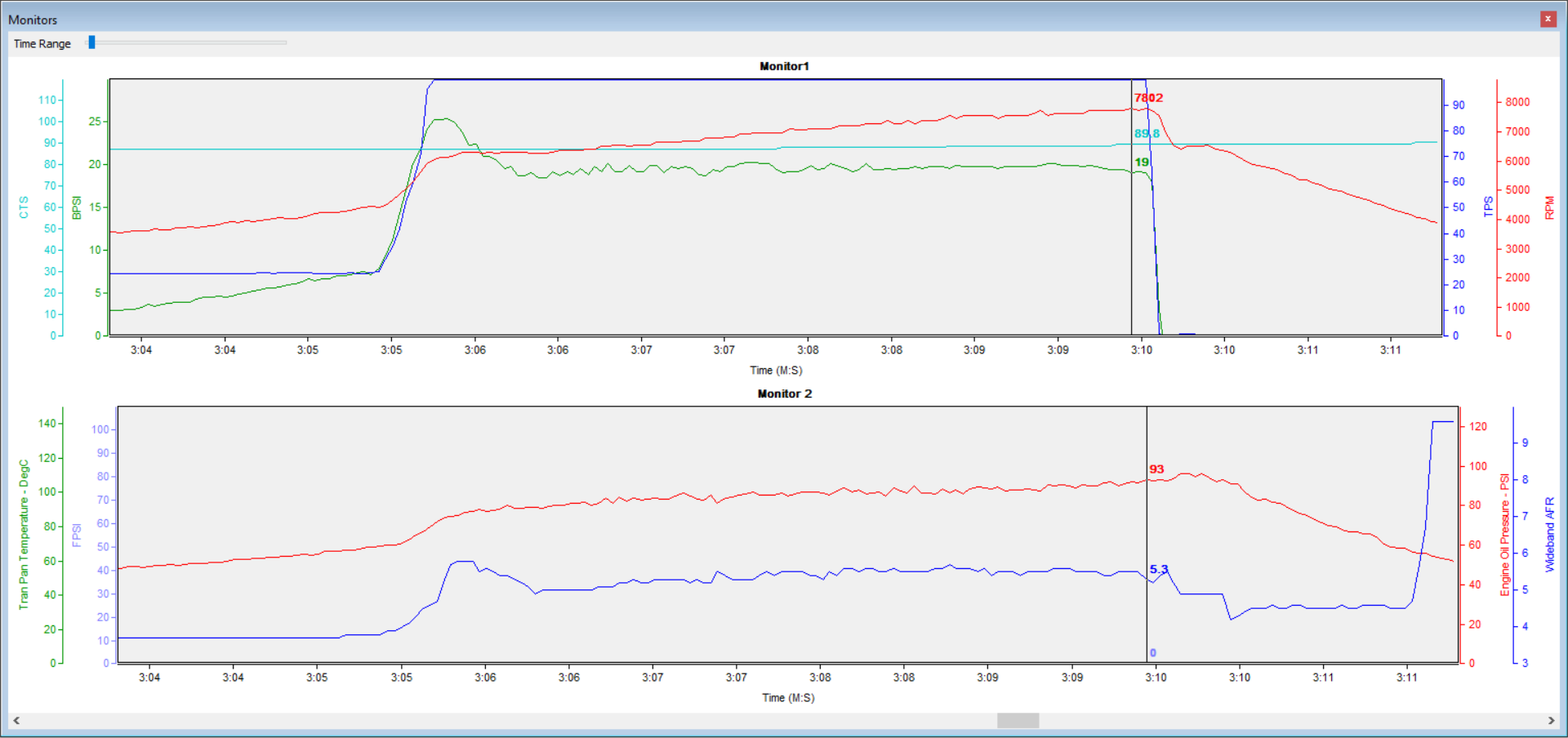

so i was fairly confident that i had just removed a massive restriction so it was time to go back to the dyno - results speak for themself!
so on top of having good oil pressure, i also fixed a failed second fuel pump and was able to get a new PB of 445HP and a full power run in ....... well almost!
