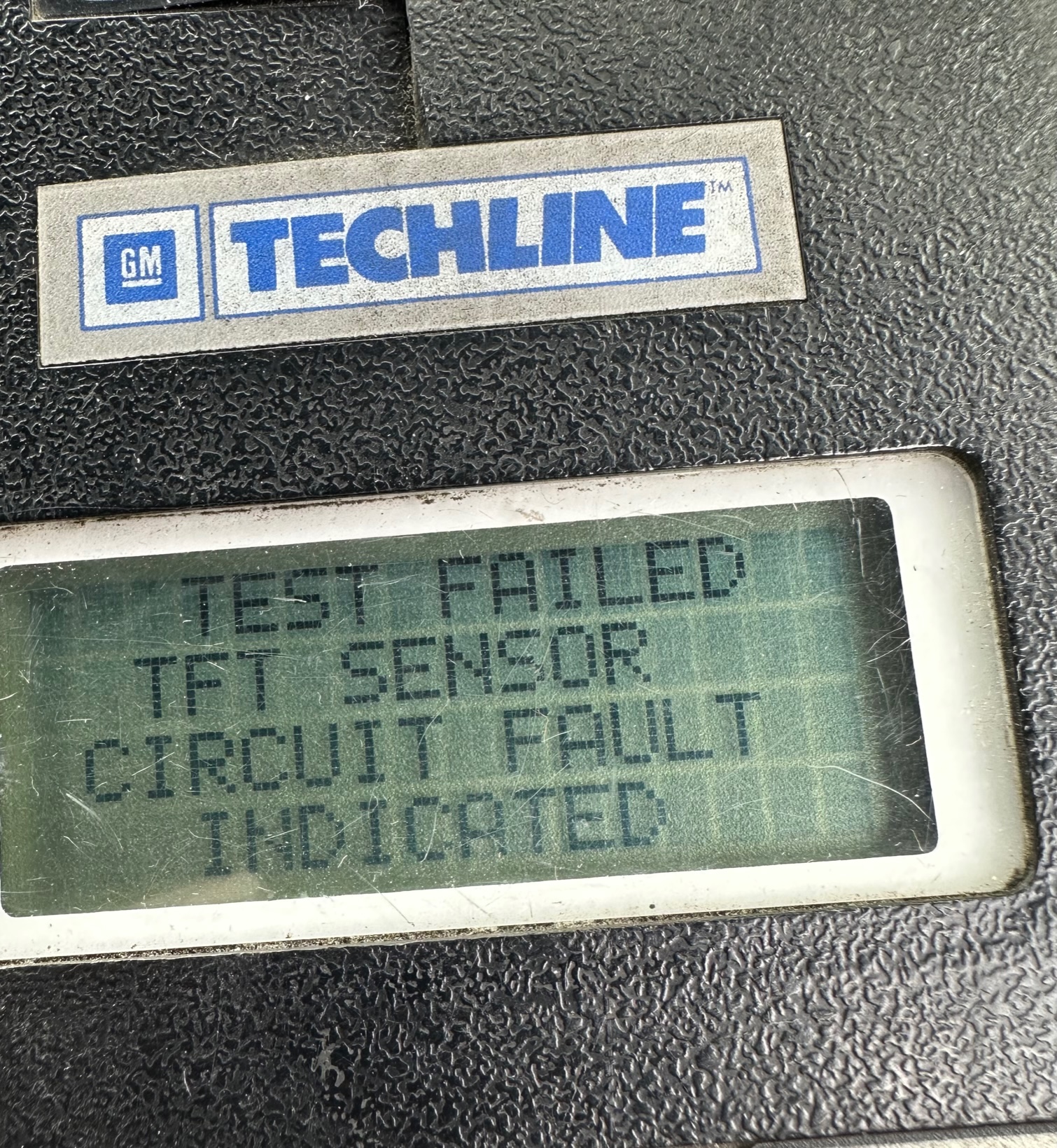

When I Enter 'Engine Function Tests', and perform a Wiring Harness Test, it comes up with 'TEST FAILED ECT SENSOR CIRCUIT FAULT INDICATED'.

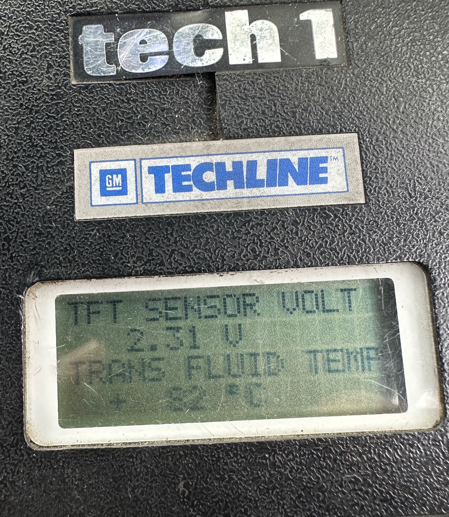

Today I realised the same can be done in the Transmission Function Tests, but it also comes up with 'TEST FAILED TFT SENSOR CIRCUIT FAULT INDICATED'.

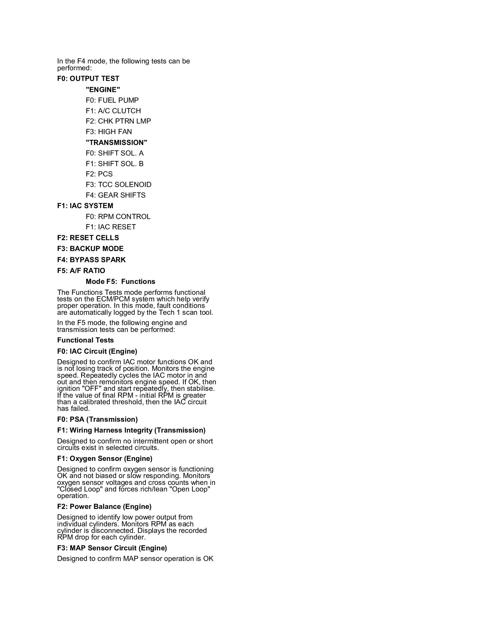

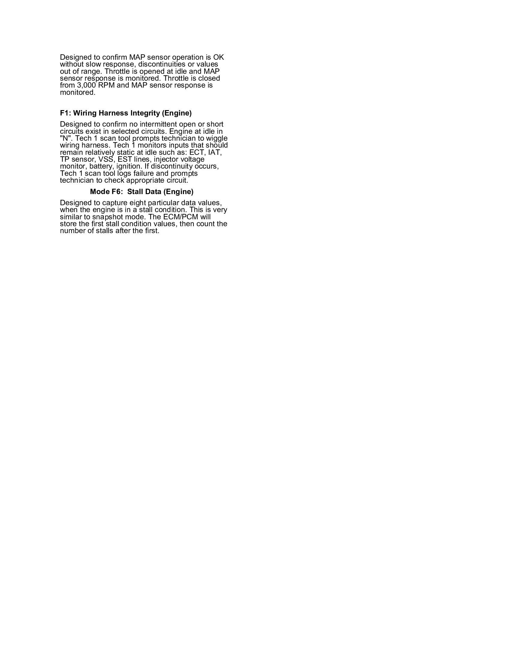

Found something, not much but might help.
