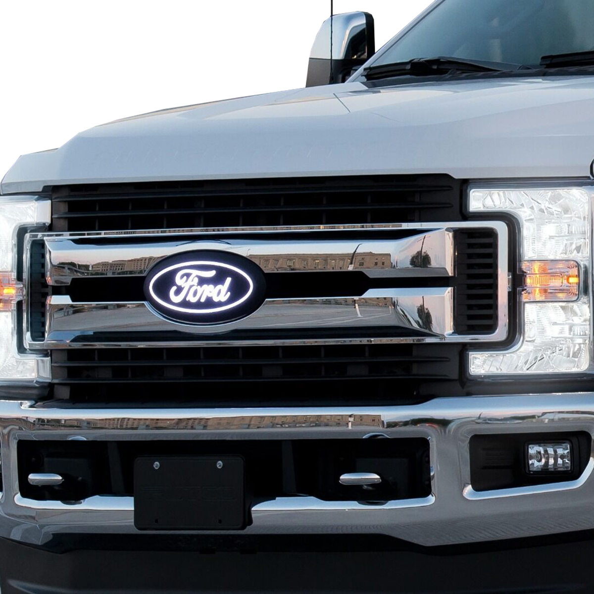

At least Ford always circles the problem :lol: :lol: :lol: :lol: :lol:
