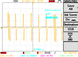

I just captured a waveform from my Cavalier which seems to have the same 6+1 type of system.
My system is coil driven. It is not a Hall effect sensor.
I know the thread is old, but here it is for reference.
In trying to find out what the reluctor looks like I found some pictures. Seems to be just a wheel with notches in it.
