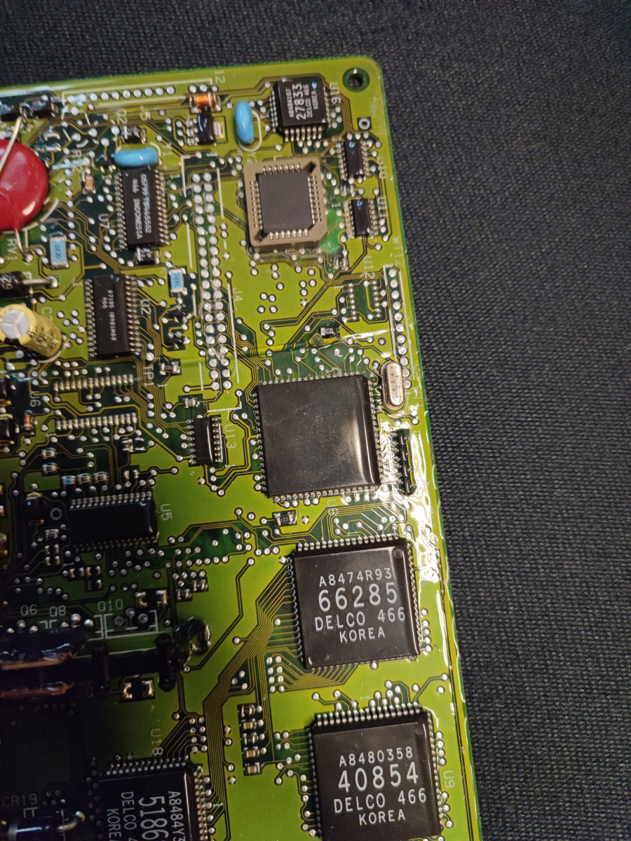

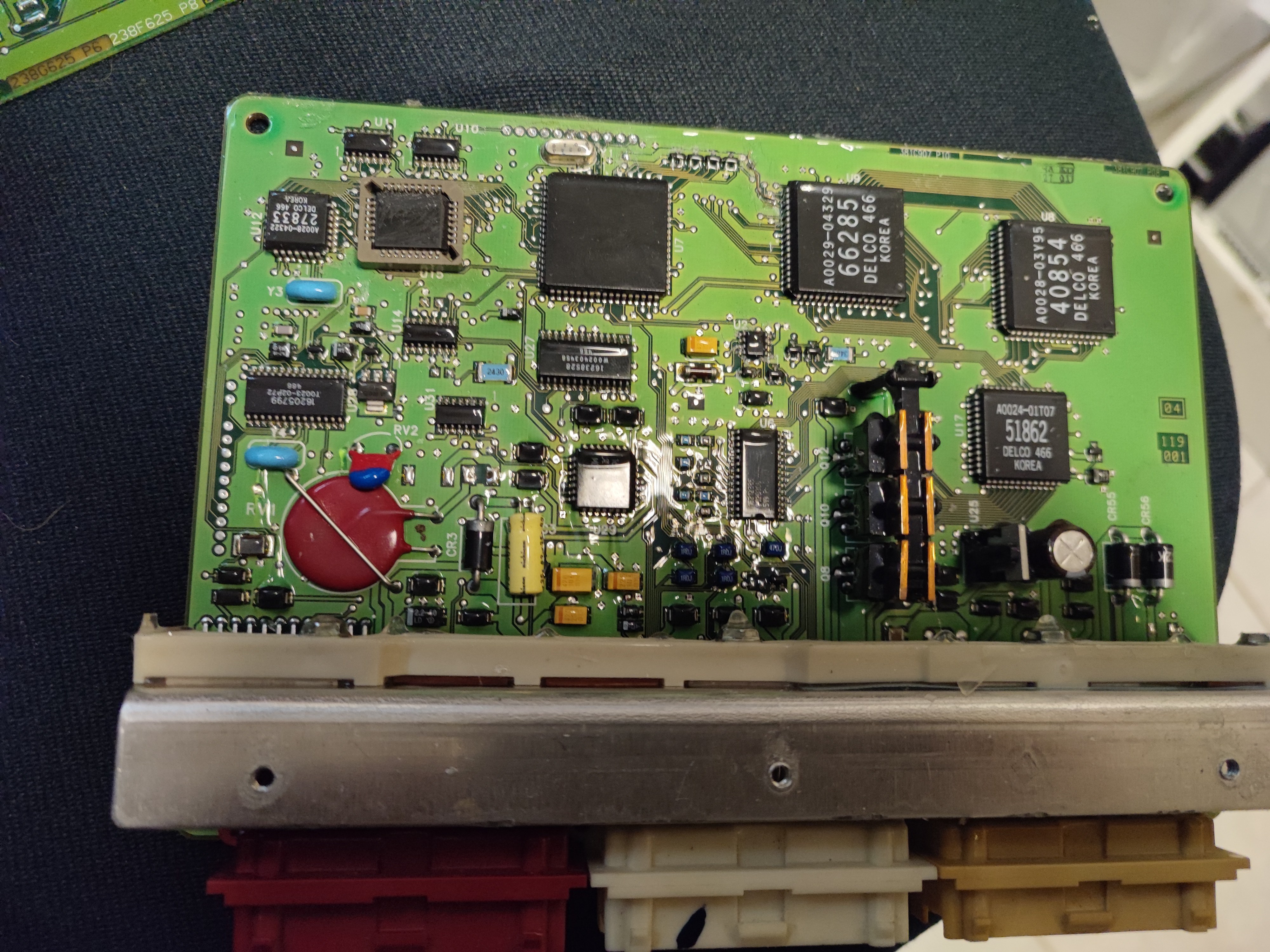

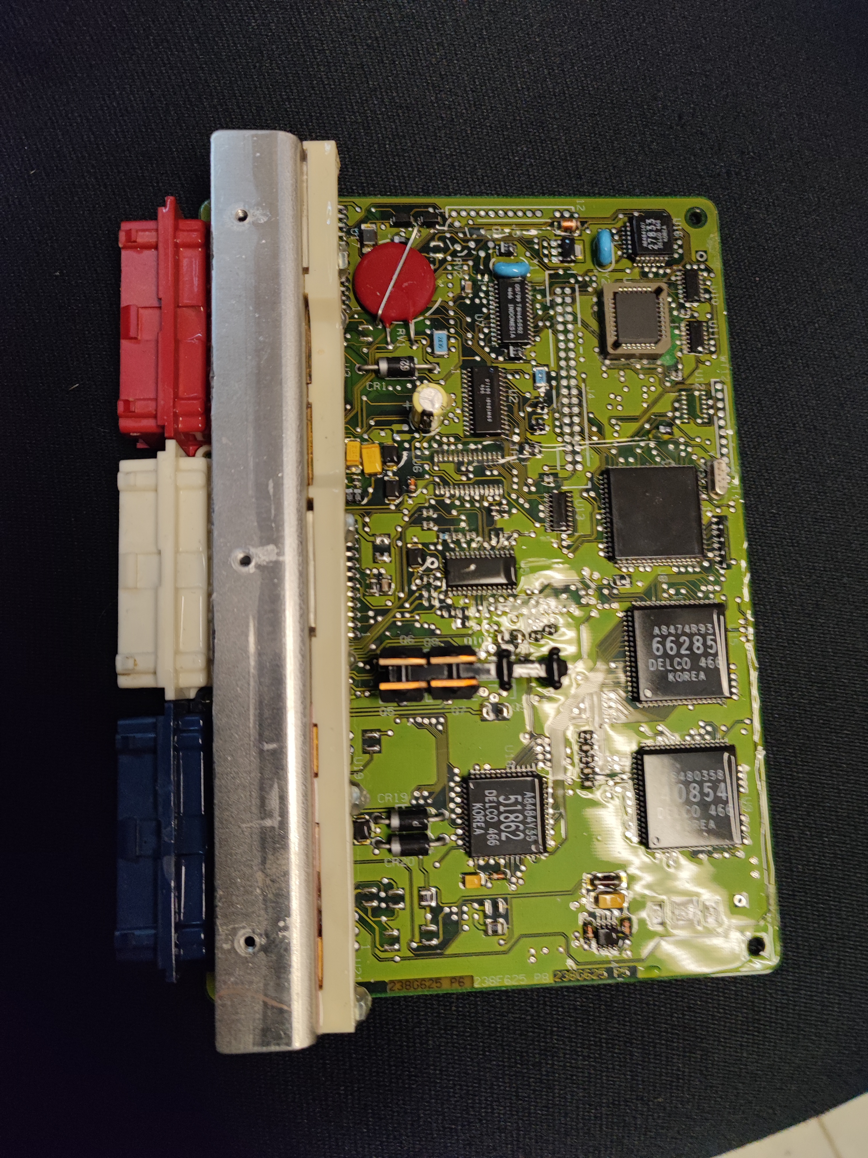

Here picture from the ecu

If 3008 to AA doesnt help, also try FA44 to 3006, so from 3006-3008 it'll be FA 44 AA.
That PCM looks incredibly similar to the PCM in the 2000 Holden (Isuzu) Jackaroo with 3.5L 6VE1 engine, which someone else posted a picture of the pcb here: viewtopic.php?p=90604#p90604
Very similar layout, most of the same ICs, but some of the extra spots populated.
Blue not brown connector on the outside, and does not have the socked eeprom (did you do that or is that factory?) or what looks like a header on the PCB next to the eepom to connect to the address and data lines for development purposes.

with blue is x22se, with yellow is in germany y22se util 2001 and in usa x22se util 2001. the socket is from me.
i have also v6 6vd1-w 3.2 with blue and 6ve1 3.5 a lot of version, and delphi 29f200 util 2001 with v6.
