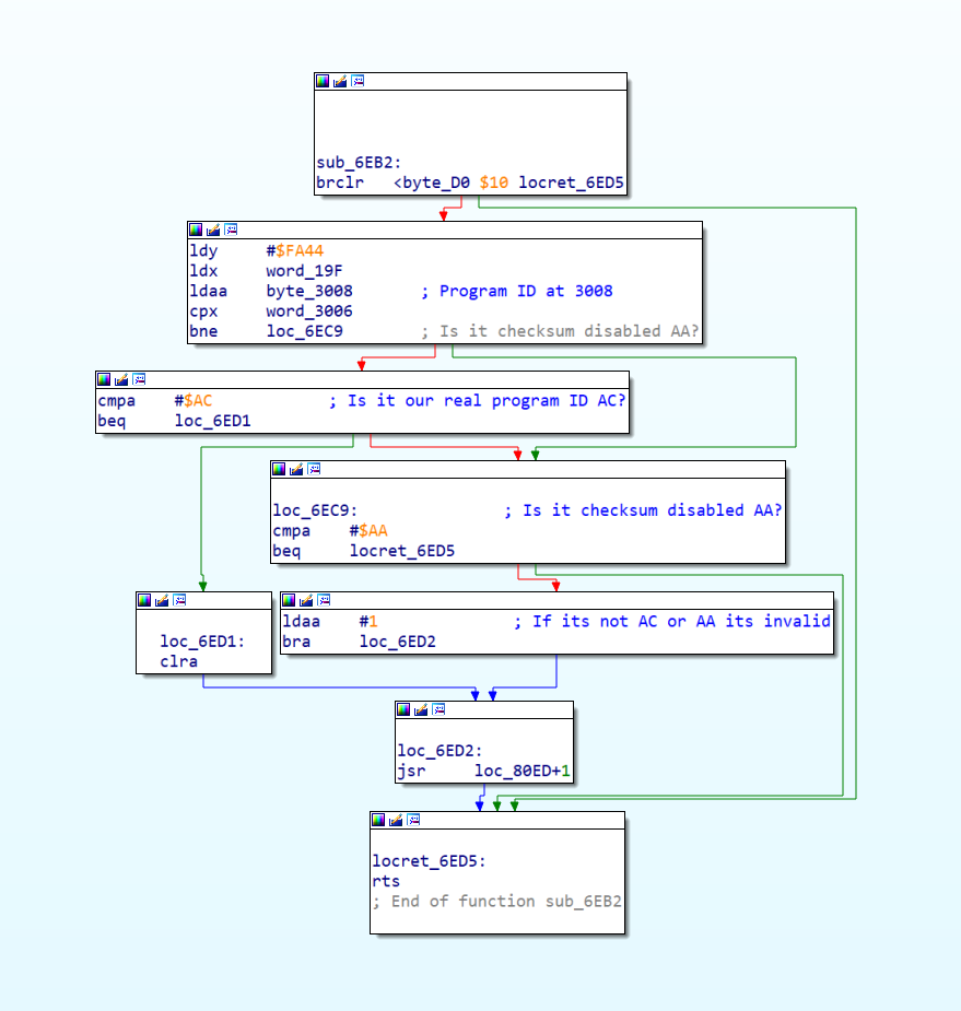

I think its program ID (AC) at 3008 and you can set it to AA to disable checksum. I'll see if I can figure how its calculated. The reference to 3006 matches the other thread, but it must start and stop somewhere else, or skip some part of the range.
- program id for checksum disabled.png (92.44 KiB) Viewed 5552 times

Ive been looking at it for a while, it seems the function that does the sum is very different from the GM PCMs of the era, as well as the other one in the thread above. There is something special about addresses 3021, 3022, 302B, but there is more code around that and its not just that its skipping these addresses. I am going to stop for now, probably your best and simplest solution is just AA to 3008.
FA44 at 3006 with AA at 3008 also seems to be different to just AA in 3008 - it enters the checksum function with register A clear instead of 1, so try that as well if 3008 only still emits a CEL.

At 3006 is the checksum, at 19F is the calculated checksum,
AA= 2 different bins stacked are used
AC= 1 bin 2 banks used.
I think method is different or bank 10000-1ffff is used at some point.
80ed+1 might be part of bank1

3008 is your Program ID. Its always at address 8 from the start of the segment. Sometimes 2008, 4008, 6008, in your case 3008.. and AA always means checksum disabled in that generation. If you look at the IDs of Australian bins from that generation here https://pcmhacking.net/memcals.html you'll see the 1 byte program IDs, and each segment also shows the address which it is at - always x008.
