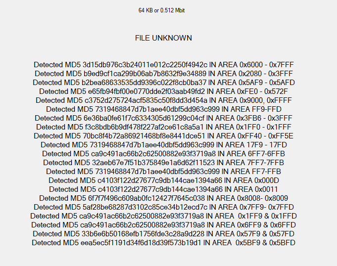

I have a delco ECU believed to be from a VR commodore. I have downloaded the BIN but when I use the VR XDF in TunerPro the tables are all messed up..
Is there a way of seeing what XDF i should be using from the BIN i have downloaded? The ECU is a 424 BFFK but I get tables like this...
Thanks

Did you use the memcal ID tool, it identifies as $11A file so need to use that xdf.

I just ran the tool, Pretty handy one to have actually and didn't know it existed...
Unfortunately, it comes up as unknown however this was from a running car!

maybe attach the file & then it can be identified if it is actually a BFFK file

Here is the BIN.

So did you read it off the memcal yourself it's a bit weird the data doesn't start till address 5000

I did mate.
Read it with XGpro.

Is this any better? I think i may have had the wrong chip earlier.
It still wont ID in the tool though

if it's factory stock memcal it shoulg be FM27C512 from memory

Still no joy...
This has me stumped. It wont ID, I cant get it to read any sense on tunerpro either.
