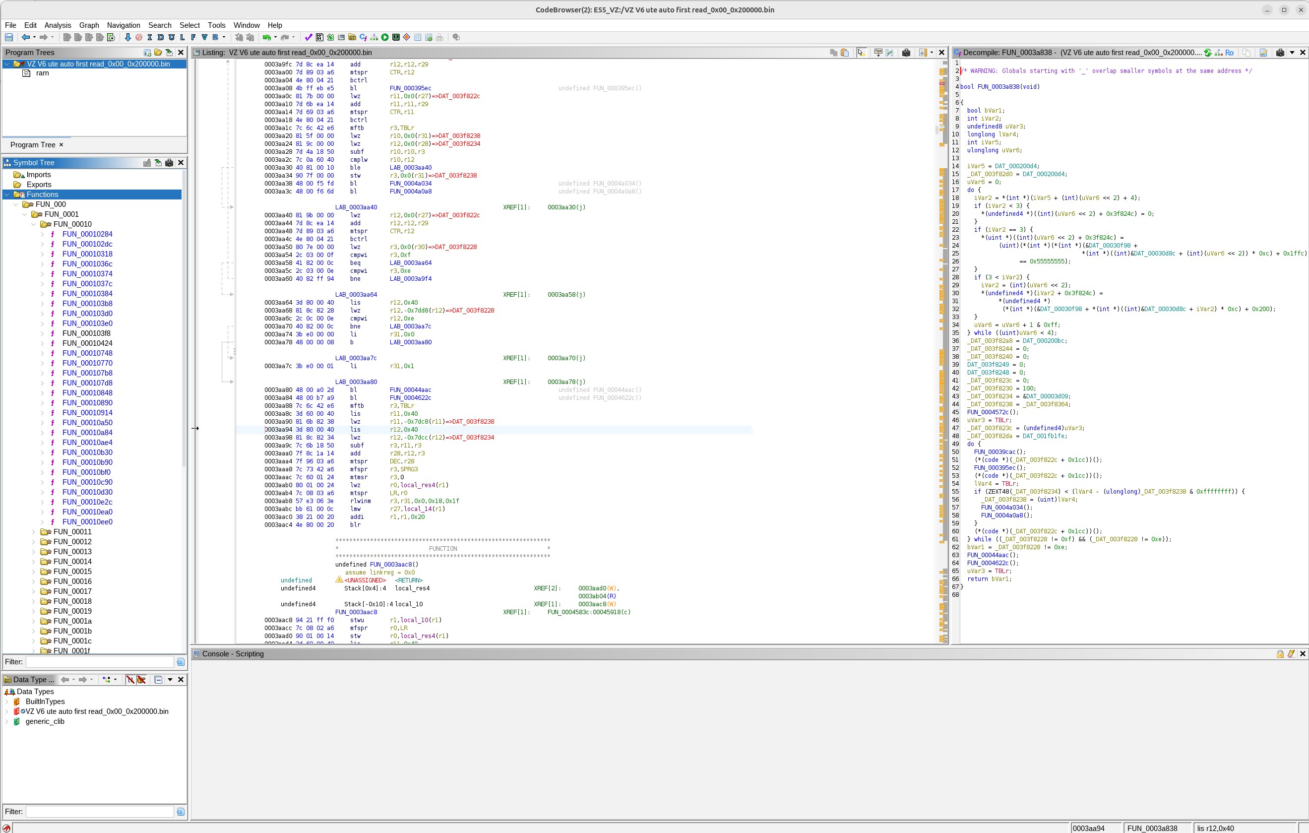

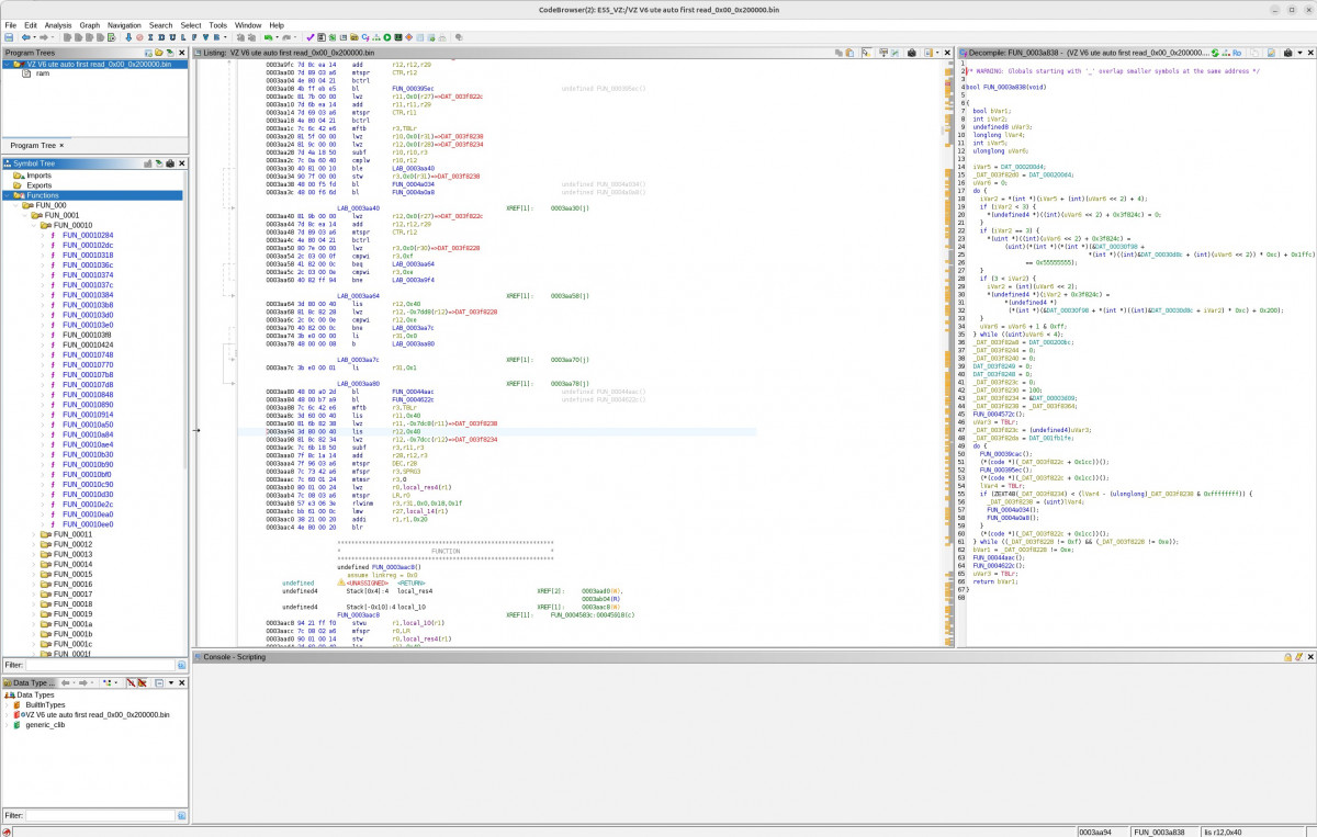

Posts: 10111
Re: VZ Immo Off
@keysersoze How did you go about disassembling the bin? Just load a bin in to Ghidra and pick MPC555 and let it run? Anything special to set up?
Posts: 10111
Re: VZ Immo Off
update: Looks like its easy to run ghidra on ubuntu 24 LTS. Just apt install python3 openjdk-21-jre openjdk-21-jdk then from an unzipped version of ghidra run it with ./ghidraRun
Once its open create a project, import the bin file from the PCM and use processor type powerpc big endian 64 VLE/Alitivac 64/32 bit. That may be overkill for the processor type (im pretty sure it doesnt use the PPC VLE function and perhaps not 64 bit) but it seems to be covering everything and appears to have found all the functions.... much more than the out of the box ida experience when getting started with what to me is a new architecture.

antus wrote: Thu May 22, 2025 11:37 pm update: Looks like its easy to run ghidra on ubuntu 24 LTS. Just apt install python3 openjdk-21-jre openjdk-21-jdk then from an unzipped version of ghidra run it with ./ghidraRun
Ghidra is great!
Allows also implementing scripts to auto perform various tasks to speed up a process.
