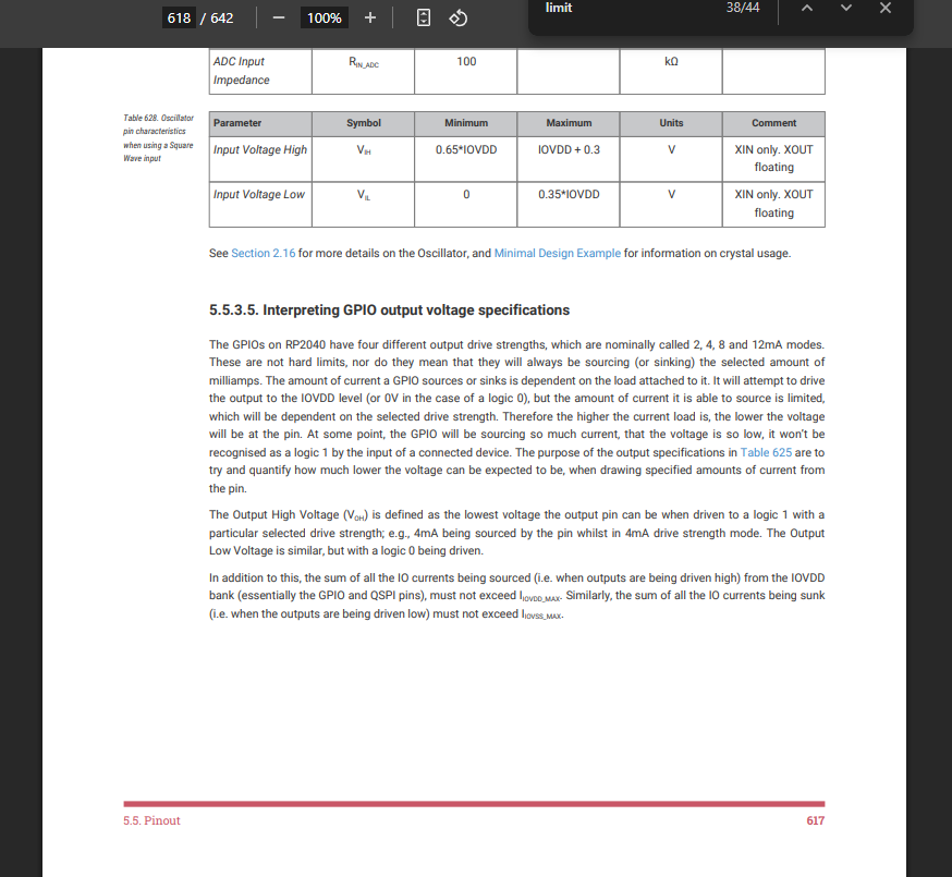

Looks like plenty of head room.
Don't stress specific units.

Seems via 68377 spec (E40 MPU) that max current per pin is 1mA. Total 20mA all pins. 33uA sink measured for each of crk & cam inputs resonates with this. All pins max 5V. (Some are 3.3V).
It's a sensitive little number cruncher. Not much margin in an electrically noisy engine bay. Maybe why the MPC56x series superceded so effectively with a 10+ year reign.
