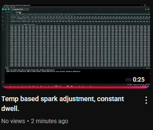

https://www.youtube.com/watch?v=5w6Tkdwkde0

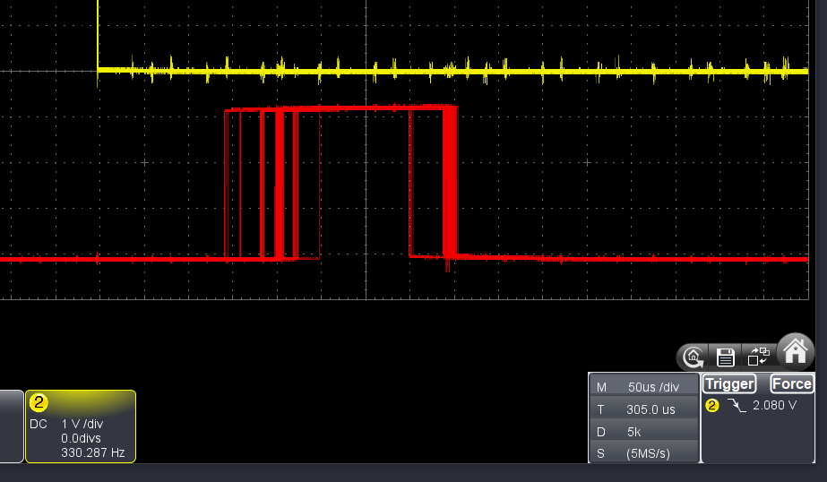

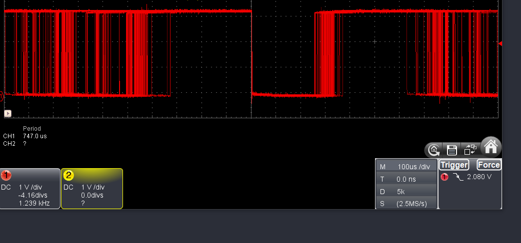

Alright, it's... functioning. Seeing weird artifacting nonsense on oscilloscope though, so don't be too excited right now.
I might manage to get rid of an Array, maybe 2. The big ones.
Going to think it over and use a new save file, because it's going to get in the weds a little.
But as of now, just changing IAT scales injector without changing EOIT. MAP sensor though, without the arrays scaled to each other properly... not so much. Might be able to do math against RPMtime to solve that and save a lot of RAM.

Don't stress specific units.
AngelMarc
Posts: 262
Re: Coding my own aftermarket ECU
Post by AngelMarc »
Seems obvious now that I should set offdelay for spark to a static number. I'm not trying to vary dwell... duh.
    currentOnDelay11 = Scaled;
    currentOffDelay11 = 4000000;
That's one 65x129 table gone.
AngelMarc
Posts: 262
Post by AngelMarc »
Well shit. That didn't take long. I'm seeing some horrifying noise still, but the basic functionality is there.
Instead of trying to coordinate 2 arrays
uint Predicted360Time = RPMTimeavg * 24;
and
int ScaledOffset = Predicted360Time - Scaled3;
Those 2 lines and the static 4ms dwell replaced 2, 65x129 arrays.
I think arrays will be 129x129 soon lol

So, somehow I don't get to use standard base 10 numbers for the temp scaler arrays.
I mean, it makes enough sense, bit shifting vs base ten. 256 = no change.
Hard to say exactly how bad it's doing at 75,000 RPM
here's 39,000RPM with all the newest changes.
Not as good as before.
Might be a use for the extra tables after all. Though no doubt more niche.
