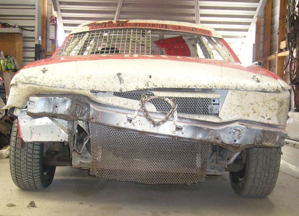

that chassis rail looks a bit bent ?? :?

Pictures can be decieving my freind, it's a lot bent :sad2: all ahead of the K-member though. I reckon a big dose of RSB method in the next few days should get it near enough :roll:

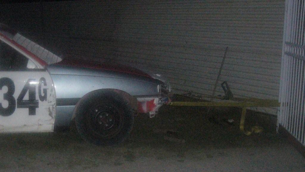

After work yesterday i hooked the car up to the old gatepost to give it a bit of a pull - did diddley squat so i sent the man a txt, within half an hour help was here ( and the guys had a 15min drive ) we rigged it up a bit better and acheived stuff all, i mentioned i had another front behind the shed but the decision was made to take it out to the orchard and hook it to the tractor so after cooking the Barbie i put it back in the shed and dropped the exhaust off. turned out theres a couple of nice dents in the right pipe from the motor moving forward a bit on the mounts (factory ones) and smaacking the pinion housing on the rack, the left side flange was broken off completly at the swage line where it seals to the manifold, now i only have about two inches of original pipe and the rest if fabricated so i cut the end out, attached another end to the manifold flange, hung the exhaust system back up in place and welded up the pipe - job done - i still need to get it off again to get around a couple of spots round the top but its quiet again. Took it out to the orchard after work tonight and stropped to a big tree pulled the rail with the tractor then beat the bumper iron back inti shape ---ish. right front guard came off for beating which came up really well and went back on, bashed out another couple of bits and peices and chucked it back on the trailer in time for a drink and game of darts. Its home again for a few welds and new headlight covers. I am very lucky to have the help i get when i need it, awesome guys - no fucking around, have a laugh doing the job and quality work done fast
