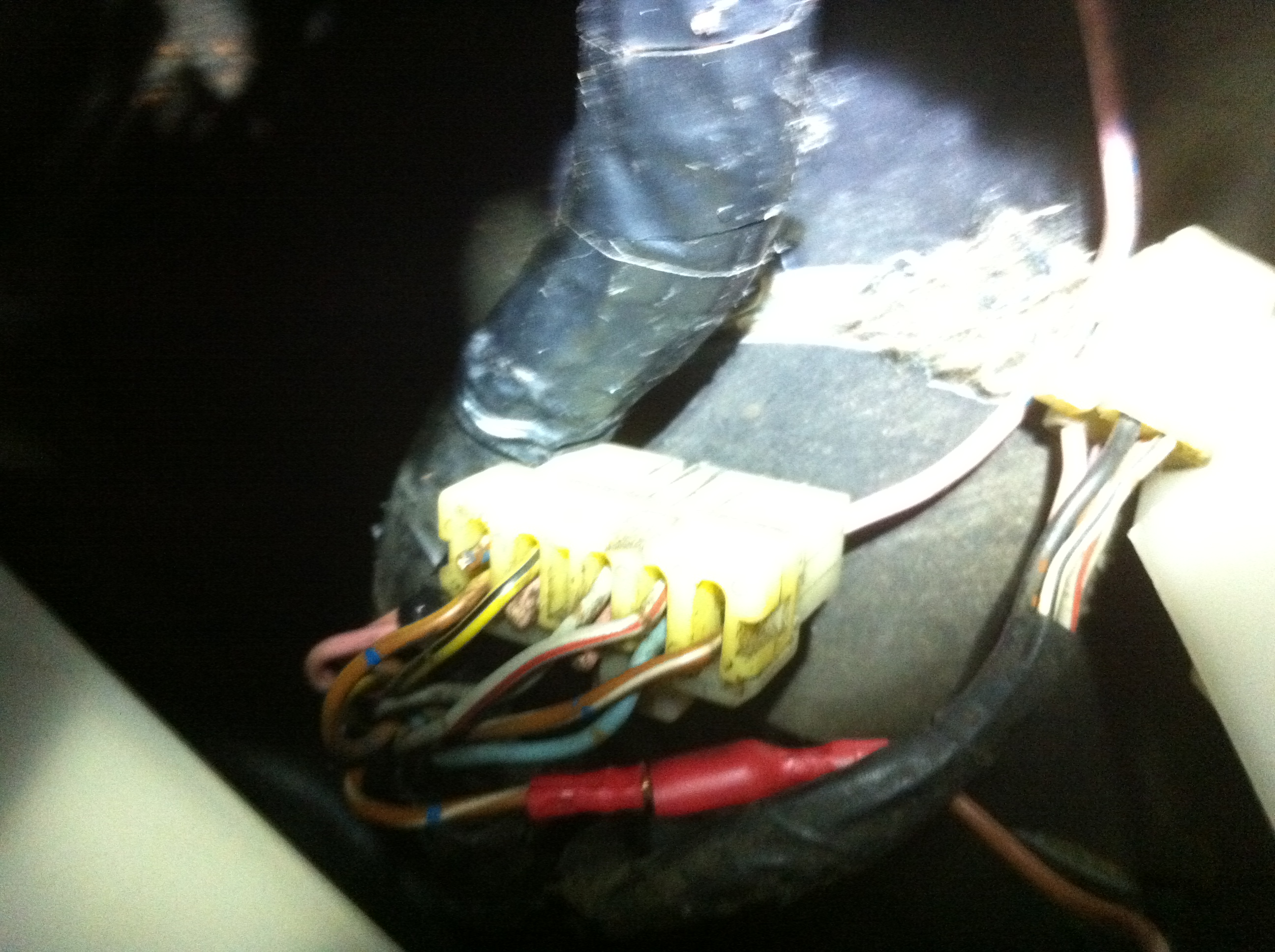

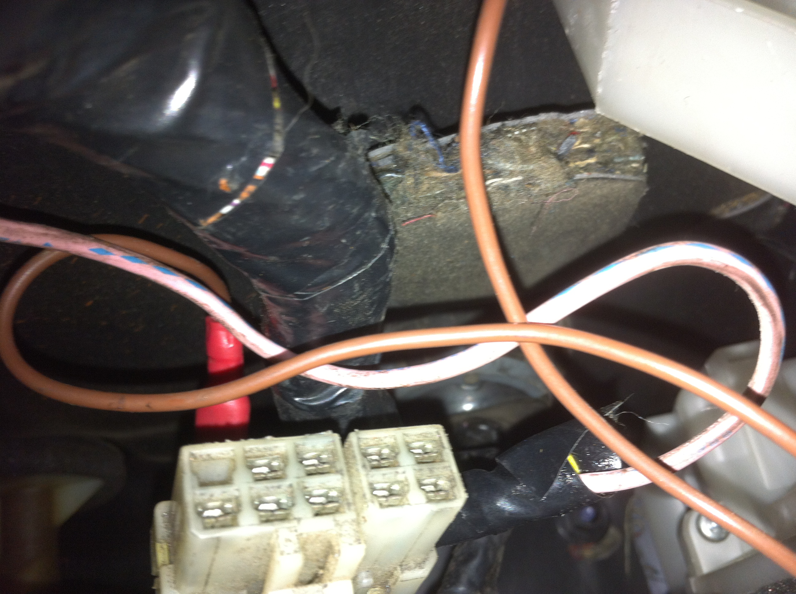

Here are some photo's attached of the front and back of the connector .. Sorry they are bad but its hard to take the photo's its tucked up behind the
glove box!!

You sure that's the diag connector? Mine's a black plug with tabs on the sides...

Maybe it's not but it's the only thing in can find and it's
coming of the ecu loom

The N13 harness (which I believe is identical to the LD astra) has the diag port at the ECU connectors, so see if there's a black plug hanging off the back of the ECU.

That's the only connector and it comes from the main loom

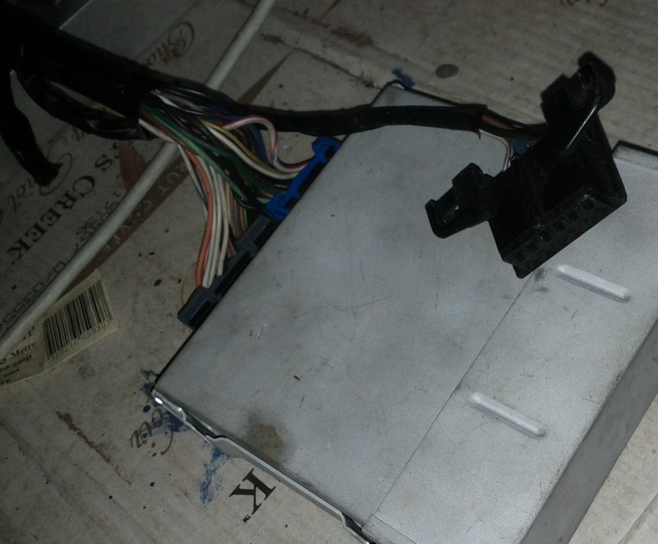

I have an N13 pulsar loom in my shed, so I just took a pic. This is the connector and it comes out the loom about 20cm back from the ecu.
Sounds like you might need to refer to the astra wiring diagram festy posted and wire it in if the pins are not populated.

Yeah mine doesn't have that connector . Only the one I have in the photo.
But it's in the same position on the loom as yours.
