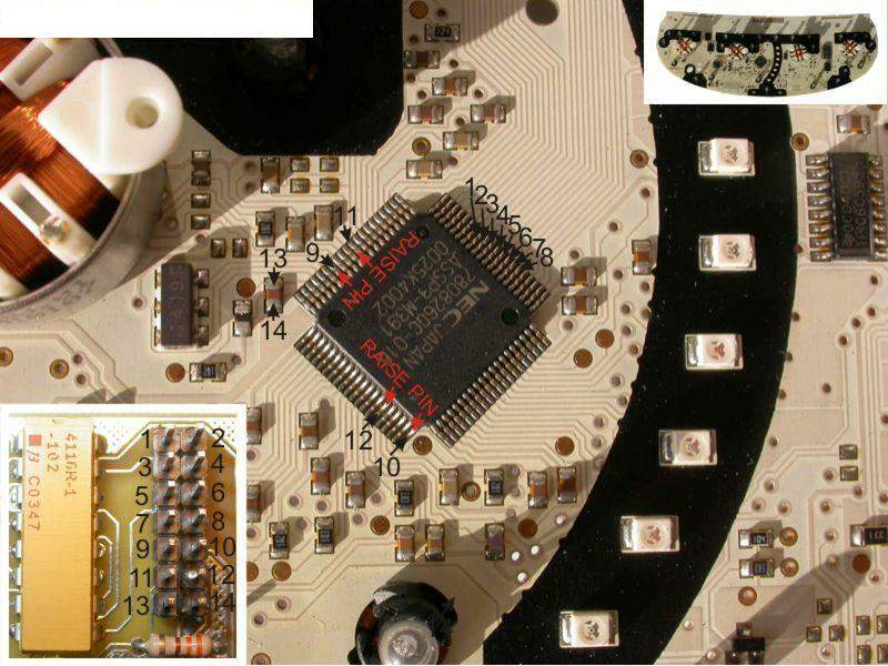

Hi, I'd be interested to find out how we read the vx clusters that use the NEC mcu instead of the eeprom that EVERY other Commodore uses!

mate what you need is the NEC DASHBOARD PROGRAMMER on ebay for about $64, what you can do is download the software and install it
from there run it> choose vehicle> from the drop down list choose> Chevy Malibu the click display info, what you'll see is Holden's VX cluster board !!! it seems holden used these from GM probably from being over produced, then went back to using separate EEPROM's again

It looks like you still have to do some small soldering (from the docs):

you do but you can skip pin 1 to 8 they are for the display editor only pins 9 to 14
i've worked out where to solder the other 6 wires without having to solder to the MCU i don't think pins have to to lifted and soldered on to

That's what I thought you used. Id be able to map some of the addresses by using my scantool to make changes and looking at what's changed in the bin.
Do they do a USB version of the NEC programmer?

in the meantime, my MODE switch arrived and if you want to hook it up do the following. On the switch connect pin 8 to ground and pin 5 to pin 13 on the cluster and it will operate as it would in car and also getting into engineering mode
looking at the socket the pins in an anti clockwise
1 8
2 7
3 6
4 5

for anyone thinking of having a go here's a pic of an alternate soldering points marked in red boxes
attachment=0]mcu alt connection copy.jpg[/attachment]
