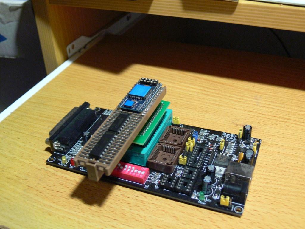

Re: .bin ID
I use the Willem programmer, see attached images.
I believe that the memcal is supposed to be for a stroker VN group A.
- software2.JPG (64.29 KiB) Viewed 4197 times
- P1020796.JPG (116.6 KiB) Viewed 4197 times
- P1020795.JPG (155.04 KiB) Viewed 4197 times
Re: .bin ID
prob wont get a good read because of the protection, id say you'd have to desolder the eeprom and read it direct.
