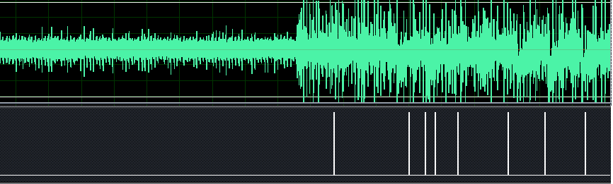

Re: Programmable digital knock filter?
I found this board sitting in a box yesterday, so thought I'd see about getting it working properly.
A few hours debugging it and I think it's pretty close now.

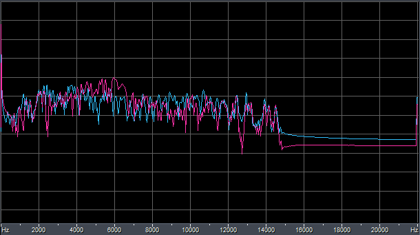

Here's a frequency analysis of the input signal (the knock sensor recording) showing the knock between 5kHz and 6kHz. Here's the knock audio (top) and the filter's output (bottom): This test didn't have the filter gain or timings optimised, so better results could be achieved with some tuning.
Although the audio waveform looks much louder during the knocks, playing it through a speaker the only difference I can hear is the "ping ping" noises over the top of the background...

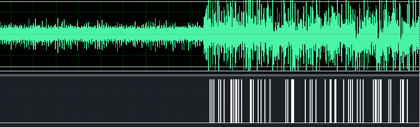

And here's another one, with the knock frequency set to 3.7Khz (i.e. way off the knock center frequency) - it picked up a bit of knock but not too much.
That pic convinced me that the filter is taking the settings I'm passing it:
And here's a few different filter frequencies/gains/integration timings being tried - I haven't got the traces all lined up in sync (ms paint is hopeless) but you get the idea...
I increased the analogue output detection threshold which gives the filter more freedom, and it becomes less touchy about center frequencies etc.
It only took a couple of settings adjustments to get a decent detection of a new audio sample:
Trying the different settings is done from the GUI, so it only takes a few seconds to try each setting out:
Update:I increased the analogue output detection threshold which gives the filter more freedom, and it becomes less touchy about center frequencies etc.
