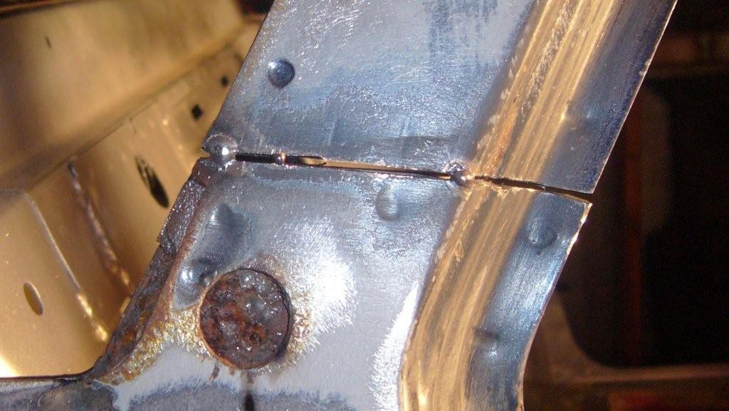

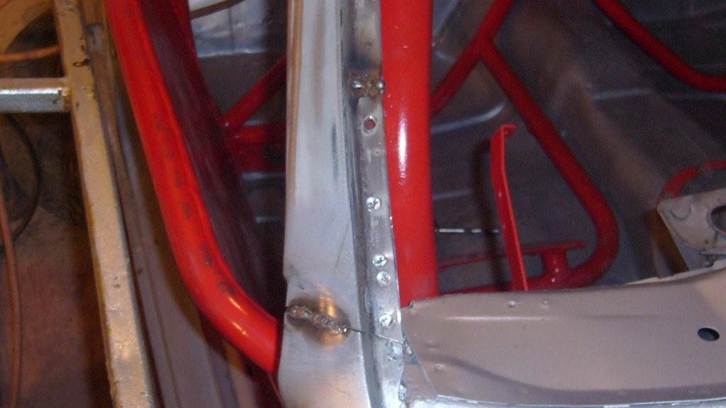

Once the cage was wedged into the right spot, holes drilled and bolted in i had to massage the bracing around the perimeter of the roof to get the cage so sit down far enough everything to line up. I am now pretty certain the old shell was bent/twisted in its previous life as a road car. could be interesting.
Lined up pretty good. three little tacks

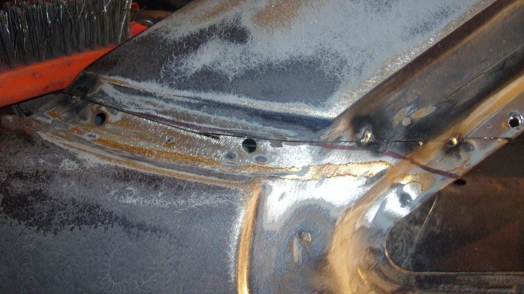

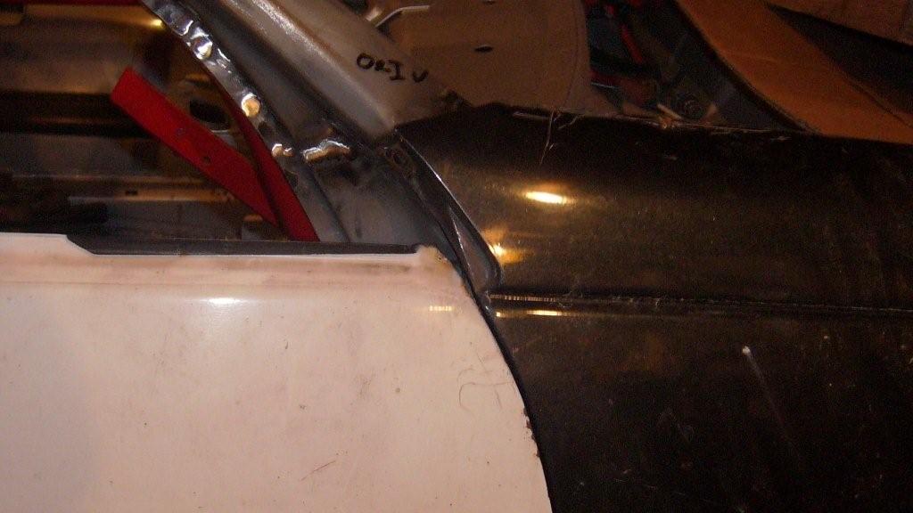

As it fell! i was "holy shit tack it before it moves" you can spot how much i overlapped the pilar cuts and drilled the spot welds between Before i cut the pillars i also propped the shell ata 8 spots around , all up it may have been overkill but it hasn't twisted at all going by how it went back together so pretty happy. Its all welded back up, welds dressed and that bloody bracing cut back off - it did its job but was a right pain in the arse clambering in and out and around working on the car. I've had another big cleanup in the car and shed and have made some progress with getting the wiring loom back in, its getting a tidy up while apart - was a bit of a tangled mess from when i built it after too may late nights building the car originally working with the wiring diagram outta a haynes manual - wrong-with the season started - but it worked.

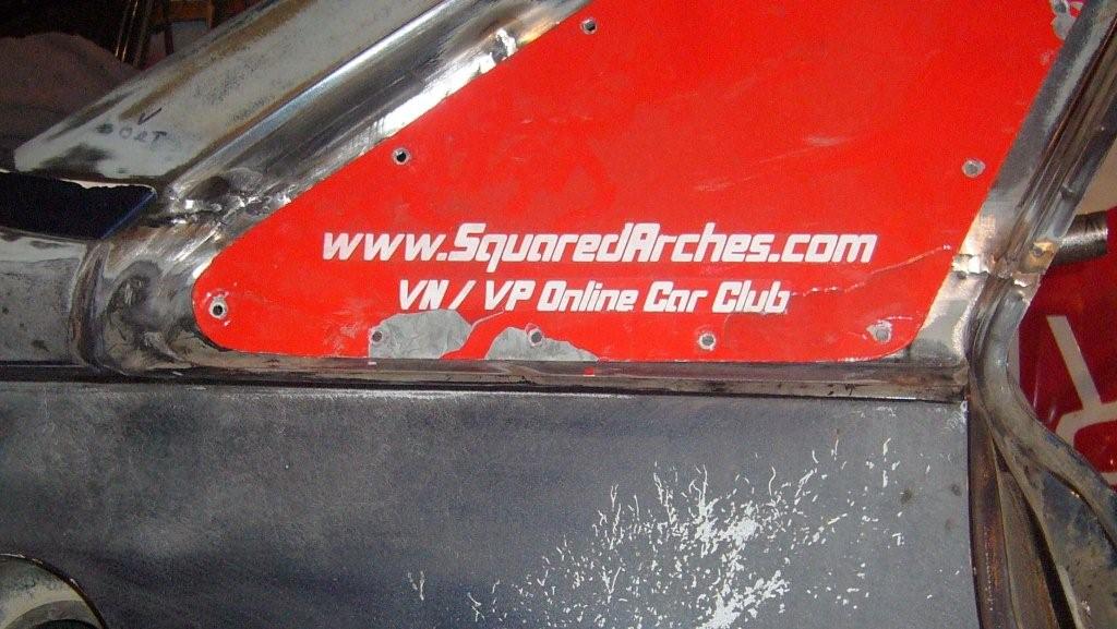

Most of my ugly welding on the outside hidden by factory bits.

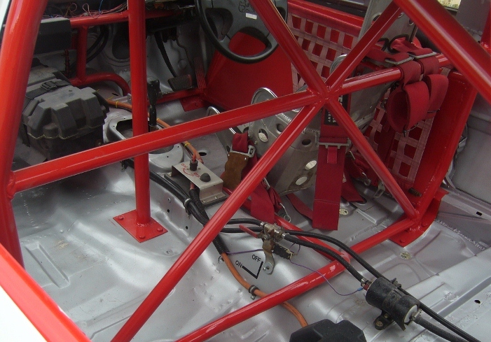

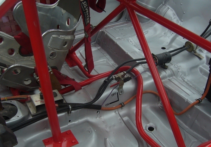

- I HATE WIRING - eliminated a bunch of wires, come across a few faults that have plagued me due to severe abuse over four seasons of racing and made a few changes like relocating where the starter cable comes through the firewall making the cable heaps shorter and a lot less likely to get melted on the exhaust - again. Having the right wiring diagrams to work off this time is a huge help. I found out the hard way the one in the Haynes manual is a generic piece of shit that had me tearing my hair out for ages ( only thing i bought the bloody book for too ).
When the cage was out i cut the seat mounts off and slightly relocated them and i'm wrapped with the new position although it will take a little bit of getting used to as i changed the angle a bit (arse towards centre) which shoulld take some side impact off my back/neck IF i hit the wall. I'm now absolutely convinced the old shell was bent and twisted before i got hold of it so the handling should be interesting - it'll either be fast out of the box ( yeah right ) or i'll spend most of the season chasing my tail trying to sort it out. Going to fit the FE2 front bar that came with the new shell which should help the mid corner on the gas push for the wall but i might just start with last years setup first and go from there, got a mini spool on its way too, by the end of last season the LSD was fried and slowing me down considerably.

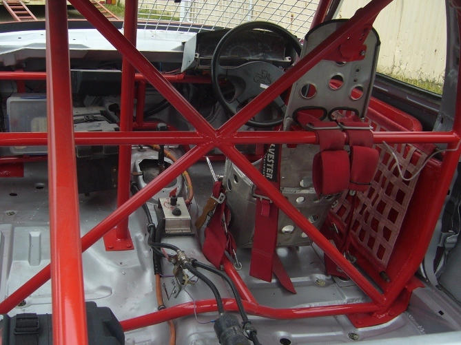

Interior race ready.

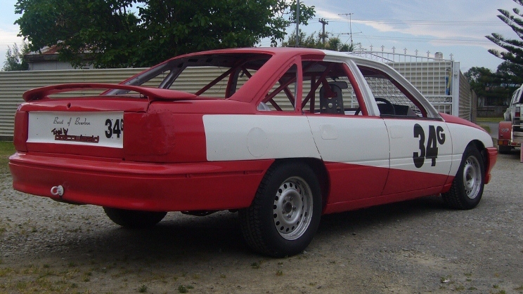

Exterior retro~retro scheme featuring chaser rims - definitely fattened my tyres a bit.
As it was about to go on the trailer for the season opening meeting The bootlid is the only panel to carry over into 34G's fifth season, even recycled the number and a certain sticker, tightarse ay!
