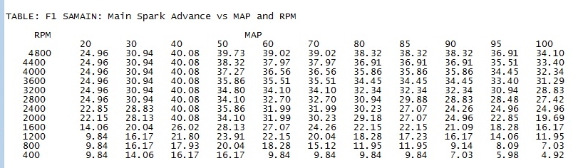

Just looking through some older $5D bin files and notice in the F1 SAMAIN: Main Spark Advance vs MAP and RPM it only goes upto 4800 rpm. What happens when the revs are above this point?
Here's an example:
Cheers

If its like the newer models it will just flatline at that spark setting till it reaches rpm max setting in the calibration!

Thanks for the info. So if using 12p we fill in timing across the board and don't use extension slope?
Re: $5D spark map
yeah thats correct, if you are transferring a tune from 5D say into 12P use the extension slop number as a guide ... eg. 2 degrees per 1000rpm, should be pretty straight forward to work out the increase on the 12P table and apply the same from 20-100kpa.

Thanks. I guess this must've been a limitation of the factory based tunes.
Re: $5D spark map
well it also means 1 number can be used to create values for alot of cells and hense save space, i dare say its more a matter of smaller bin file limitations.
Posts: 9018
Re: $5D spark map
