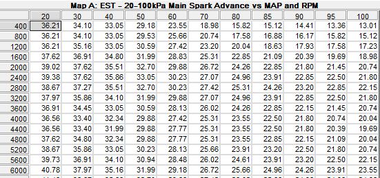

in the absence of access to a real dyno and getting a bit tired of guessing spark maps with the old butt dyno which isny very accurate anyway, been thinking of getting some knock ears to aid in my road tuning. has anybody ever bought any and can recommend a particular set to buy?

im trying to tune an ecotec at the moment... 4.2L, balanced, 8:1 ish compression, ported heads, ported reverse manifold, cam 226@ 0.50 and 114lsa. running on 12P n/a while its being run in, then it gets its 15psi turbo up its bum. getting a bit wary of it at the moment trying to figure out how much timing it wants. so far this is my guesswork spark map. it seems to like it, no sign of knock but im trying to figure out if it wants more... without a dyno, I just want to be careful and use knock ears.

can't help much with map conversion, 15psi is safe with 8deg during WOT when i do stock s/c assuming it has some sort of cooling then tune up from there. Though yours is stroked.
Re: anyone ever bought any knock ears?
Jayme i reckon you could go more timing lower in the revs i guess it depends on the converter too, if its not going to be below 2000rpm then don't worry :)

T5 :P we will see if it blows at 15psi. it is a doooog below 3500 rpm at the moment it feels like it could use more timing. cruising at 100k's 2000 rpm 90 kpa :shock:
