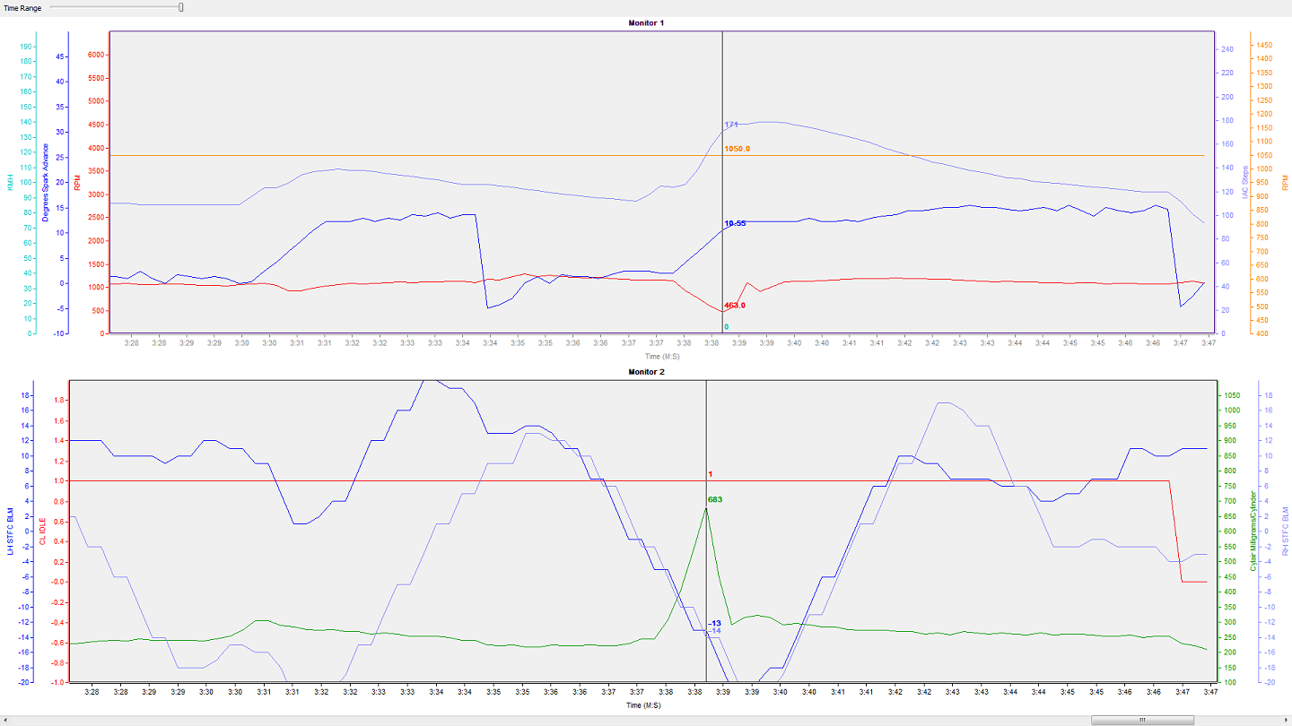

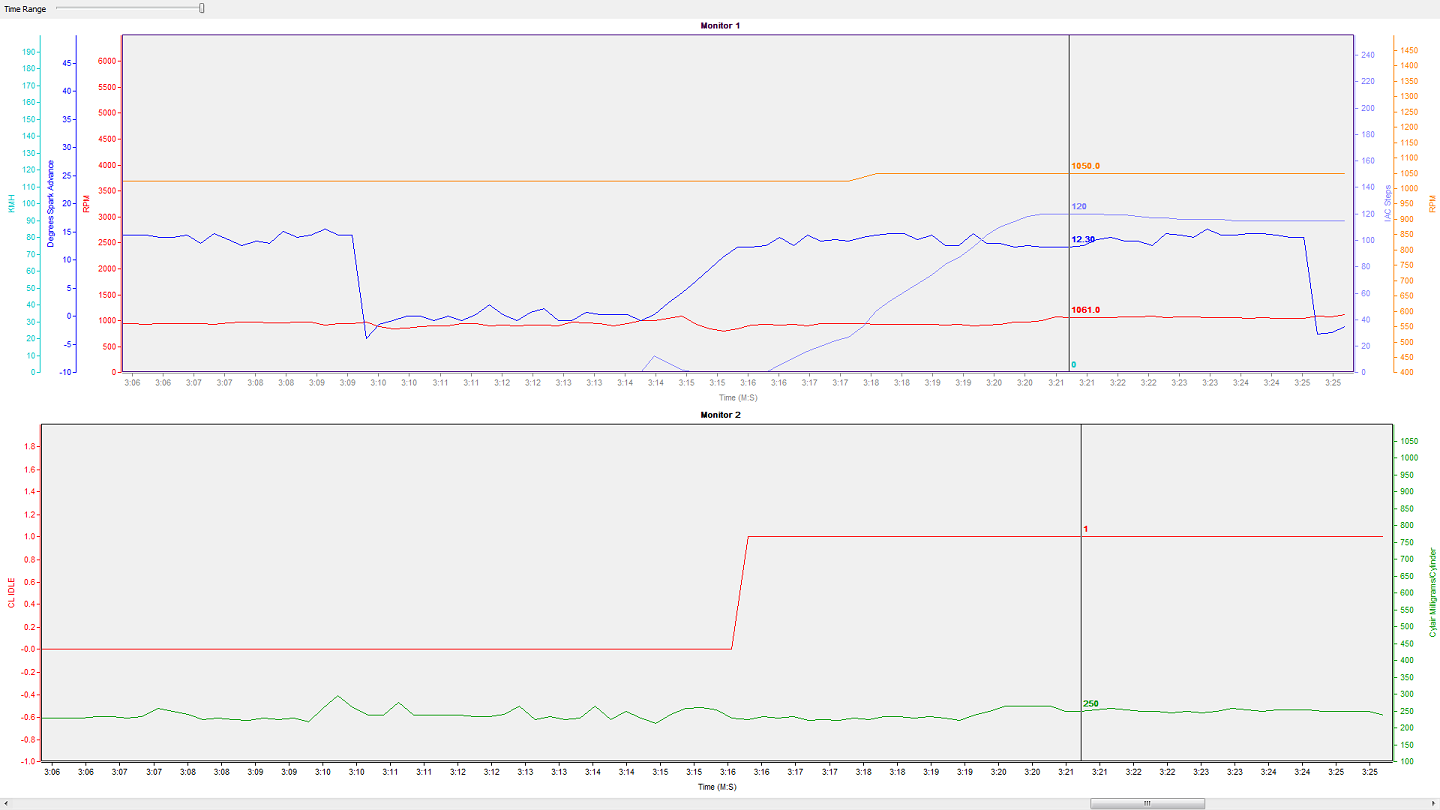

The right hand O2 seems to behave very differently to the left. It rarely gets any cross counts, and the INT works really hard to try and lean it off. Swap the O2s around and see if the laziness follows? The VS has an earth problem for the sensor heaters that can cause weird things too.
The target idle RPMs are prob not helping closed loop idle speed control. The proportional spark (if thats what it is still called) looks to be working overtime to try and bring up the RPM, the IAC steps go really high. Look at 3min10 of the closed loop still inactive xdl. I setup a new byte item that shows when closed loop idle is active so it can be displayed on the monitor screen, c/l idle speed starts at 3min16. To get to the target of 1050RPM it commands 120 steps, prior to that it had 0 steps and 900odd RPM in open loop speed control. 3min39 is another example, closed loop fuel pulls out heaps, idle speed drops, IAC and spark ramps up way too high, closed loop fuel then tries to fix its error and after a few more seconds idle speed control drops out.
Go back to basics as delcowizzid suggested. Get one part working, then move on to the next. You will be chasing your tail with closed loop fuel enabled trying to get the idle working.
