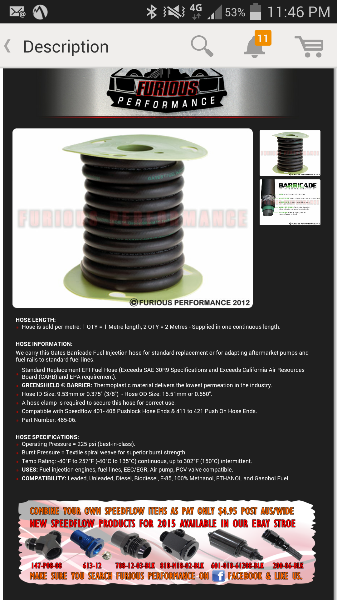

Found this hose on ebay while searching around.
Lists it for just about it all fuels and says its suitable for the 400 series pushlock hose fittings but still needs a clamp.

0081 wrote:Found this hose on ebay while searching around.
SpeedFlow are selling that also under their product lines.
edit: oh forget that I see they are a SpeedFlow reseller lol.
