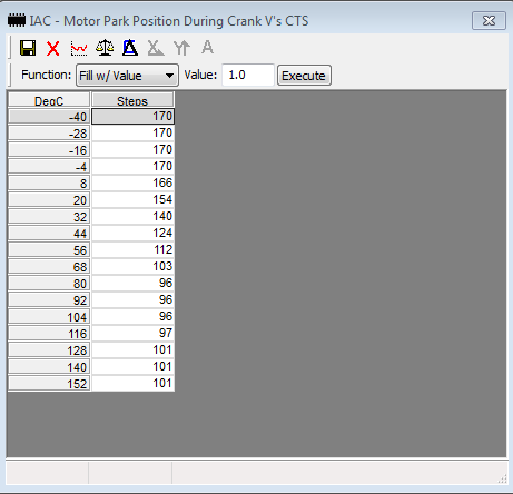

Thats a good idea. Upon doing that though, i found no differences between the two tunes. The only thing i can see at the moment which might help is perhaps limiting the max iac steps? Or perhaps reducing the iac steps during crank? just an idea. ive attached the image below. Im thinking that some of these values are quite high.

typical when say fitting a larger throttlebody or intake that restrics flow less, try changing the lower coolant temp part of the table to say 96 steps, ive had to take it down to even 50-60 steps with cams or rocker setups with intake and larger throttlebody's

The1 wrote:typical when say fitting a larger throttlebody or intake that restrics flow less, try changing the lower coolant temp part of the table to say 96 steps, ive had to take it down to even 50-60 steps with cams or rocker setups with intake and larger throttlebody's
Thanks for your reply. Ill have a play around with it tomorrow and see how i go :) :punk:
EDIT::::::
Thanks THE1. That did the trick! pulled it back to around 70 steps. When i start it, revs to around 1100rpm for 3 seconds or so then goes back its normal idling rpm.
