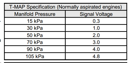

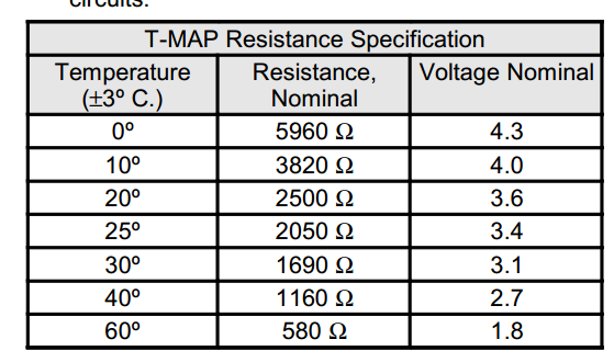

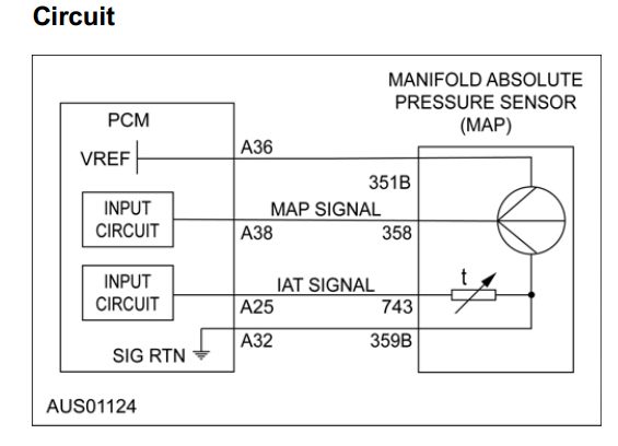

Hello I was wondering if anyone could point me in the right direction to get a tmap sensor working on the ecotec I am struggling to figure out the arguments and equations for tuner pro, I don't care if it does anything with the tune I just want to be able to log it thanks In advance
- Pinnout
- pinnout.PNG (48.04 KiB) Viewed 1464 times
- Map pressure
- map.PNG (33.6 KiB) Viewed 1464 times
- Air temp
- AIRTEMP.PNG (43.83 KiB) Viewed 1464 times

in the past when I wanted to log a map sensor on a ecotec I put it on the injector voltage line monitor .....
you can run The1's enhanced bins now days and use one of the 0-5volt inputs.... then just get ground and reference voltage from another sensor.
