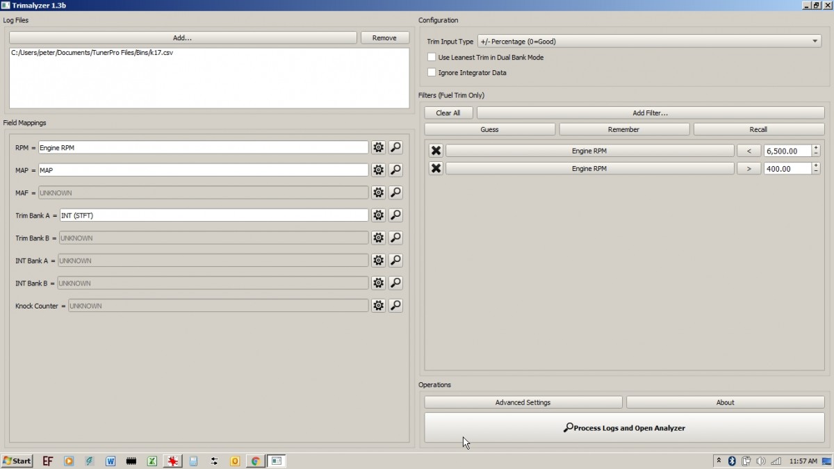

You need to select percentage table if blm tables are percent based if old 128 =0 tables use the other table

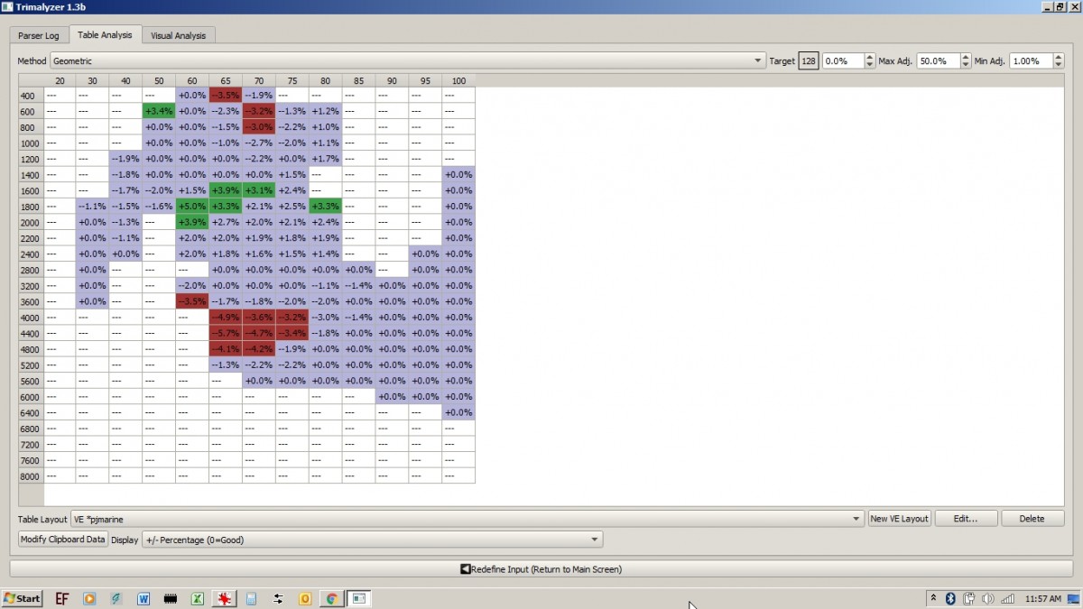

That looks better. Now maintains I am consistently 10% too rich . Still hesitant to adjust that much :o should I trust wide band or narrow band :roll:
Posts: 5626
Re: Trimalyzer narrowband tuning program
10% is fine either side +/- I like to stay on the + side .

been tinkering with this and checking the stft in tuner pro as I din't think I was 10% out finaly got the settings in trimalyzer right and the data it gave out matched the tuner pro stft data.
And the changes to the fuel table were easy to make .
