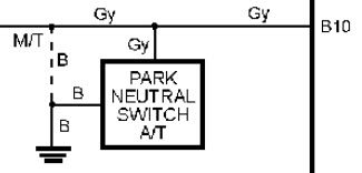

Can someone just confirm with an 808 with $12p. The Park Neutral input at pin B10 should be earthed when in park and left open circuit when in drive. Or have I wired it up backwards?
Also if using a manual trans does it matter if this is left earthed all the time?

Hook it to the feed from the start relay to the neutral switch
Re: 808 PN switch input
when the pin is grounded the engine will crank, so in a manual its always grounded, and in auto its grounded in park and neutral.

In a manual the pin is left open circuit. The ECU code defaults to manual, but if a ground is present (when in park or neutral, so when cranking) it changes to auto.

That's what I thought as everything I make an auto trans patch harness conversion to a T5 one I always end up removing one of the black wires and pin from the connector, copying from a genuine T5 patch.

well that diagram makes no sense then!

It doesn't, like many of the diagrams there is mistakes or discrepancies here and there to the real wiring I have found, especially VN era diagrams.Holden202T wrote:well that diagram makes no sense then!

If I recall correctly I had to change the VN harness (factory manual) when I swapped to $12P, it was the exact reverse. Maybe where the diagram comes from.

No thats in the VN diagram.
